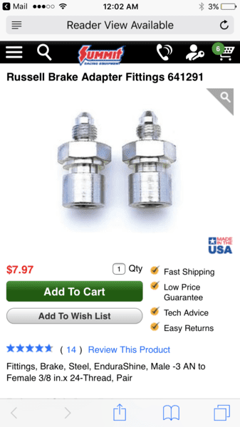

Need some new brake hoses for the runner. I'd say the brake kit is about 12 years old. My buddy installed them when it was his dad's car so I kind of remember the time frame. SSBC Pretty much told me to pound sand unless I could give him a kit number. I'm like it's an old kit, and It was on the car when I got it. Tried to give him the hose length and fitting sizes (didnt expect him to guess) but, he had no interest in helping me. Told me if it was a new kit he could help. I said if it was a new kit I wouldn't need parts. Ill probably have to have some made, they are AN on one end and 3/8-24 on the other. I have a ssbc brake set I put on the dart also, I'm sure I don't have the part number for those either. I'll never buy another set of their brakes again.

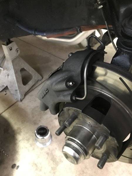

That may, do you know if your calipers look like these?

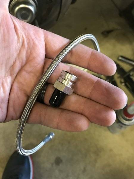

I just went through all this with my SSBC kit. Go to your local Hydraulic Line Supply. The fitting on the caliper side is an OLD Jaguar type fitting. It's long and not very common.
60$ish bucks and 10 mins and I had my new lines ready to go. I dont recall the fitting sizes, sorry.
Yep they are the Iron ones.I can confirm for sure tomorrow.
I'm 99 1/2 % sure.

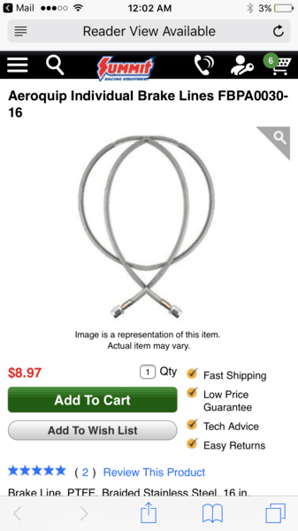

I think a call to summit racing has me fixed up. I wanna run the car Saturday so not looking to screw around

I looked at mine today,yep, they are the same.

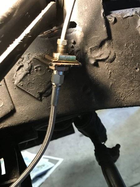

Fittings and hose showed up today. Looks like it'll work good. I'll take it for under $30 repair.
