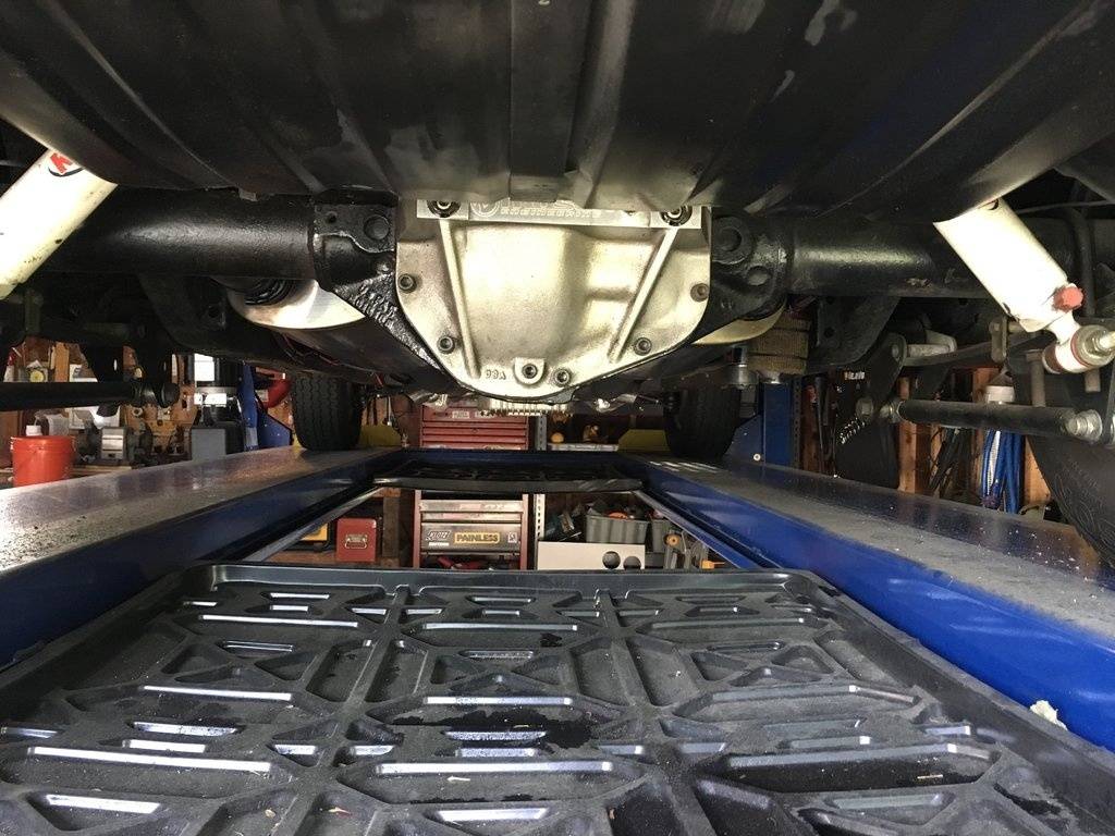

Dana's are tops. Just finished this one with new 410's

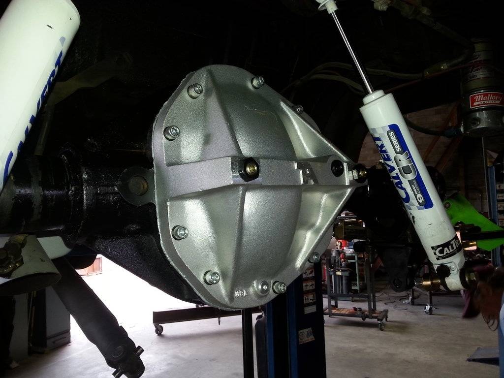

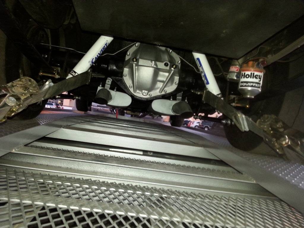

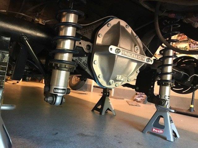

This time , I bought a dana 60 right off the get go. shortened 1" under A body specs, w/ disc brakes, spring pads welded where I wanted them, 3;73 gears, w/ a deroit locker. the locker kicked it to $2100 , shipping hadn`t gone out of site-crazy-rapem prices , like now tho. Has a chrome cover, no room for a beefed cover, between the gas tank.

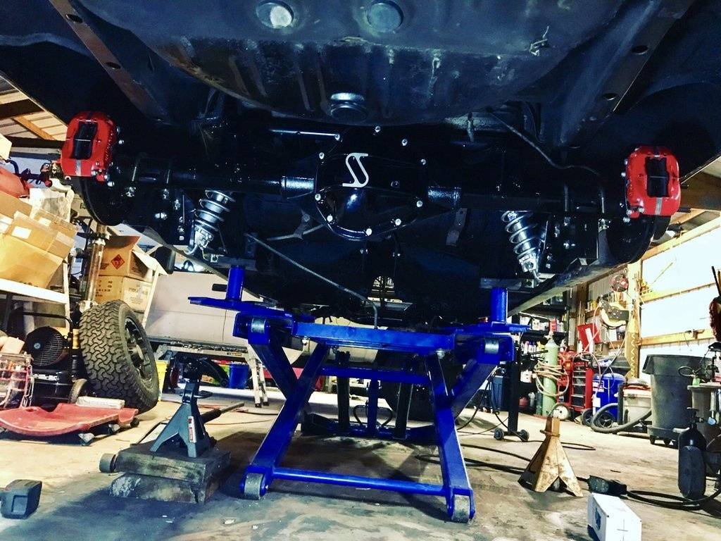

Well I appreciate everyones opinions and experiences. It seems that the Dana is something that will last a while and if I add anything to the motor to go faster it will be able to handle it. I guess my question is ..is the stuff from Dr. Diff good to go? Or the S60 from strange? By looking at their websites it seems you can custom order what you need and have it ready to go when you get it.
I ordered my s60 through dr diff, all orders are custom built to your spec. Yes it's ready to go install your brakes, if you don't have brakes you can order it with new ones, instal your brake t and lines fill with fluid and bolt it up.
With the strange unit it's about a 3 week turn around, I think on the moser website it says they will turn any order in 2 days so if you need it fast maybe look into a moser. Heres a pic of my s60 I just installed
