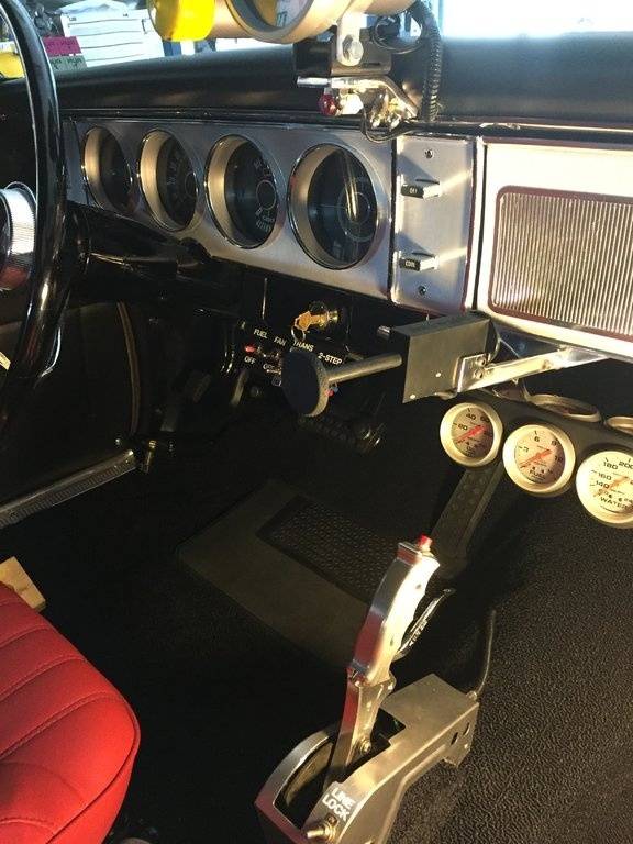

I built this Plymouth so that I could have fun at the track with it and jump in and cruise as well. Now that I've made a few passes I've found that things that work fine for a street driven car sure don't work too well at the track.. The ET Streets have been replaced, the high volume water pump is getting swapped out for a meziere unit along with an adjustable trans brake button. Right now I'm using the line lock button on top of the shifter and I've seen as many red lights as green.

So it turns out that my shift cable was the reason I couldn't get 3rd gear. The cable had touched the header at some point and it ended up becoming stiff to the point that the cable wouldn't slide enough to get 3rd. I removed the cable and it was bloody stiff to slide. A new one is one order and I was able to free the existing one up nicely with lubrication and by working it. With the TTI headers it's pretty hard to not fry a cable. I thought I'd reinstall the existing cable since it's slides good again and try finding a new path.
I ended up going this route. It works good and smooth, full travel and nowhere near any heat source. The Hurst Quarter Stick has a 4' cable and it just makes it. Take a look. The cable goes around the right side now and up.

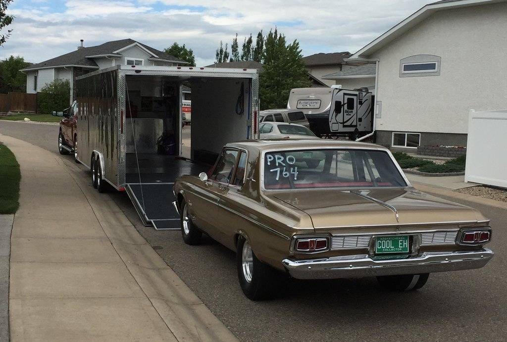

Sure wish I would have put a door on the left side of the trailer. With the sedan that door post is a bugger to squeeze through.. I see I missed removing a sticker on that right tire.

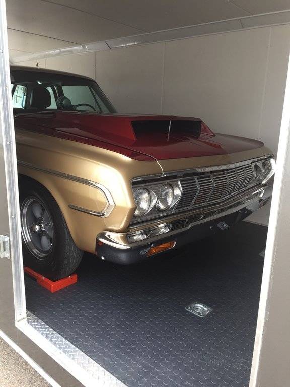

Lots easier loading up myself now with the rail along the right side and tire stop. I can get the car over without worrying about getting too close. That hood and the 2 hinges weigh 80 lbs! That's on the change order list too.

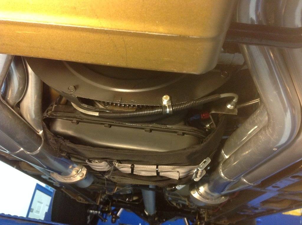

Spent July 9th at the track and it was a scorcher. Got in 3 test passes and one race and concluded that the stock fuel tank with the sump has to go. On launch the pump is getting a gulp of air and messes up the pass. The gauge will flat line after launch and then fart around and never really recover. On my second pass it fell off so bad that I just got out of it and coasted through. The best I could muster up on the weekend was during my one race with a 10.87 @ 123.7 mph., 1.520 60'.
During the day I replaced the in-line filter hoping that may be a problem, even changed out the new aeromotive pump after the 3rd pass with another used pump. I ran the one race with a full tank of fuel just to eliminate pump cavitation.

A fuel cell is on the way and will be in place before the next time out. I'll be researching how to set that up, and would appreciate any input and pics of your set ups.
A few months ago some of the members were suspect of possible problems with the stock tank/sump set up and there concerns were correct.
