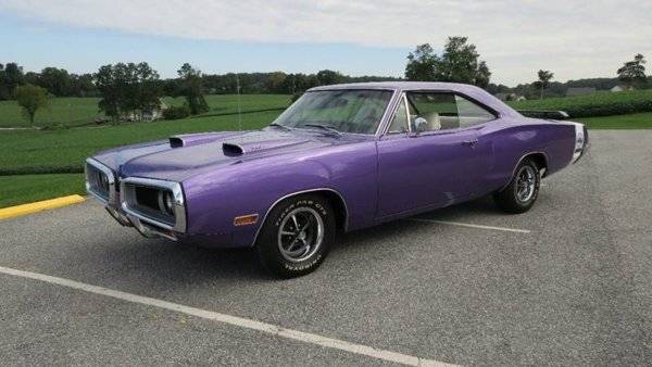

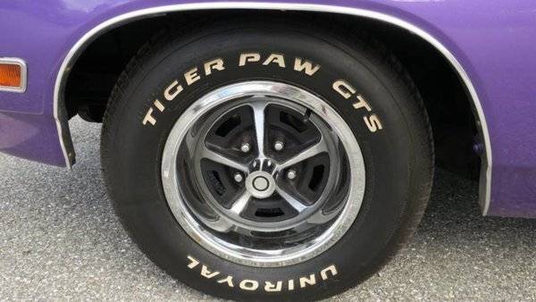

I HAVE A SET OF FACTORY ORIGINAL WHEELS WITH 225/70-14 TIRES PM ME IF INTERESTED
NOT SURE OF THE DIFFERENCE WE HAVE ALWAYS CALLED THESE MAGNUM 500
MY WHEELS ARE THE ONES WITH THE TRIM RING AND THE CENTER CAP
The magnum 500s were chrome & the road wheels had the trim ring. The GTXs were the high end cars & they got all the interior & exterior chrome. They came with the magnum 500s.
