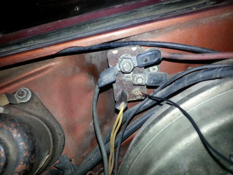

yep the angled one does have a yellow wire on it. I did the other one and still nothing. Heres a picture of the set up. relay ground.jpg
The black wire is the one I rigged in there. Its the non angled one. But it didnt turn over when I turned the key? What does this mean?

So you ran that black wire from the relay to the negative side of the battery, and nothing?

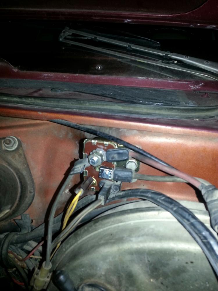

AND while you're at the auto parts store, check and see if they have a starter relay for the car. Take the picture I posted earlier with you so you can match it and get the right one. Napa usually carries them.

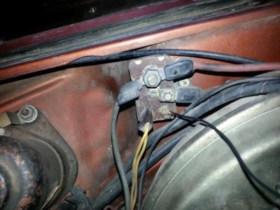

new relay.jpgokay i went and bought a new relay and installed it and still nothing.:confused:
Oh WTF?!?! any chance you got alligator clips while at parts store and can make a better jumper wire? I'm curious about if the relay is being grounded properly.
