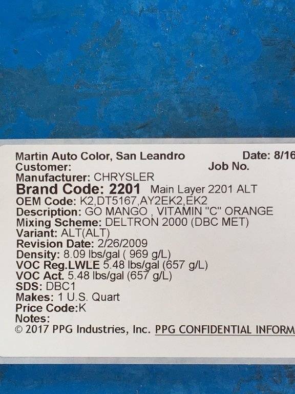

My Challenger is K2, Go Mango, product is PPG. It does have flakes in it, but they blend so well you have to look "into" it to see them.
K2 and V2 are both metallic, but they can mix it without if you want.

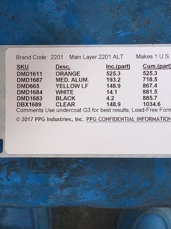

Have it mixed in PPG DBC, basecoat. Your "ground coat" sealer will have to be mixed close to Value of top coat. you can take white sealer and add some House Of Kolor orange Kandy Koncentrate to make your "ground coat". My Buddy at the paint store has original paint chips in Lacquer and Enamel. K2 has aluminum in the formulation, but will be drowning in the other toners, so will not be super noticeable. That color is $800 per gallon in my area. Good base coat is important. You can try Chromabase or Matrix.

When you get to a certain level of quality paint, its [almost] all the same. It's a Coke vs Pepsi debate. The best quality paint is Spies, Standox or Glasurit. I just recommend PPG DBC or Dupont Chroma base because it's good basecoat and easily accessible. DBC reduction is 1:1 , I like to buy 1 gallon unreduced for exterior & 2 quarts unreduced for all jambs.That gives you 3 gallons sprayable color with leftover for touch ups, later on down the line. I dont' like running out! I keep those separated for touch up reasons. For this color K2, I mix up a white sealer to a pale light orange. That helps immensely with coverage & a true K2 color. Always do a spray out panel with clear! No harm in having a HF gun for clear 1.5 mm, I would try to find an old NR95 SATA [rebuilt] 1.3mm or 1.4mm .Sometimes you can find them on ebay or CL or if you have a spraygun repair shop in your area.If you can't find one a Devilbiss Finishline 1:4 will work.the time when a good gun shines is when you spray colors with pearl or metallics. I hope this helps.
