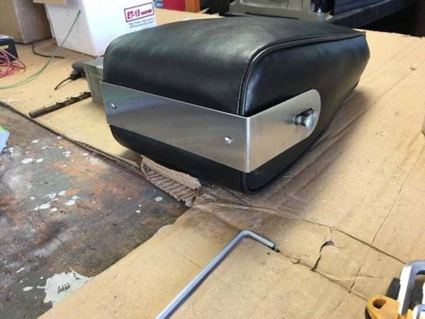

The plastic trim was rotted so I made one out of stainless steel.

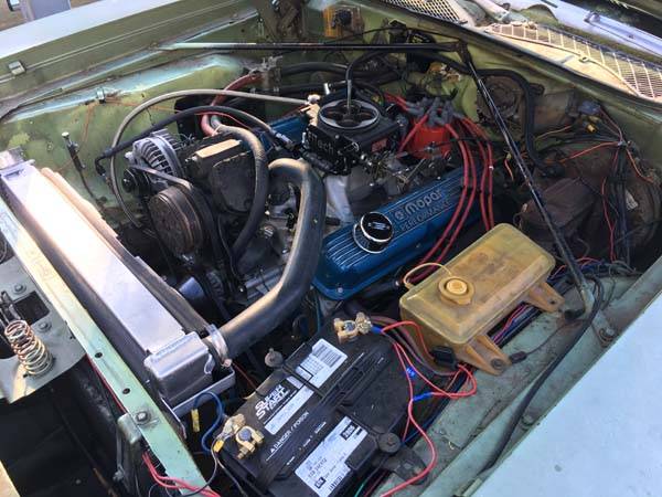

I'd love to see some updated pictures of the car and engine bay...

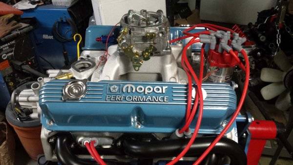

It's 318 stroked to 390 CI. it does not look like much rats nest of wiring to clean up. I was able to drive down to gas station this afternoon and fill up the tank. drove home and clean the windows, aired up the tires, 5lbs low and drove down to A&M Auto Machine to return my old alternator for core. Drove about 10 miles round trip. I was about 4 block from the house and I got on it noticed a puff of white smoke behind me. pulled in the driveway opened the hood found fuel bubbling out of an old fuel vent line. got it plugged up. Then I noticed fuel dripping on the ground back by the front of the fuel tank. Have get up on lift to check it out later. so fare so good. just minor thing to take care of as they come up. the picture is before it was installed.

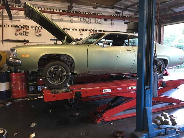

Finished up some more of my bucket list on my car last week. front end alignment, ground strap from fuel tank to frame reinstall after fixing it, and tried to replace the head light switch but could not remove the knob. we pushed on the small button on the back of the switch but could not remove the knob. anybody have some ideas.

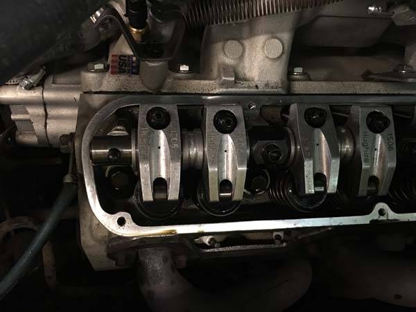

I had a lifter noise on the left side of the engine so I removed the valve cover and found this. the cap was off the rocker shaft and found the nut in-between cylinder 3 and 5. could not find the washer. I ran a camera down in the valley area and could not see the washer. ran a magnet around the valve springs hoping to find the washer in the oil sitting on the head no such luck. hopefully it made its way to the oil pan.
