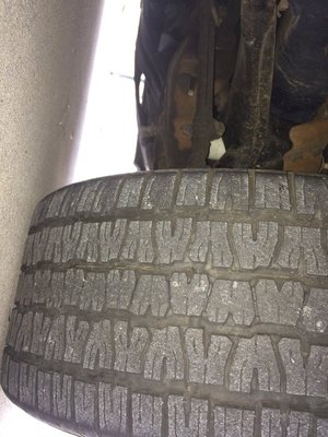

Just want to share a recent experience. My son was driving my 75 Cordoba with 15 year tires to his wedding for photo session. Tires are 245 60 15 TA tires. Driving 80 miles per hour the complete tire treed came off causing the vehicle to turn toward a wall, after recovering from a near miss on a Denver I-25 in heavy traffic he was able to continue to the nearest exit. Left front fender lower sections are bent, rocker panel trim piece was rippled off. My point is I was planning to purchase new tires, but with winter coming a normally pace the b-body in storage. Take warning "Do Not Trust your ride to old tires". Note photo of tread on right side was the same on the left side.

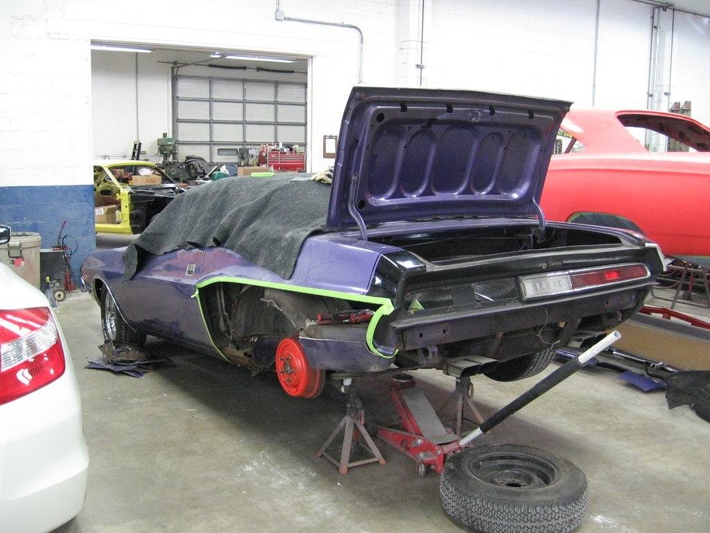

Yeah, 10 year old BFG T/A gave up and took out the quarter on this Challenger.

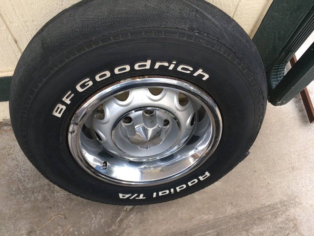

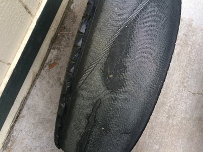

I had a similar problem with a Radial T/A earlier this year. I felt a lot of vibration and bumping through the wheel. I got home and the tires looked okay until I looked at the front-passenger one from a different angle and saw a portion of the tread area was just crumbling apart. You could see belts everywhere and that section of the tire was ballooning upwards until it looked like a motorcycle tire. The tire looked fine from the front, but was a disaster on the back.

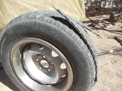

I have seen this happen on interstates. Crazy site!

Appreciate everyone comments regarding my posting. The entire car is not worth an accident let alone a set of tires. I seldom drive the Cordoba, I had a bad feeling letting him take the car just to take pictures knowing the tires needed replacement. Happy motoring and drive carefully.
