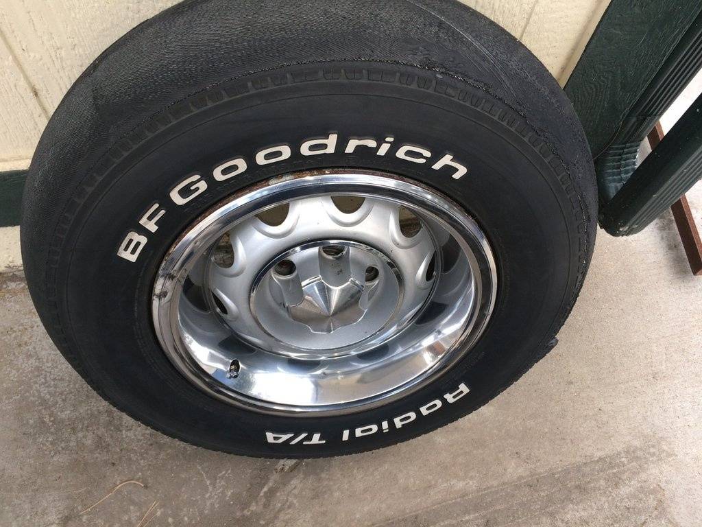

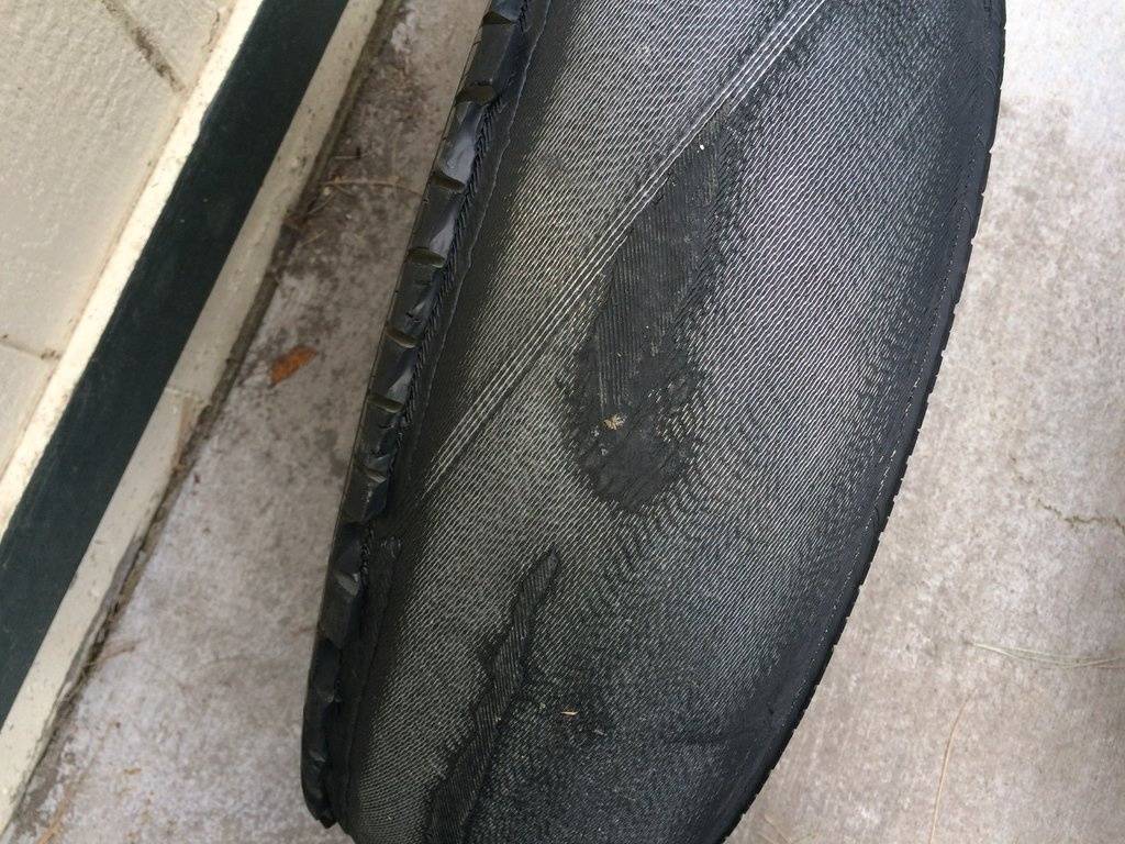

HUmmmmmmm. So junior was driving a borrowed vintage car, 80 MPH in heavy traffic......? I'm glad he's OK and that he didn't hurt anyone else. Do you think he understands that it wasen't just a tire failure.......?

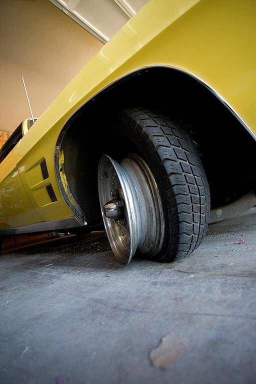

Last year I got my Firebird running after being parked in the garage for 11 years. The tread was good, but all flat, so I aired them up and drove them. One day on my way home from taking my daughter to the movies I heard a "bang" and the car felt odd. Thankfully I was in town and doing 25 mph. I pulled into a parking lot and saw my right front tire was flat. No damage to the car, lesson learned. I bought 4 new tires. Will do the same to my Coronet when I finally register it.

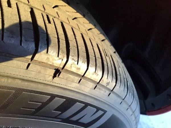

How about 9 year old tires on a (New) Challenger. 12k. Breaks my heart to throw them away. One more trip to Pasadena. These are the original Pilots. Gonna put Coopers on when I have to. This dry rot is COSMETIC right?

The Michelin tires on my 2012 Mustang (built June 2011) look just like yours pictured, and I have almost 30K miles on the tires. I've been a loyal Firestone customer for 20 years, and the tire shop says it's time to replace. I'm waiting on the next Firestone coupon in the mail to buy replacements.

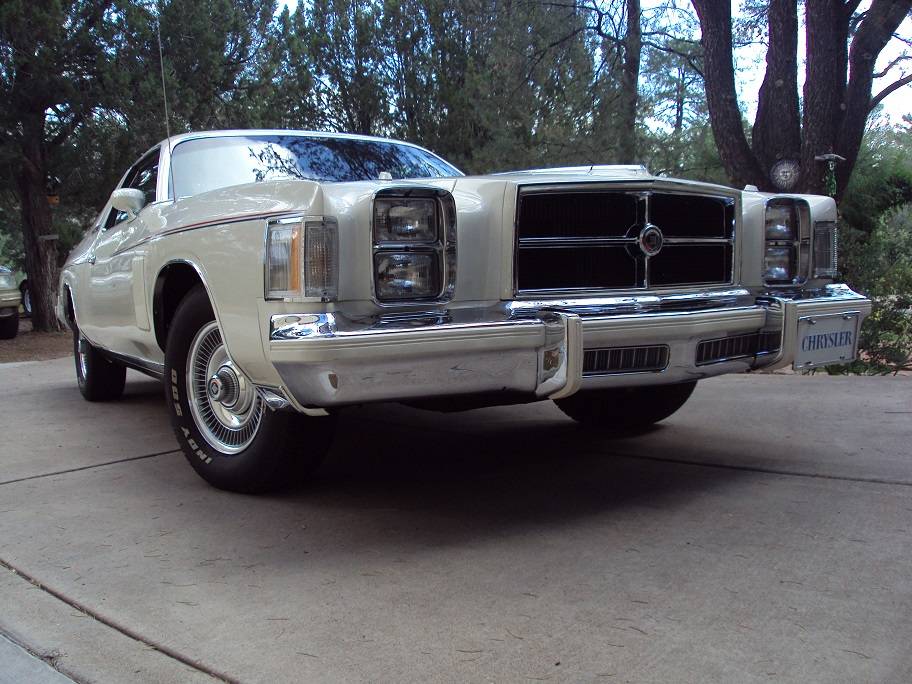

Just want to share a recent experience. My son was driving my 75 Cordoba with 15 year tires to his wedding for photo session. Tires are 245 60 15 TA tires. Driving 80 miles per hour the complete tire treed came off causing the vehicle to turn toward a wall, after recovering from a near miss on a Denver I-25 in heavy traffic he was able to continue to the nearest exit. Left front fender lower sections are bent, rocker panel trim piece was rippled off. My point is I was planning to purchase new tires, but with winter coming a normally pace the b-body in storage. Take warning "Do Not Trust your ride to old tires". Note photo of tread on right side was the same on the left side.

Glad to hear he is safe .

RE: Posts #33 and #34 where brothers want to replace Michelin tires with Cooper/Firestone. If it is for economy reasons I would say fine, but Michelin is a better tire.

Michelins seem to have dry rot issues, and are pricey. Even with a deal at Costco, they cos a fortune for a set. Happy with the Cooper CS3's on the new Charger and the Cobras on the Coronet. Lower priced too.

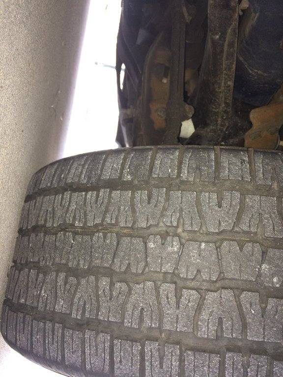

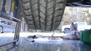

Just spotted this after leaving my car on jackstands for a week. After checking the date code, its been just a hair over 10 years! Amazing how time flies.
The shocking thing is the car rides smooth. I'm wondering if it finally separated once it got the pressure off being up in the air.
Either way, new shoes going on it soon. Now to figure out how wide of a rim/tire i can run on this!
