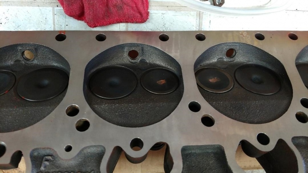

This is one of the 906's before being bolted on:
I dunno, is that a lot of meat taken off of it?
Sorry, I've been out the door for awhile. Meat taken off the heads? Was anything said on the heads, when you bought them, as far as that? You've gotta understand something...motors is a numbers game...measurements! And, what you do with them.

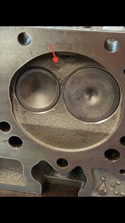

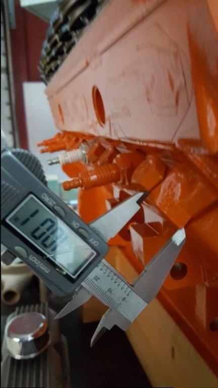

To entertain your question, the actual measurement is taken from the flat spot (red arrow) to the gasket surface. (452 head)
A rough measurement can be taken at the bolt surface to the gasket surface. It will measure 1" on a uncut head. (452 head)
I posted the pic of the head in response to Ski. I was asking if it looked like a lot of "meat" had been taken off of it, so much so that as he said it had become "closed chamber" de facto and bringing into play possible valve/piston contact.

Yes by raising the head up you in effect open the space where the intake sits. Now comes the catch 22 part. Without knowing exactly how much has been taken off of each head you could still have alignment problems thats where the "Kid" showed everyone where to measure on the lower bolt boss, this is where if you can get a pair of calipers in there and get a good measurement it might give you an idea if they were milled the same amount, hopefully they were.
