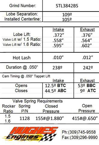

Idles nice and lumpy at 800rpms, 12 in/hg at idle. Spring pressure is more than most due to the faster ramps Hughes uses. Running it at 21° initial / 35° all in at 2400 rpms.
