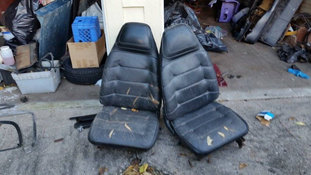

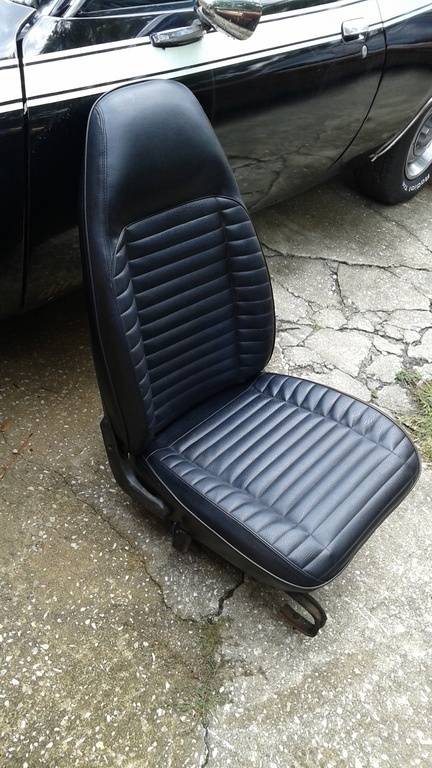

If you look at the covers for a 71, 72, or even 76 seats, you'll see they are all the same shape and size. The design changes, but the size and shape, which is what matters, is the same. For example, this is what a 76 seat looks like...
This what a 72 seat looks like...
This what a 71 seat looks like...
This is what 72 covers and foam look like on a 76 frame...
It is the foam, not the frame, that determines what the size and shape will be as the frame is smaller than the foam.
