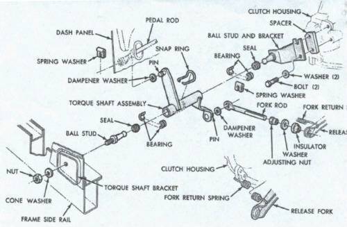

Not sure where the White Washer (69RR) go on the ZBAR. Do they go in front of rubber seal or behind
Thanks Tom C.
Here ya go.
Tom, they go between the Z-bar and the clutch rod, and the Z-bar and the fork rod, to keep a cushion between the metal-to-metal contact, and avoid wear. They are called the "dampener washer" in the above diagram...
