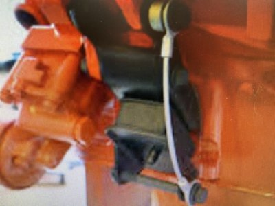

You can occasionally find one of these factory torque straps on eBay. I think I paid $65 for the one I am using.
Had one of those some years back. Don't remember getting rid of it but haven't seen it in years either. Looked a bit on the light side to me to be of any use for something that has a lot of HP though....
I am also running one of the reinforced motor mounts from 440 source. I just thought it looked factory cool. Chrysler used those cable type straps on Police and Taxi applications so the story goes??
