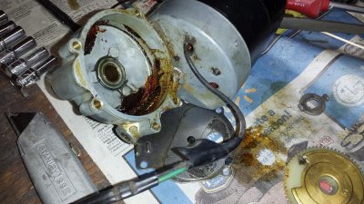

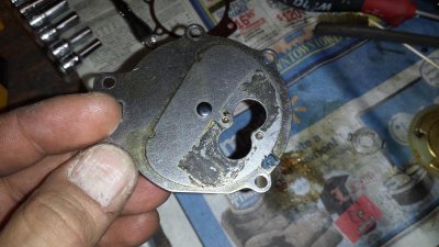

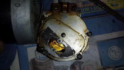

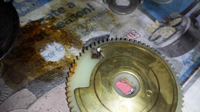

I knew I shouldn't have clicked on this thread. My park wasn't working either, so I pulled the motor to fix it. Hmmmm, that doesn't look right. Two wires going into one, check. Electrical tape covering opening where contacts are suppose to be, check. Electric HARDWIRED into motor, check. And melted gear, check. Some mechanic had his A game going on this one. And the two way connector disinegrated on removal so I have to find one of those too. Fix one thing, find another one broke!
