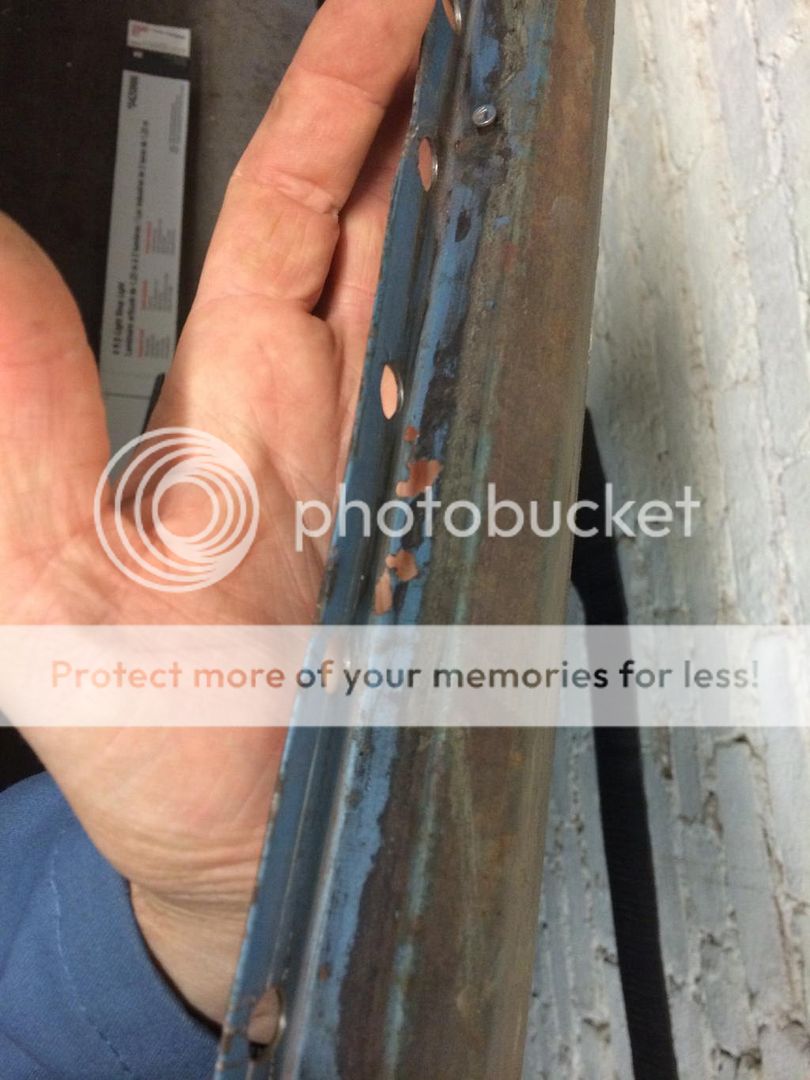

Unfortunately, while cleaning up the donor roof skin, I discovered that this piece of sheet metal is not in 100% perfect condition. The back window channel has some rust perferation, and on the drivers side the piece was cut off the C-pllar with a torch, and the back left corner of the roof skin got torched off by accident.
Here are the rust holes on the back channel:

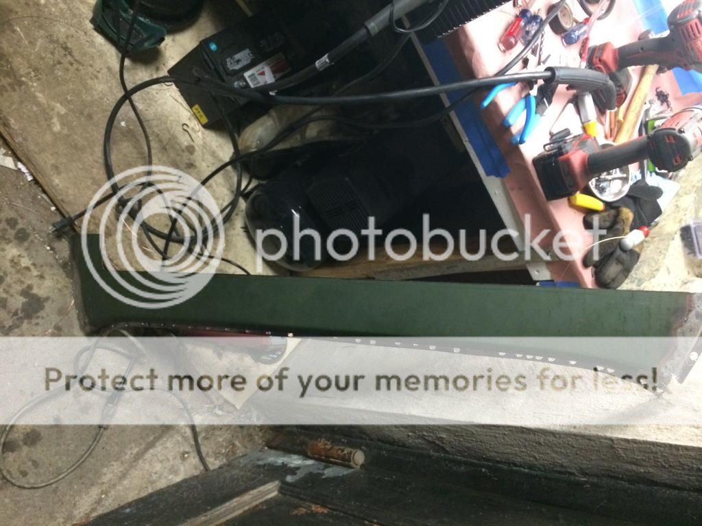

And the lopped-off corner:
NOW! I had the foresight to hold on to the rearmost section of the original roof skin that wasn't covered by the Landau Vinyl Top. That metal was PERFECT. So, I measured carefully and cut this section off the original skin:
I'm just worried... I'm no pro-welder! But I am practicing, and have a decent Lincoln with shielding gas. What worries my is the length of this weld, and the fact that it's a butt-weld.... Do you think I could pull this off without warping anything?
And what would be the best plan of attack? I was thinking, cut the donor skin so that the patch panel fits it, then weld the donor skin to the car and attach the patch panel from there. The thinking her is that with the majority of the skin welded to the car, the piece will be more rigid and I can better maintain the proper shape of the roof.

My only input will be to use only what is needed. Cut the new piece to repair the damaged area. I would not want to weld all the way across the roof line! Just got in from the shop, cut and welded a small patch into my son's Barracuda fender. The smaller the better for me.

The patch piece I cut close enough the the rear channel that is has pretty good rigidity...
Good job so far. Just take 'er slow. Measure twice, cut once. Butt welds are a pain. Practice a bit before you start on the real piece. Having a copper spoon tool behind the butt weld helps to not blow holes through the metal. When you go to weld the skin back onto the inner structure, make sure you tap down the spot weld holes tight to the structure underneath so there is no gap between them. Welds become very ugly when there is a small gap between the two pieces you are trying to weld together. Good Luck! Scott.

See that example that gdrill shows? You want tacks like that, then do them again in between those welds, and keep going until it's all solid. Don't try to pull any stunts like laying down ½" long beads to save time. Keep every subsequent weld far apart from the previous one, that way there'll be no heat build up in any area.
