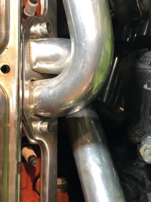

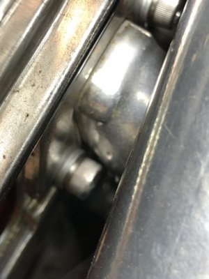

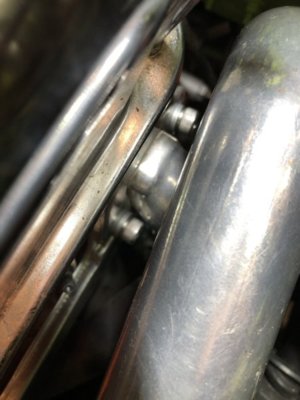

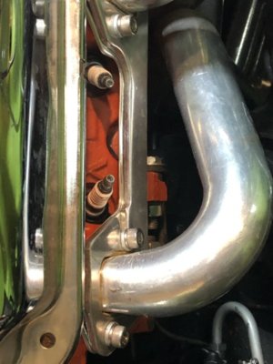

Thought I’d share my results and decisions as it’s always nice to see how some one fared after you try and help a fellow member out. I decided to use stainless steel hex bolts. I am countering the gauling issue was to use a copper graphite anti-seize. Also using the Nord-Lock washers. Latly I used the Percy’s multilayer aluminum gaskets.
Cylinder 5 was an utter PITA. I was not able to get a torque wrench on a few bolts as the header design interference.
971FD058-B847-4BA8-9128-CFC37EF752CB.jpeg 1F4B2F15-A9DA-4A2C-AE88-2041D34D99E8.jpeg 67EFF1B8-E37E-4368-B000-77CF540ED0BD.jpeg 4E6D0685-48C8-4DE2-85E2-FE2C3AA6E256.jpeg
Oh and I replaced the two end studs with the stainless hex bolts and used teflon or PTFE tape to keep from leaking coolant. Hopefully this set up will be stable for a long time.....
