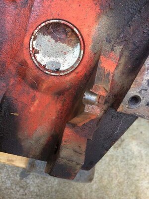

Thanks, I have a nice 68 440 block that needs to be repaired the same.

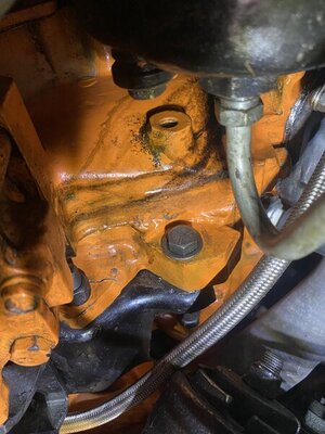

Well it had a good run but had car on hoist rebuilding rear end and getting ready for spring and noticed bottom ear cracked through in a different spot. Not sure what I’m going to do at this point. Really don’t want to do elephant ears. It’s still all sandwiched together I’m thinking I’ll add the torque strap that I said I was going to add that I never did and keep an eye on it.

Little beyond that now hard to tell from pictures but it is broken clean off end to end. That tab was already welded back on closer to the block the previous repair is fine but cracked off closer to the bolt now I suspect all the heat from previous repair made it more brittle. Already pulled motor once to have it welded so at this point it’s either elephant ears or band aid it with a torque strap and watch it.
I've seen an entire ear "built" out of weld, where they didn't even have the piece. It's never too late..... then tie the bugger down so it can't be moving and yanking. It shouldn't be cracking if everything is tight and can't gain momentum.
Everything is tight and I am running solid mounts. Not sure what caused it to crack other than my heavy foot and cast being brittle after being heated previously. Building the whole ear out of weld would really be a better option as long as you get a good bite into the block the weld would be less brittle than cast.

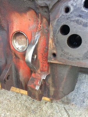

below is a repair using Certanium 889 SP rods, a nickel alloy. Most ears crack because of an over tightened bolt. If the mount is not 100% square it will draw the block inward and crack.

looks good. I don’t think it was misalignment or overtorqued bolt as I was very careful putting it together as it was already repaired and also it’s been like that for 2 years. I may try and weld it best as I can in the car and just ordered a universal torque strap on summit. Try that and keep an eye on it.

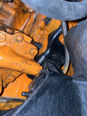

I’ve been brain storming and I think I’ve decided on what I’m going to do and I might get picked on because it is a little bit on the hack side. I want to weld the engine support right to the broken ear. I know welding steel to cast iron isn’t ideal but if I can get a decently strong weld I won’t have to pull motor to repair. I’ve also ordered a universal torque rod to bolt to the engine to add support.
