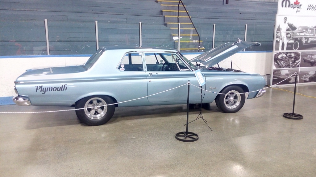

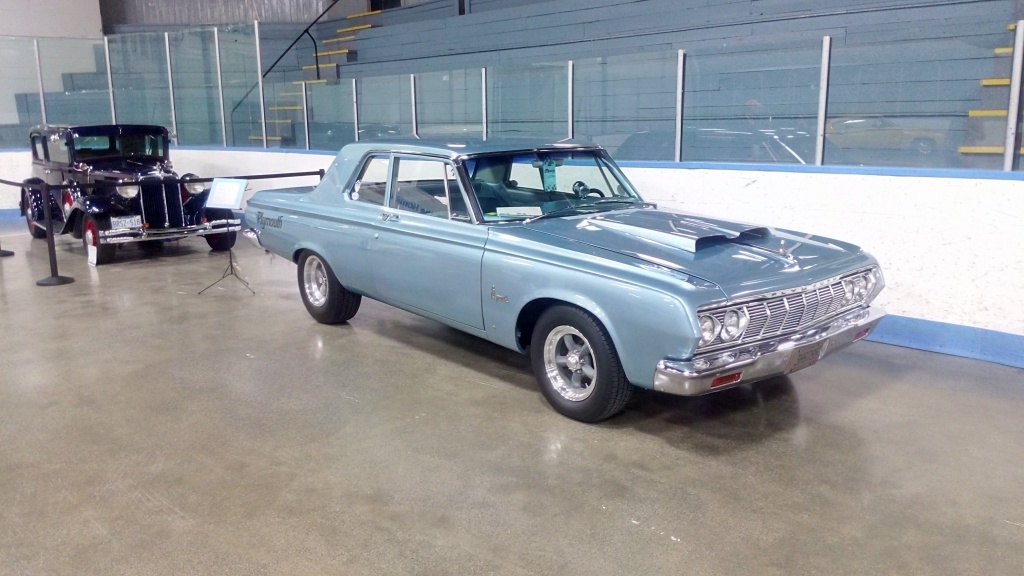

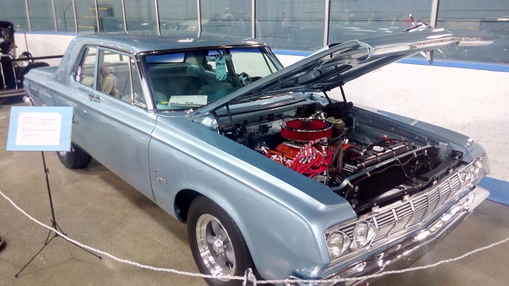

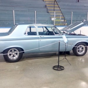

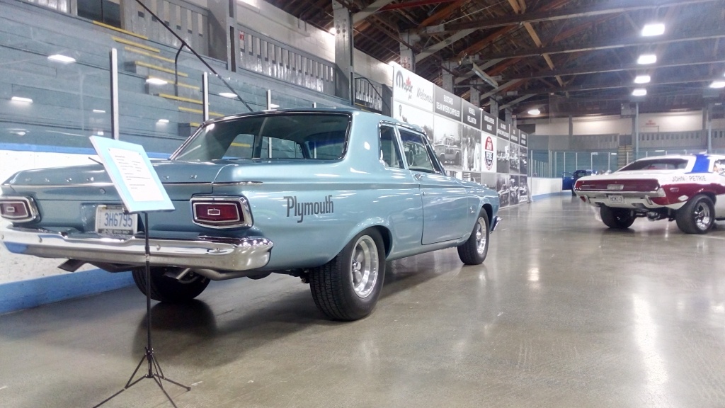

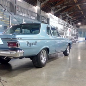

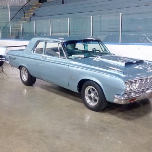

426 Street Wedge.....A100 buckets....push button 727 Torqueflite........8 3/4 posi....pictures from moparfest 2015 inside the arena..... Herb Mccandless was there and he really liked the car......asked him to autograph my glove box........

Very Nice. Couple of questions if you don't mind, what size tires are you running and has the car been tubbed for tire clearance?

Hi Paul. I'm running 315/60R15s. MT Drag Radials. Yes I have the rear tubs moved in flat against the stock frame rails and the leafs are moved in with the re-location kit. Running a 10" rim with a 5" offset and able to go up to 12". Seems to me that there's about 16.5" width up in the tubs.
