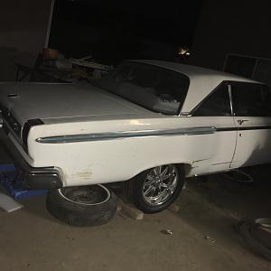

1965 dodge coronet 440

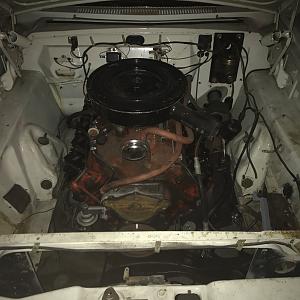

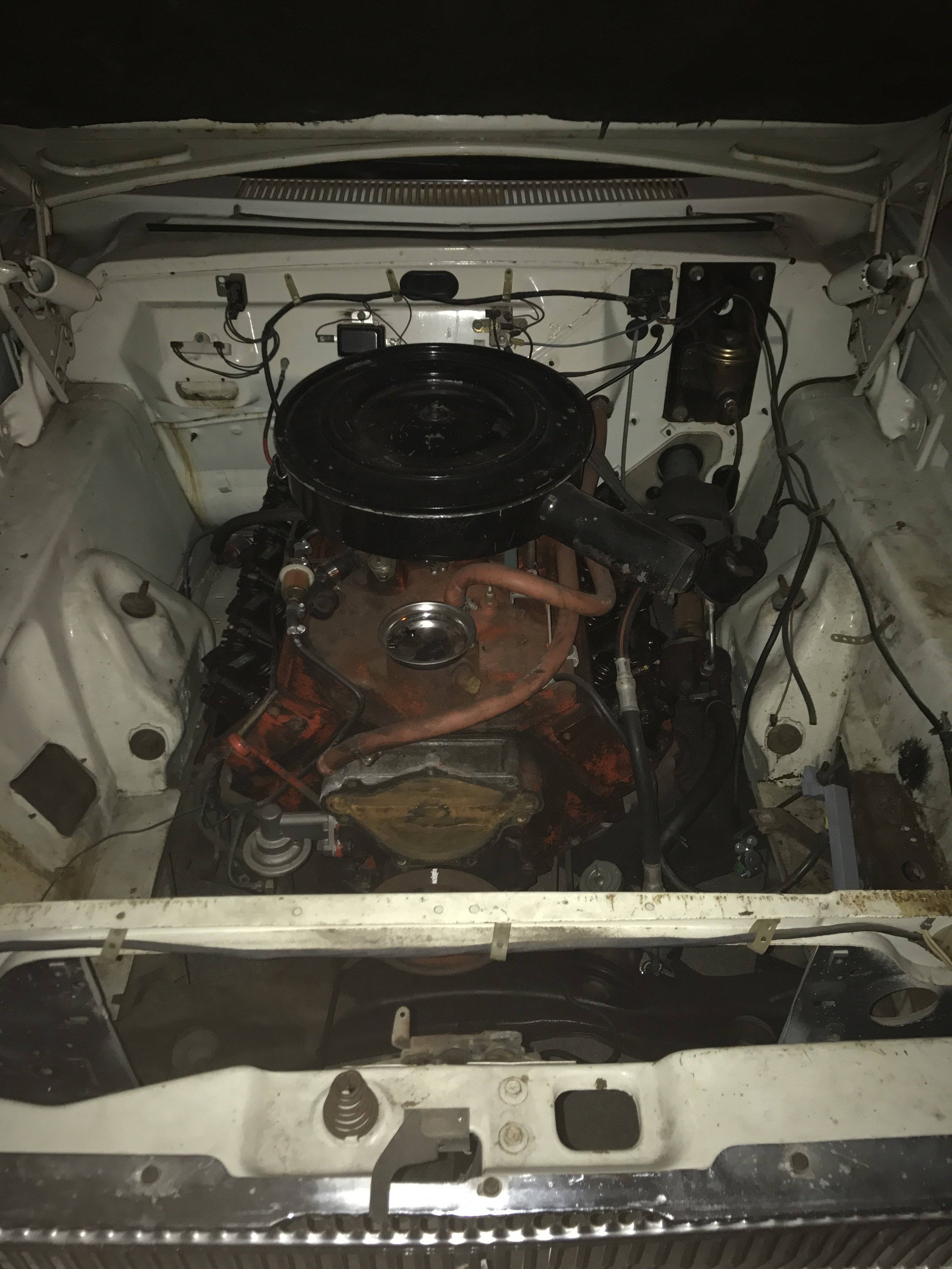

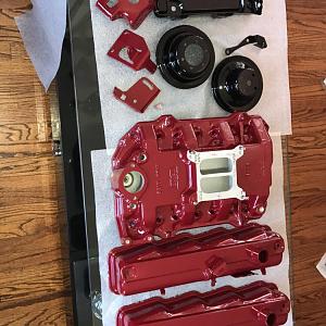

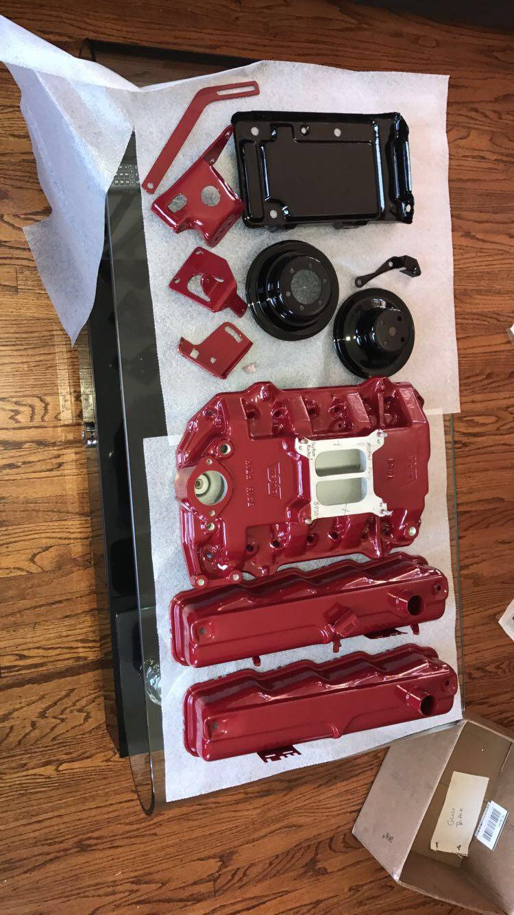

65’ coronet 440 with a rare 318 poly in progress and will be posting pictures of the build here

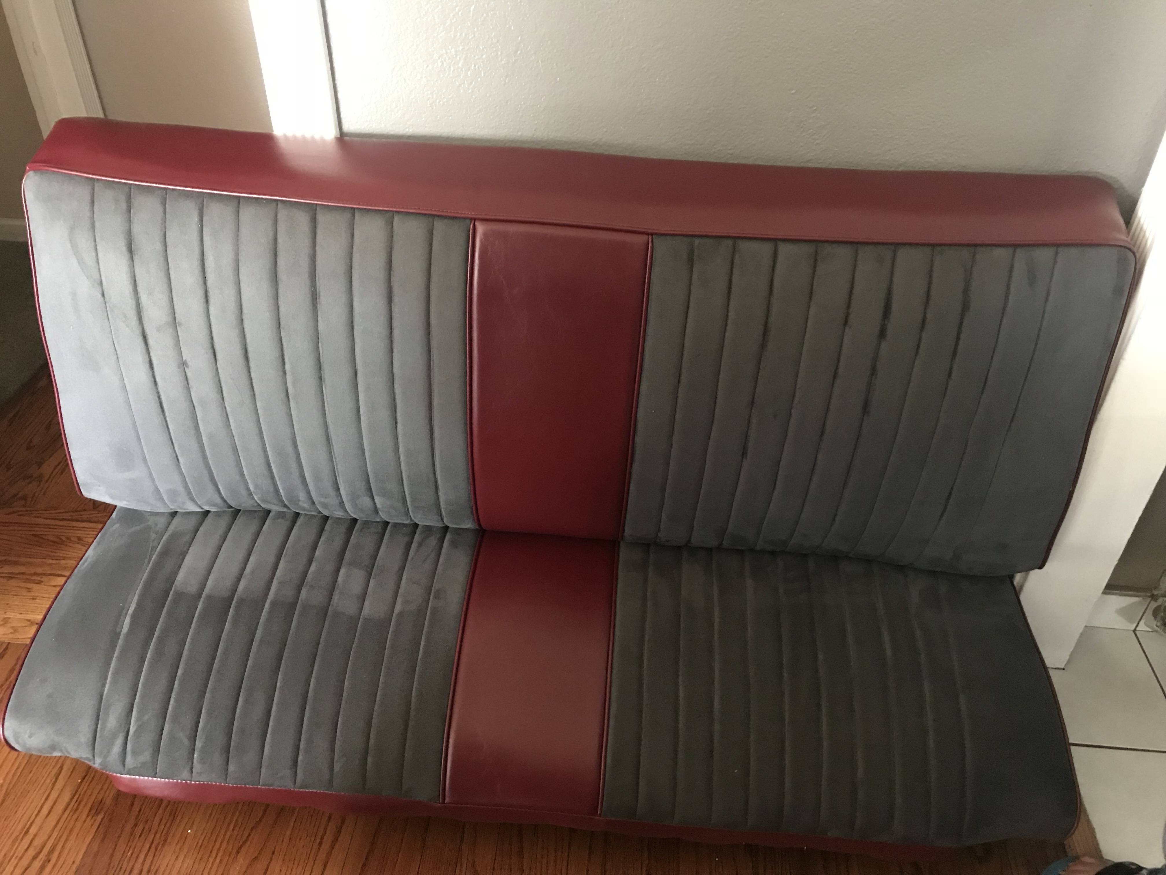

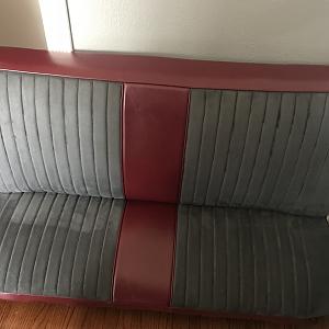

Added a picture of the back seat that I picked up today, had it reupholstered at a local shop and it came out really well

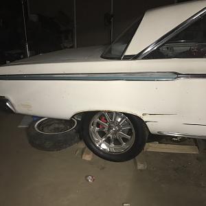

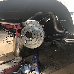

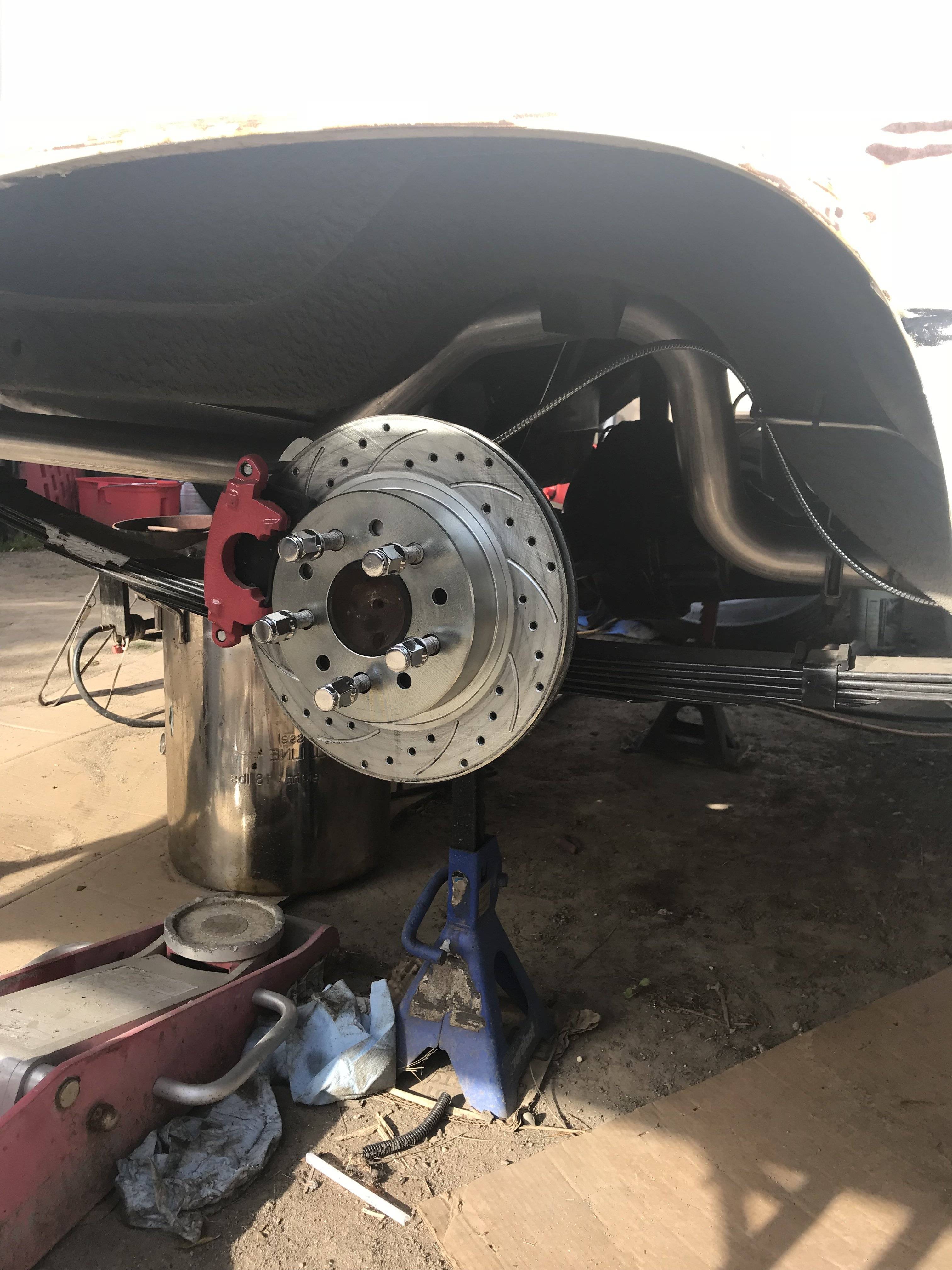

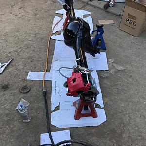

Nice project. That poly looks great in those colours. Is that rear disc brake set up from right stuff?
Cool, I recognized the kit. I have the same one. Works good, one thing though, you will have to bleed the rear calipers partially installed. That is because the bleeders are not at the very top when they are installed and you cannot get all of the air out. Partially install the calipers so that the bleeder is at the very top and bleed. Then install into place. nice car, going to be nice!

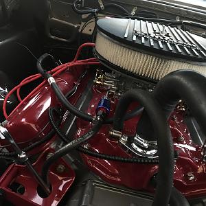

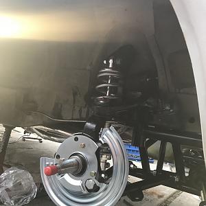

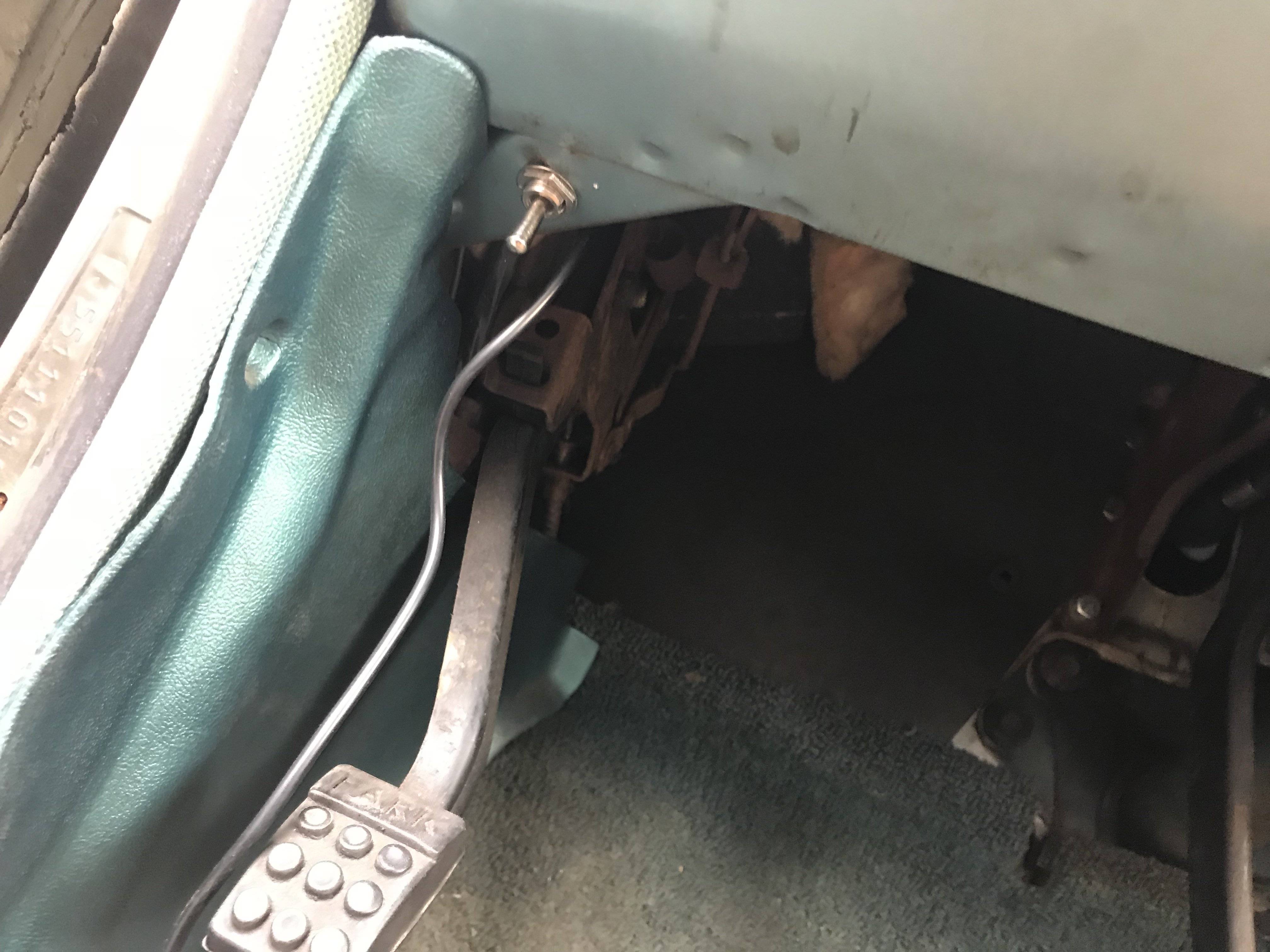

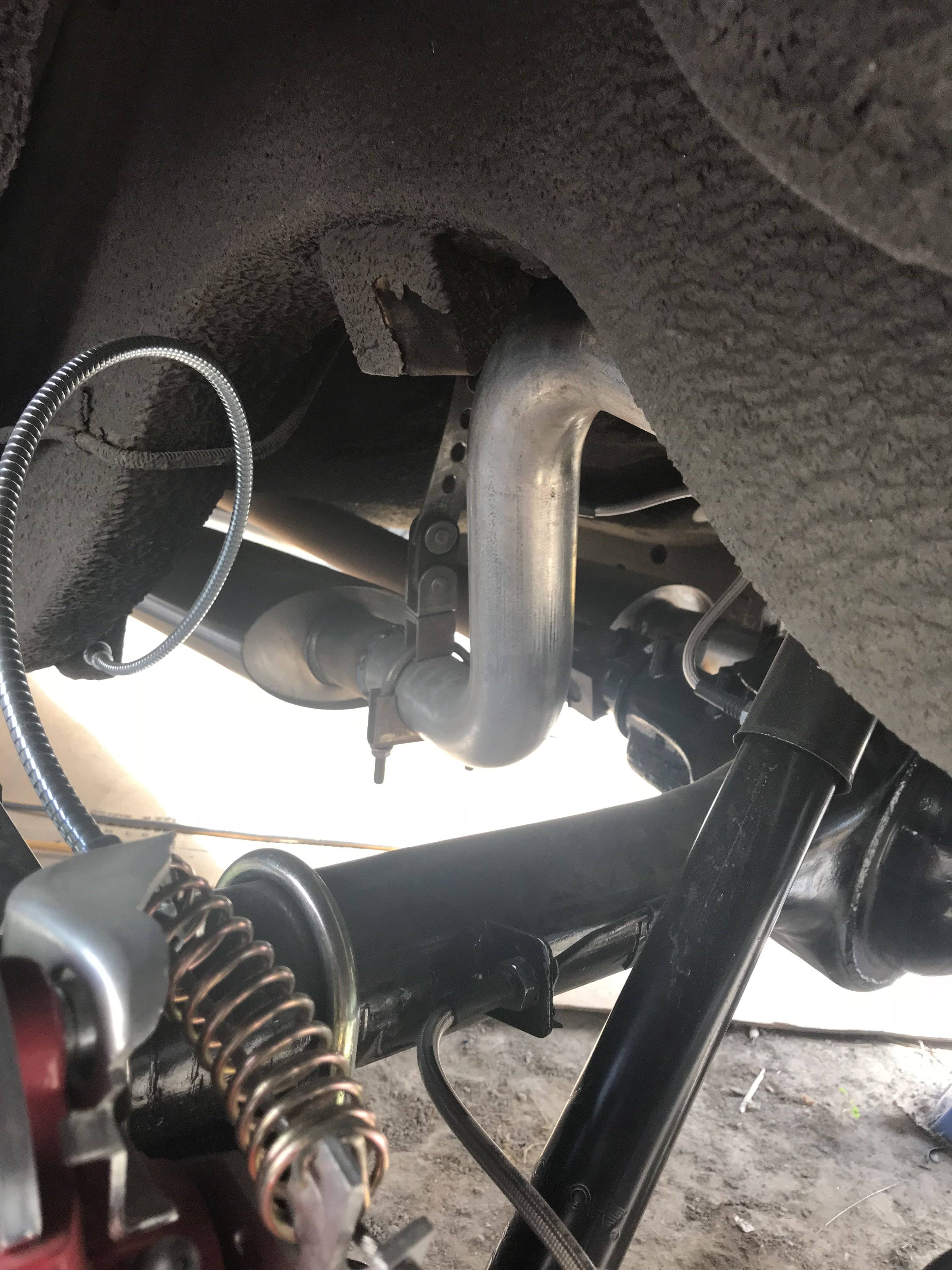

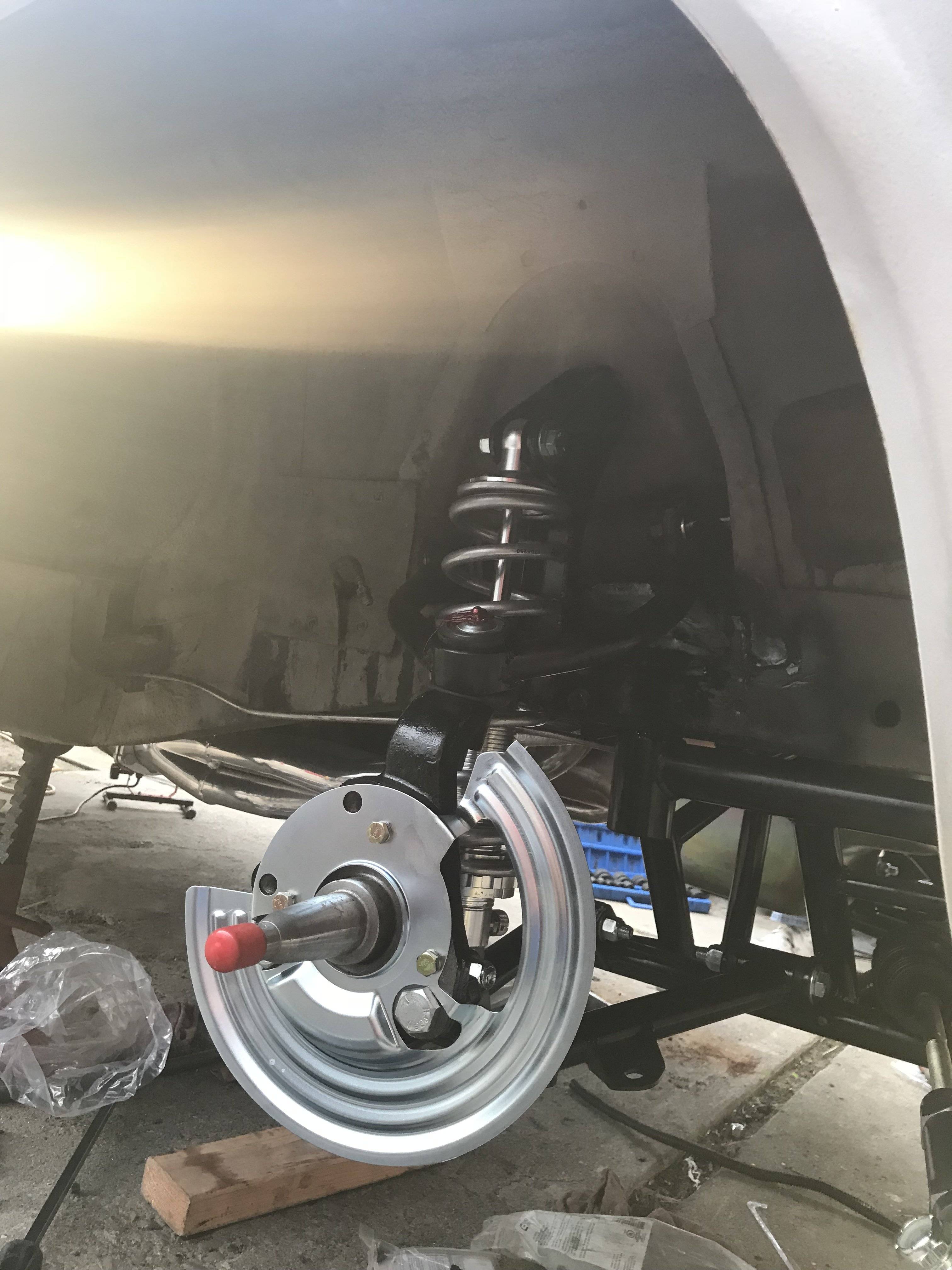

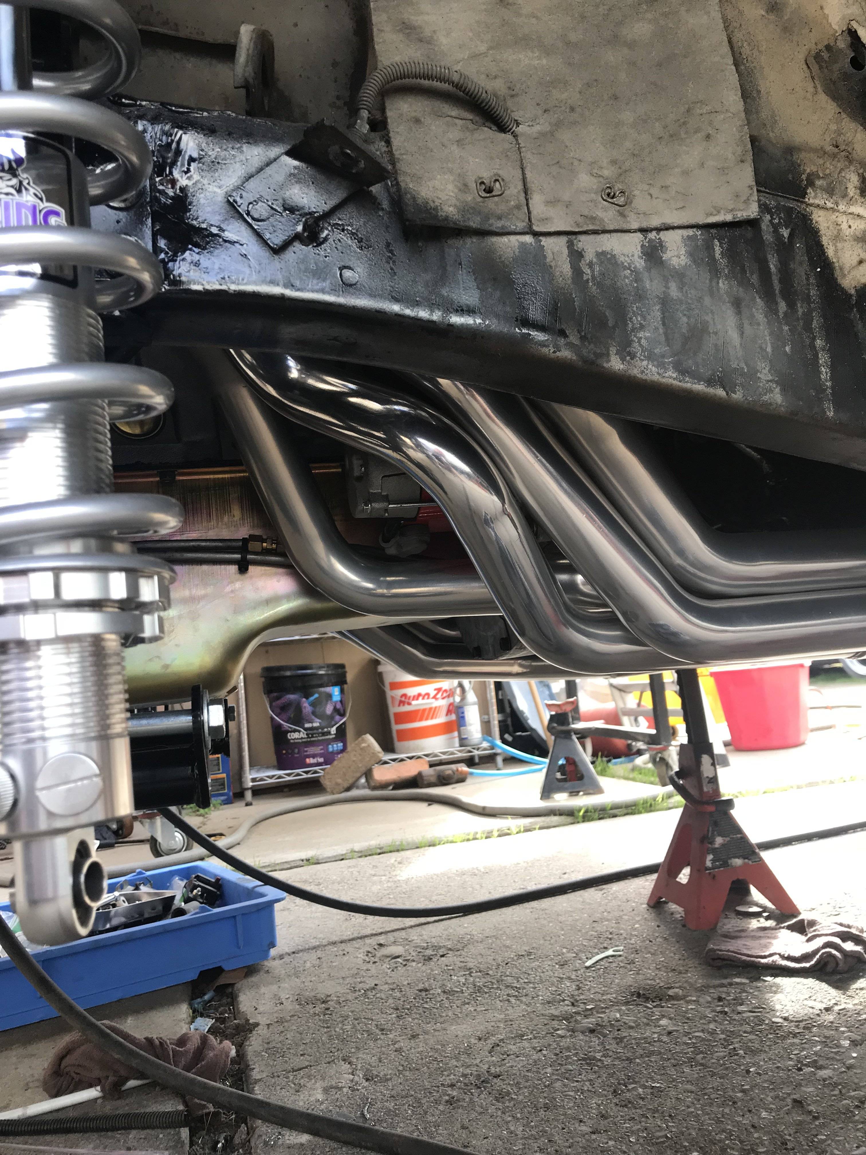

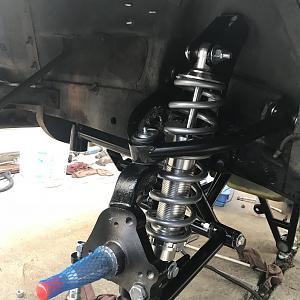

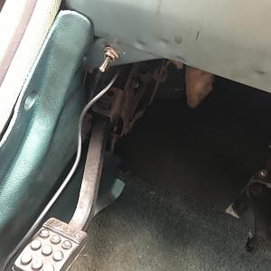

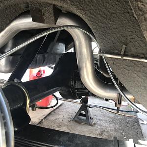

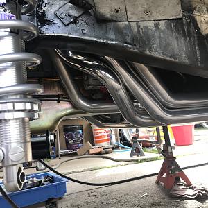

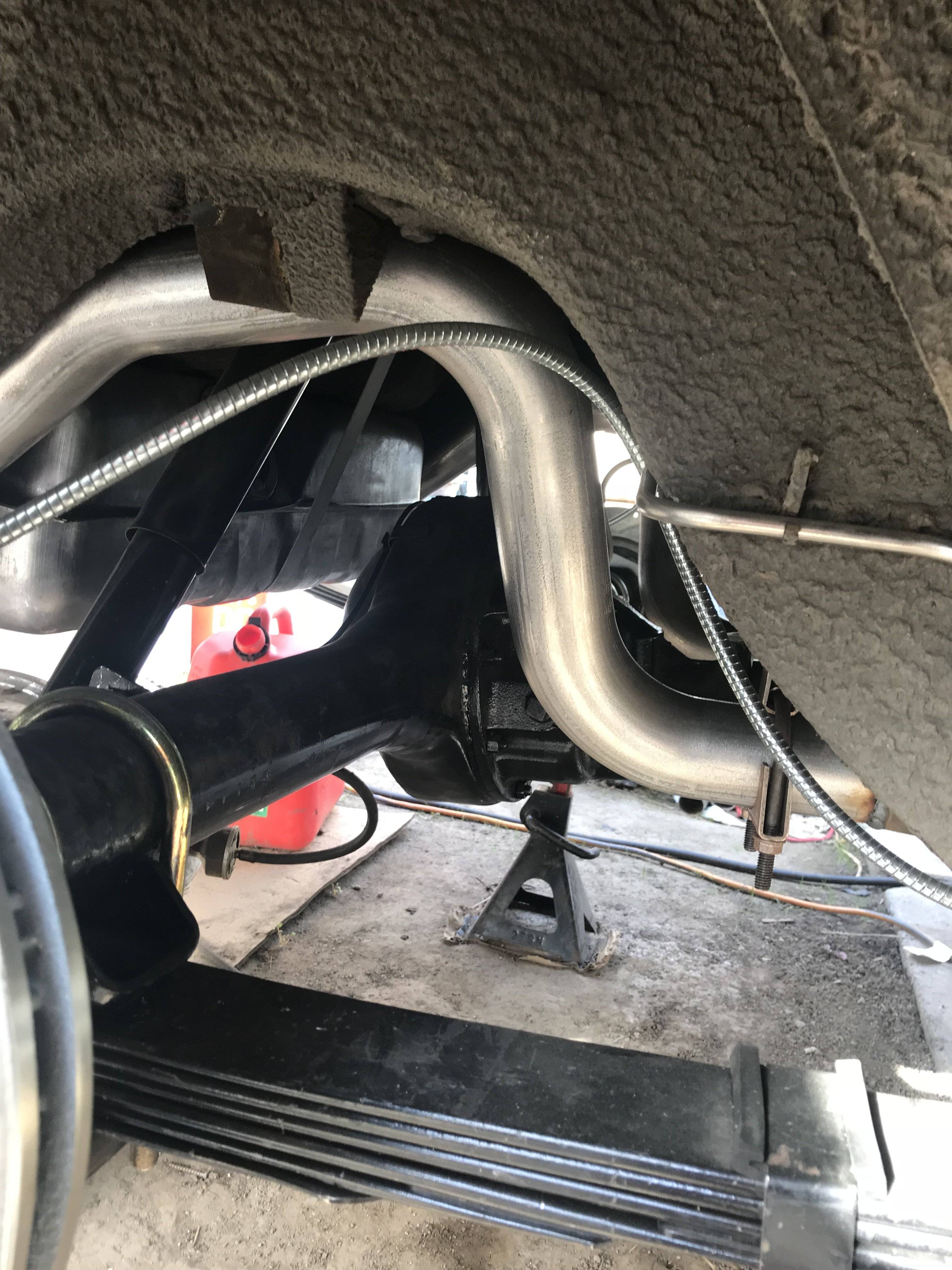

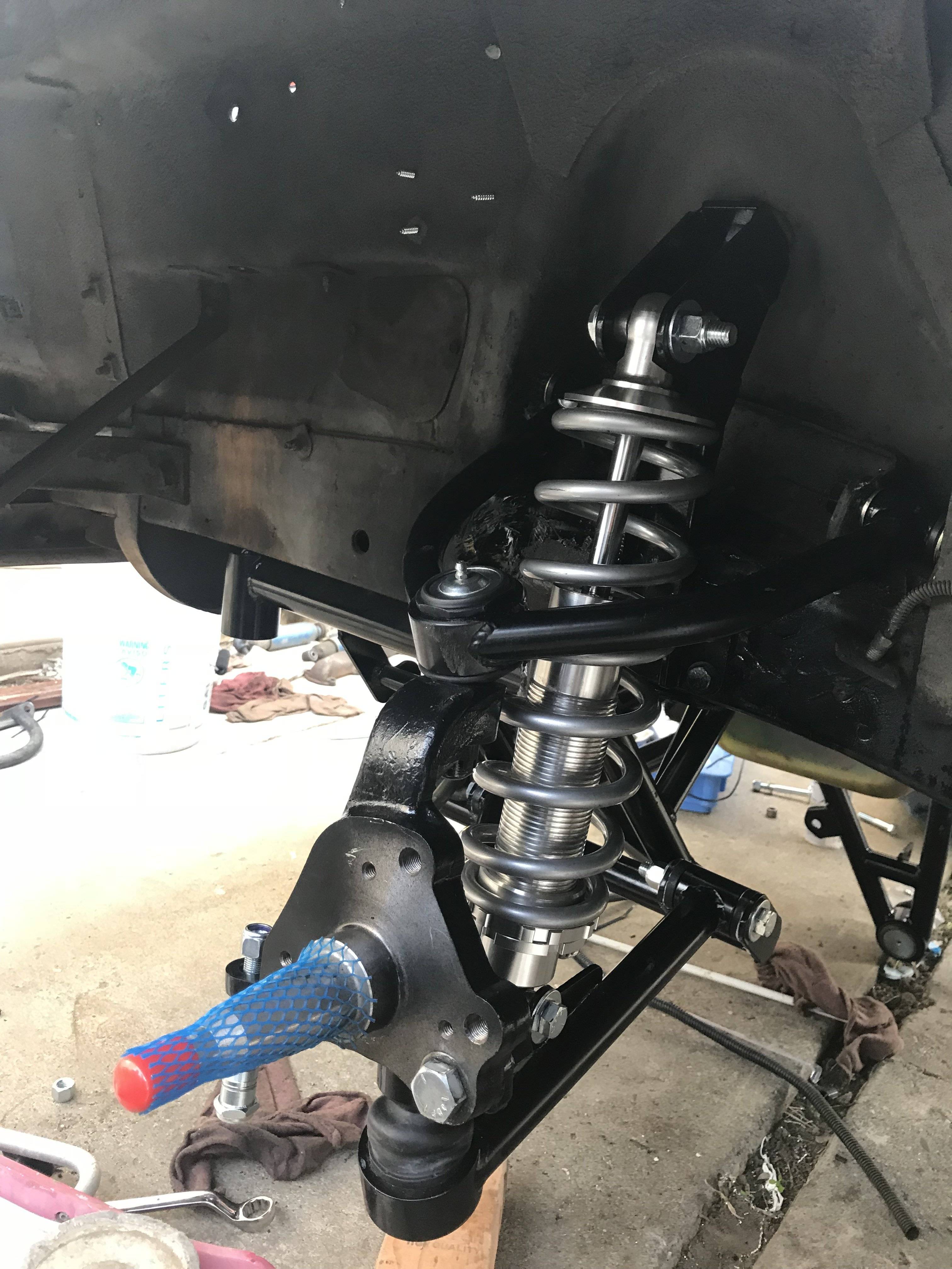

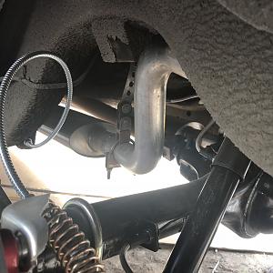

Just put up some new photos of the exhaust, front suspension with he coil overs, also we added a kill switch on it and a custom little switch, all in all, is going great, should be up and driving by Friday
