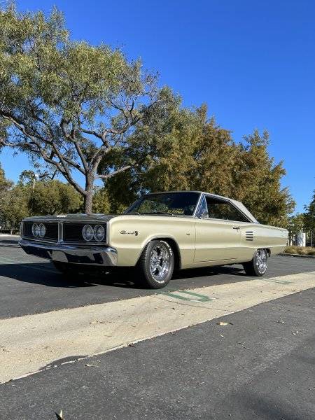

“Tastefully modded”
1966 Dodge Coronet 500
440 cubic inch fuel injected V8
MSD ignition & MSD Atomic Fuel Injection
TKO500 with the wide ratio 3.27, 1.98, 1.34, 1.0, and 0.68 ratios - Sourced from Silver Sport Transmission
OE rear end is a 8.75”/2.94 gear Eaton Truetrac differential
At 65mph it’s approx 1650rpm but usually keep it at the 2k rpm range n mph is about 80mph so definitely a pleasure to drive on the freeway
Wilwood disc brakes up front and OE drums on back - all manual
Hotchkis sways front & rear along with subframe connectors
Borgeson power steering
Wizard Cooling radiator with fans controlled by the MSD Atomic EFI
Tanks Inc in-tank fuel pump
A/C car
Black interior
Many smiles per gallon
