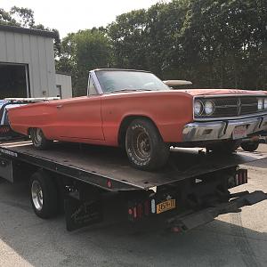

I picked this up on Ebay in Sept 2017. When I drug it home, it was running off of a lawn mower tank in the engine compartment, had no brakes, not even an ebrake. The exhaust was Swiss cheese. Most of the lights didn't work. None of the floor shift mechanism was installed. Even the seats weren't bolted in.
As you can imagine, the journey into the trailer and my driveway were white knuckle rides.

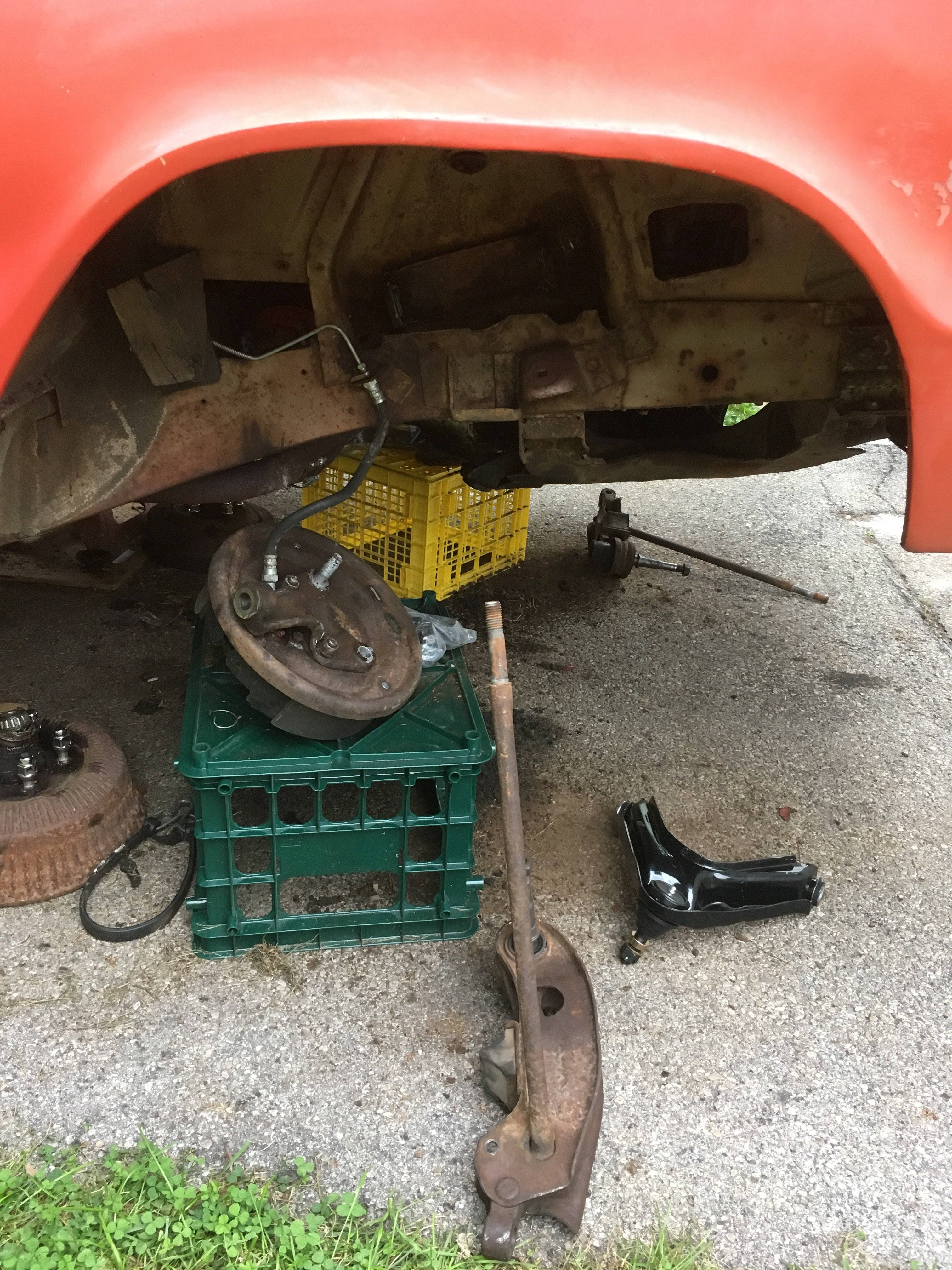

Replaced the entire brake system from the master cylinder to the wheel cylinders, including all the steel lines. (Autozone, Inline Tube)

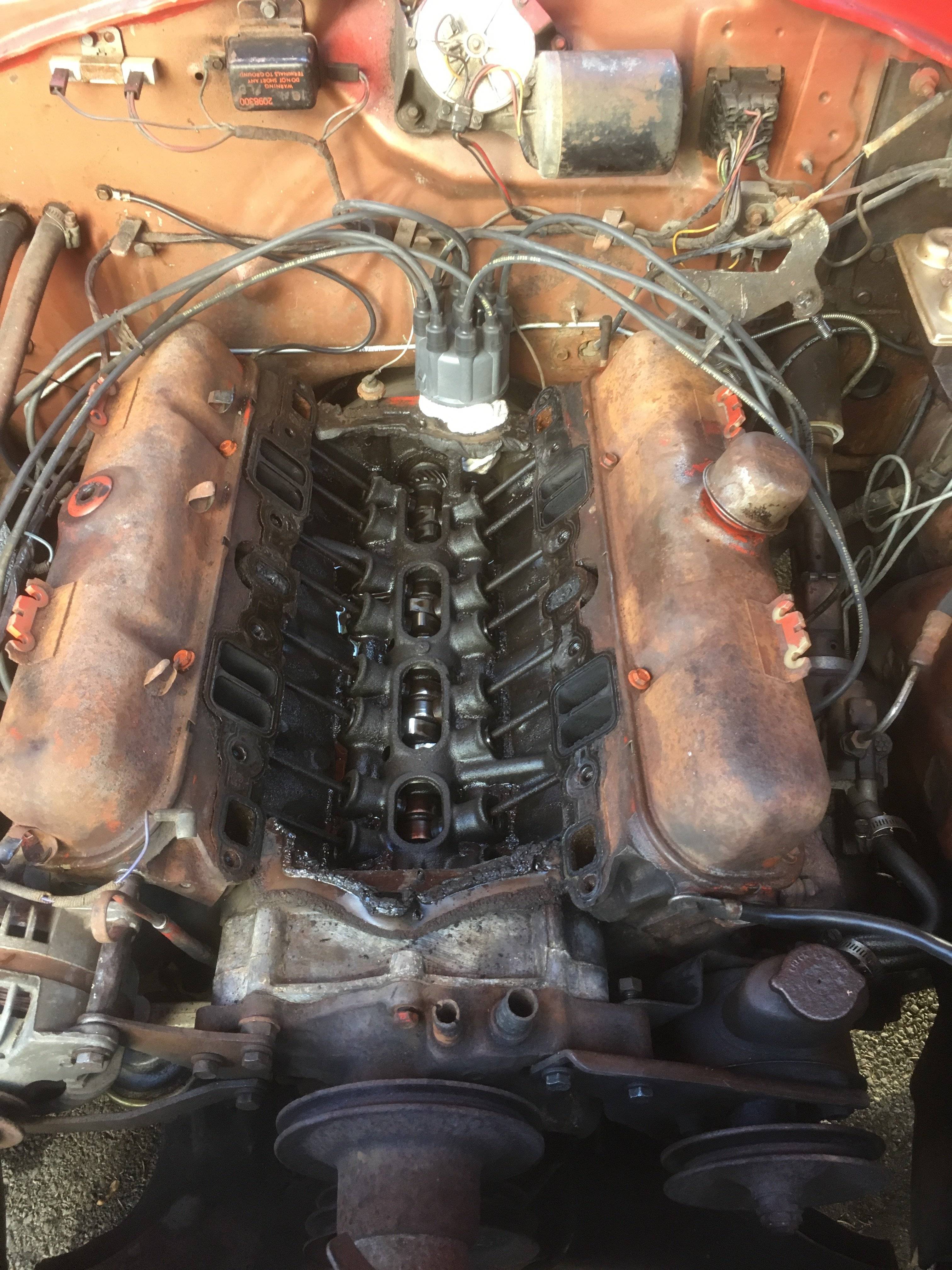

Engine tune up, belts, rocker cover gaskets. (Autozone, Ebay)
Repaired all lighting and gages. (Autozone)
Replaced the timing chain, front core plugs, and all the hoses, added a timing chain oiler. (Autozone, Ebay, FBBO)

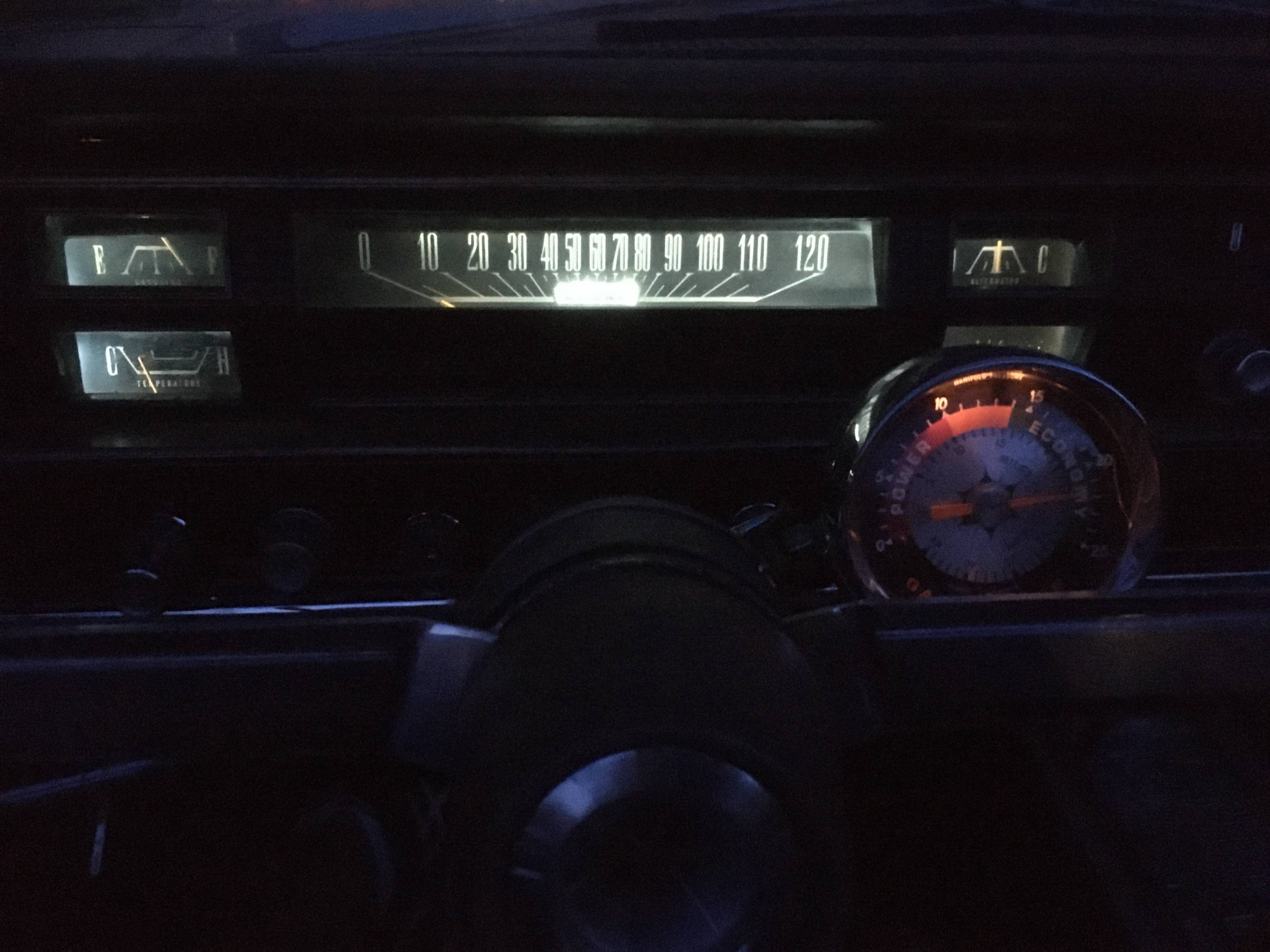

Added LED lights to the dash (superbrightleds.com)

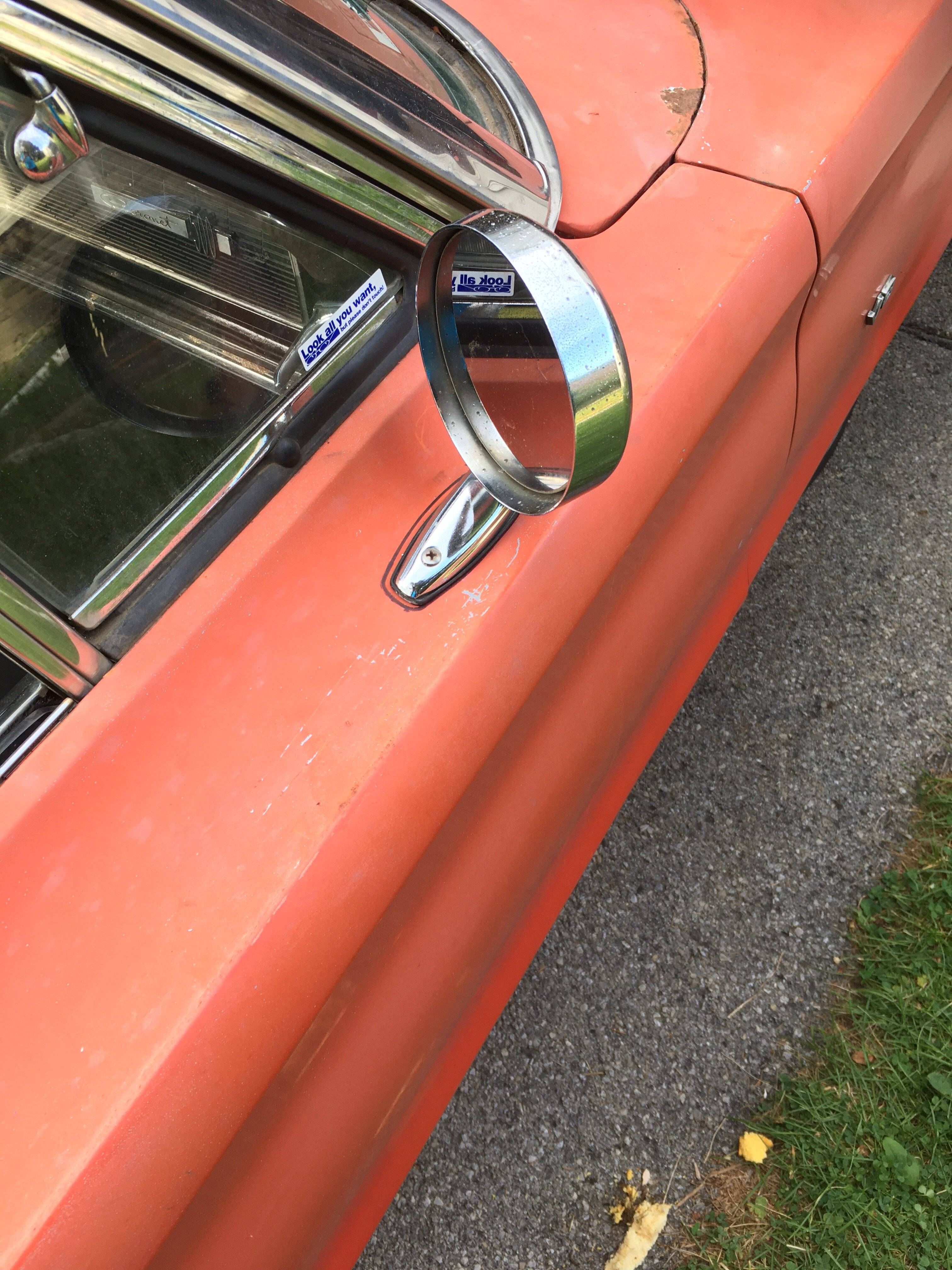

Added a passenger side mirror. (Swap meet)

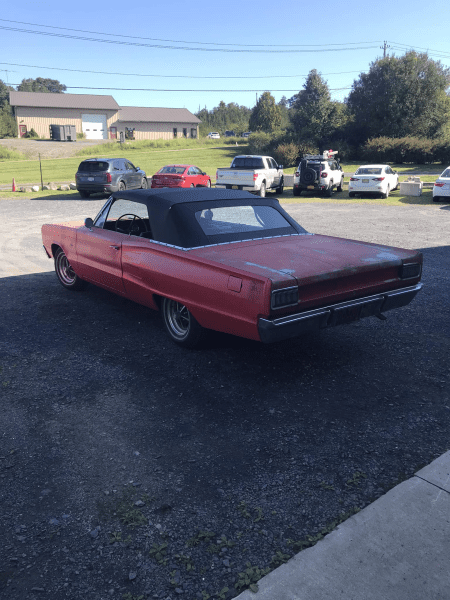

New black convertible top and well liner. (Ebay, Dante's, Gillins Custom Interiors Florida, NY)

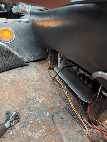

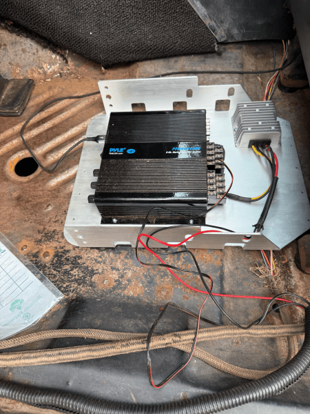

Triaxial 4x10 speaker and BT amp (Pyle, Amazon)

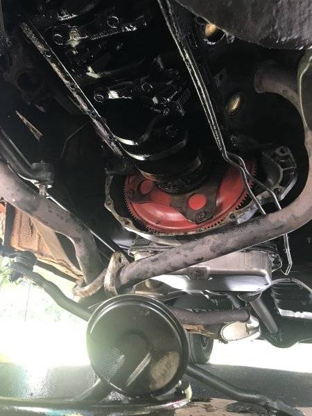

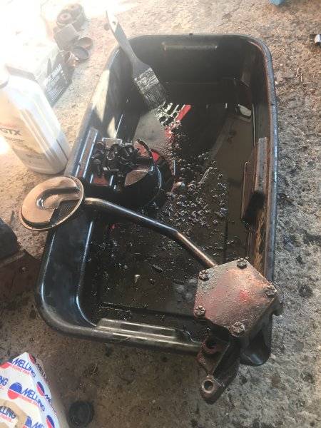

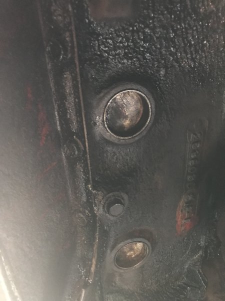

Rebuild oil pump, desludge oil pan, replace freeze plugs.

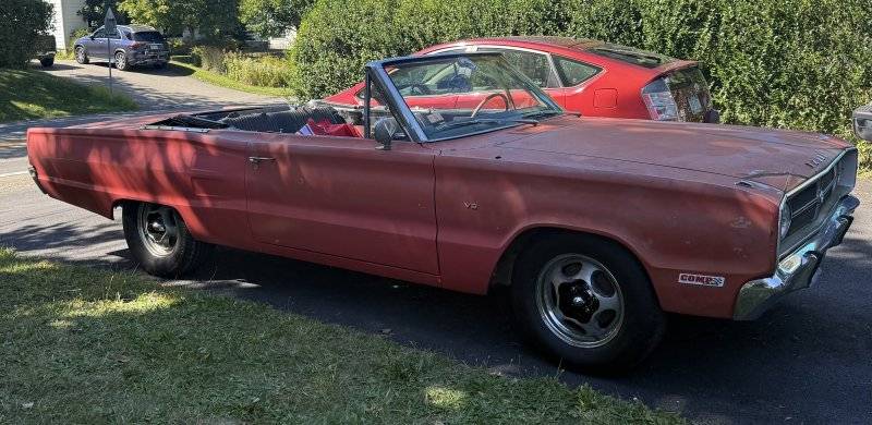

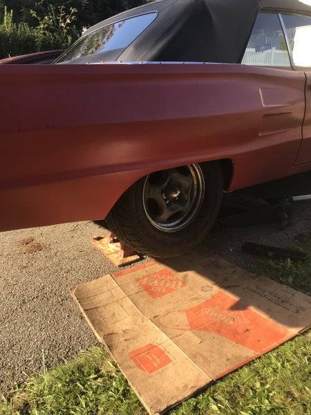

I got sick of seeing my Motor Wheel Spyders taking up space in the garage, so I finally got them on the car.
