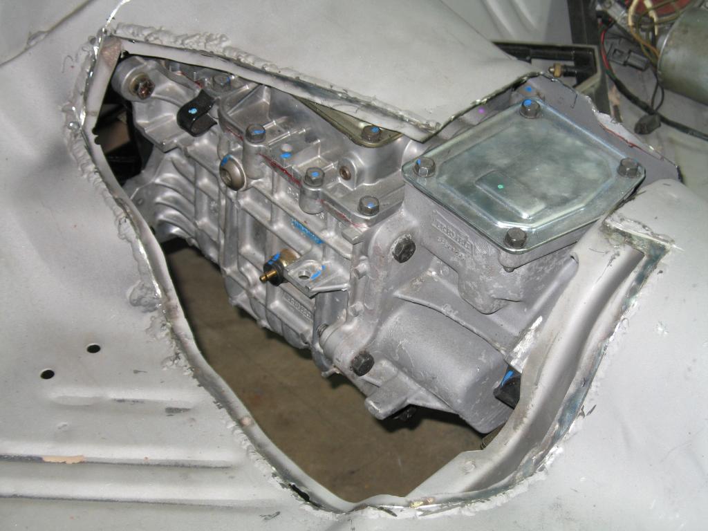

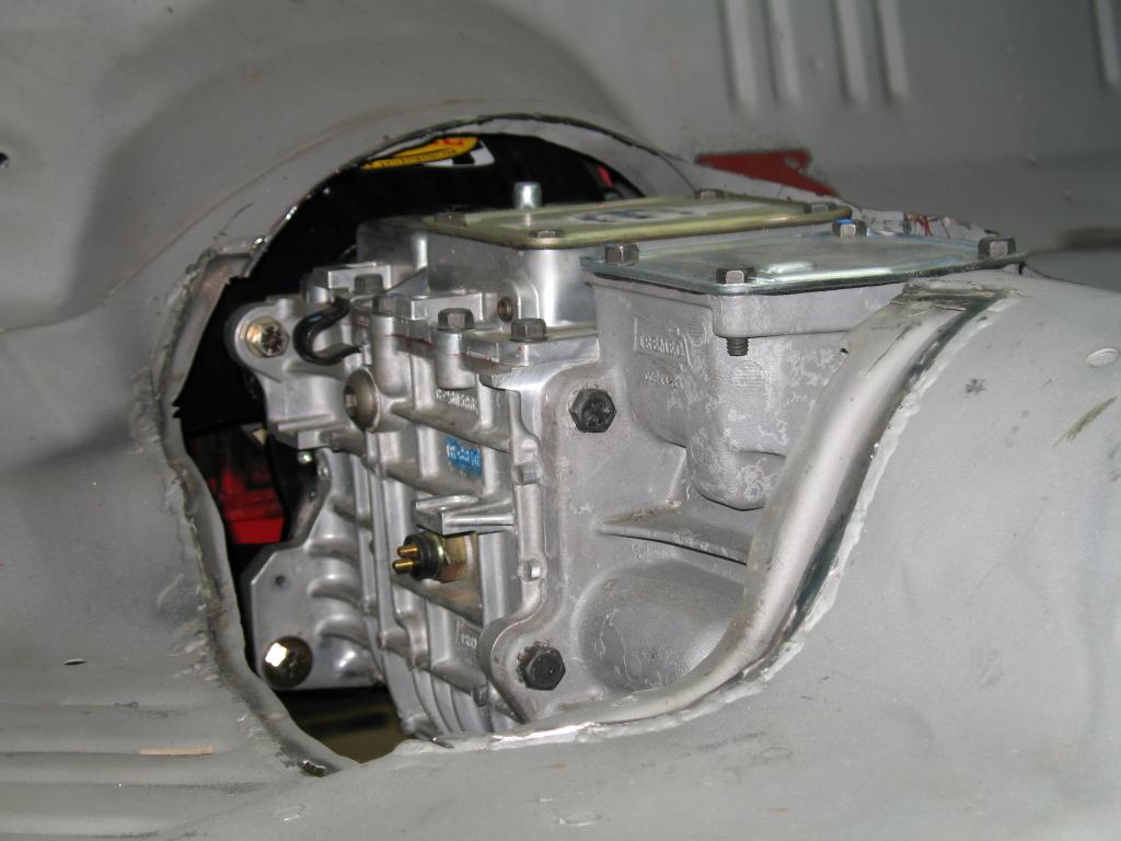

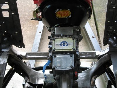

TUNNEL MODIFICATIONS WERE IN ORDER TO OBTAIN PROPER Z BAR GEOMETRY AND AMPLE GROUND CLEARENCE FOR TTI HEADERS. THE TRANSMISSION AS INSTALLED PER KIT WAS NOT CUTTING IT. I HAD TO MOVE THE TRANS 1 " UP TO OBTAIN FACTORY Z BAR GEOMETRY. TUNNEL MOD INCLUDES PERIMETER REINFORCMENT WITH WELD NUTS AND 1/4" BUTTON ALLEN BOLTS FOR EASY REMOVEL TO INSPECT OR SERVICE THE TRANS/SHIFTER IN THE CAR.
