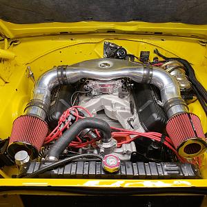

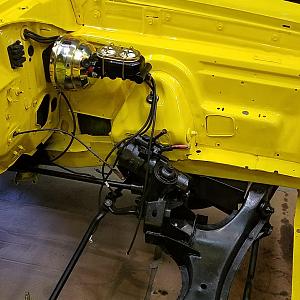

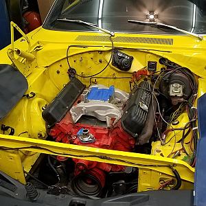

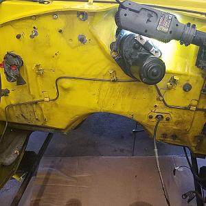

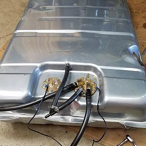

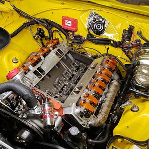

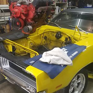

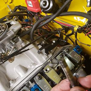

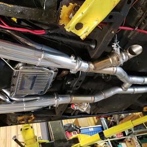

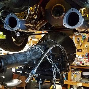

I puchased this 1969 Dodge Charger 18 years ago and have really enjoyed it. The stock 440 was fun but I have always wanted more.
So I set out to replace the entire drive train from Motor, Trans, and Dana 60 rear end. At first I went with the MSD fuel injection system but I had nothing

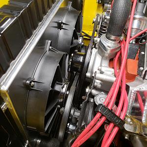

but problems with this and eventually changed to the Holley Super Sniper system which is awesome!! I have had lots of challenges keeping this monster cool and have
finally got it licked. I also have had some roller rocker issues (snapped the bolts twice) but changed them to Harlan Sharp and arp bolts and I think I am good now. This was never intended to be a show car, because I drive the piss out of it!!! This started life as a B5 Blue 383 car and was painted this color when I bought it. Definitely not a purist's car but I am okay with that. Next project is complete front suspension redo - coil overs and such.

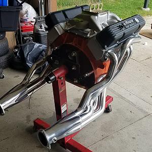

Question: what headers did you use? They look a nice fit.

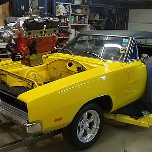

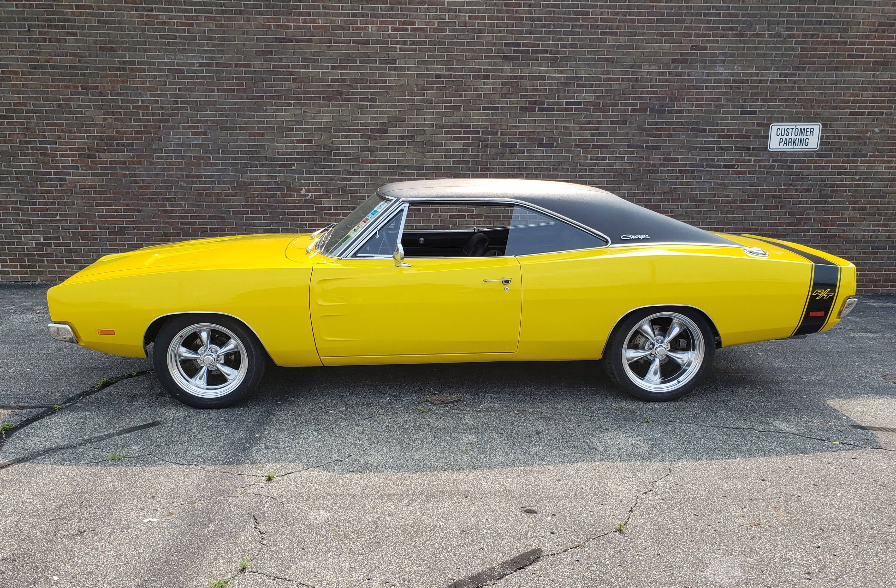

congrats on doing a great job. I really like the stance in the top photo.
Question: what size wheels and tires, also is that stock height or slightly lower?
Thanks, Torque Thrust 20x10 with 305 -35- r20 Contiental Extreme Contact rear 18x8 with 235 -50 - r20 Contiental Extreme Contact. I have it lowered 2" in rear and axle shifted back .7 inches, Its a tight fit but nothing is rubbing!
