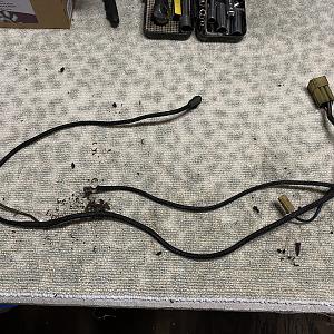

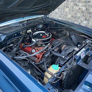

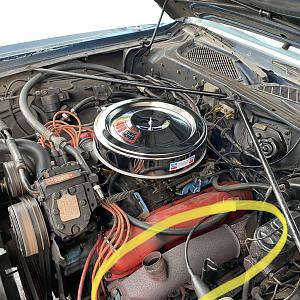

Time to clean up that Lean Burn engine wiring harness.
Currently I'm running a points distributor so I don't need much of the original harness :thumbsup:

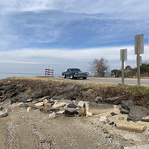

Beautiful day for a drive in the Lowcountry! Drove about 100 miles round trip ;-)

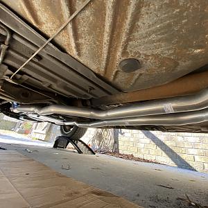

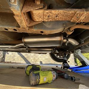

Dual exhaust!!

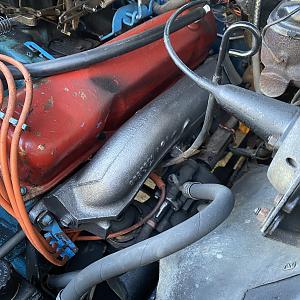

More little things done! Exhaust manifolds coated. New plug wires, spark plugs, cap & rotor.

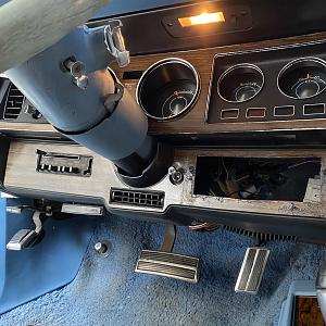

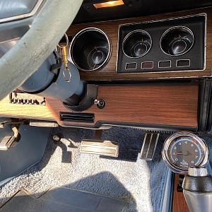

Finally fixed the lower dash cover!
All done! Also installed my aftermarket tach ;-)

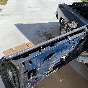

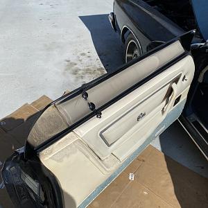

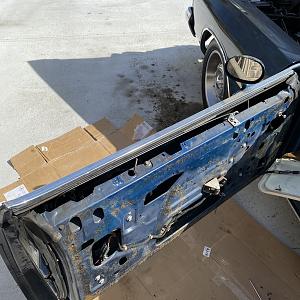

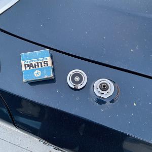

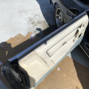

So I had been putting off replacing my door strikers for a while-I knew they were worn out but sometimes little things don't seem that important until you cannot take that rattle noise anymore!
Anyways I ordered up some new aftermarket MoPar style strikers and to my surprise (as seen in second photo) were way to big-- after researching it seemed the GM style striker was the closest to what was on our Cordoba.
Sure as **** I ordered a pair of GM strikers and they fit perfectly! :rolleyes:

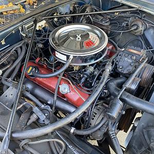

Nice looking engine bay. Is that duct work for a ram air system. Had that on my 73 charger. 318 motor with two to the breather.
Thanks! She is definitely a work in progress. Original air cleaner did have the cool air intake--hate to lose that ,but, I really wanted the MoPar unsilenced air cleaner.
Love that "Power Roar" at WOT!

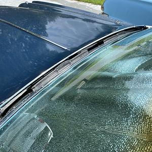

That's great you got the wipers going again. Where did you find the large plastic wheel that sits between the wiper linkage and wiper motor? I bought one off ebay once, but the fit was not all that great.
Actually I found a NOS motor linkage on ebay--for my car it was the best way to go as it needed everything.
