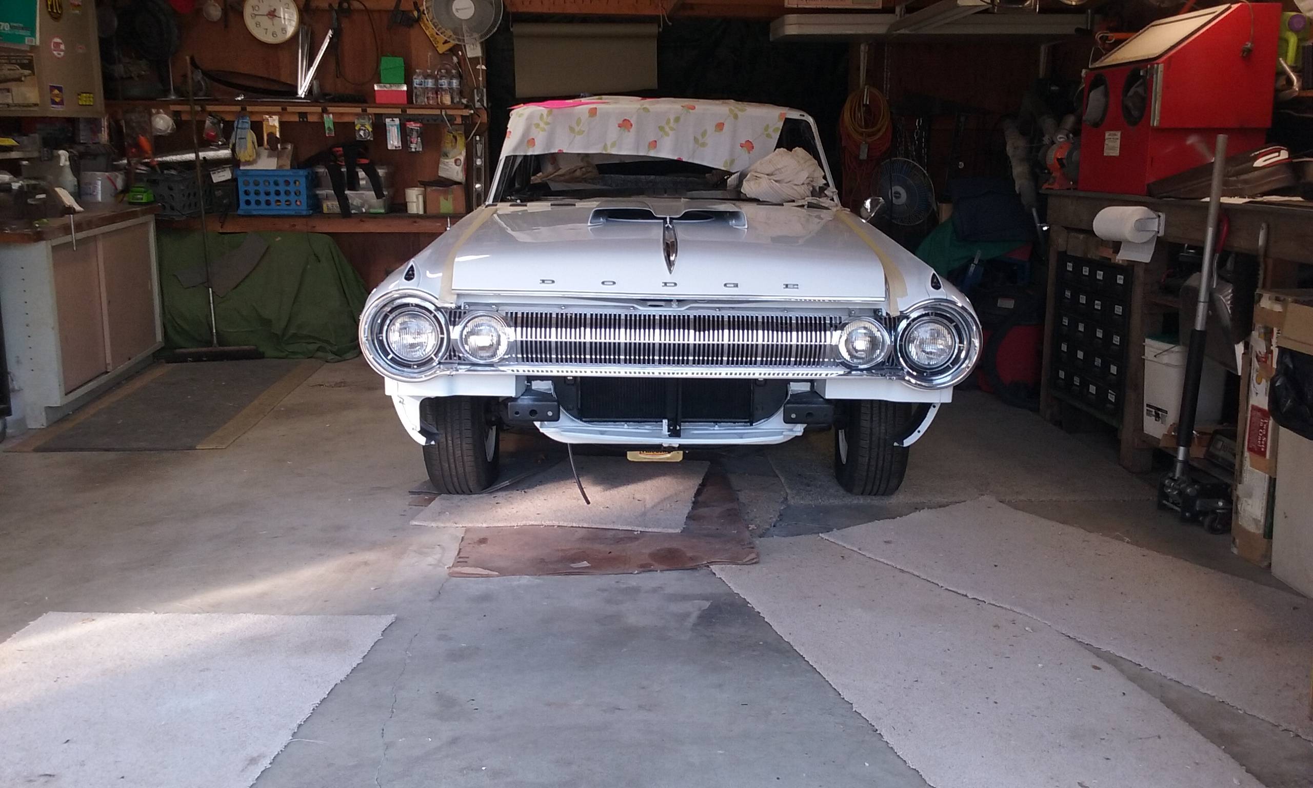

64 Polara progress update 3/23/21
getting him road & strip ready
About this Mopar:
Hood scoop hole cut, scoop on, and it fits perfectly over air filter. Now I just have to align the hood and add some hardware.

Single hole. 426W +0.060. Cope trans. 3.91 489 rear.
To do list next week:
Hook up push button linkage
Weld a picce into my kick down rod since its too short with the modern manifold. Adjust that.
Reset the distributor since one of the ears hits the head.
Adjust the doors...the worst job for last.

Now I will hook up the push button trans linkage in my Cope transmission. Then I need to weld a piece into my downshift rod to make it longer. The intake is about two inches taller than the old one. Funny, I had an old bike kickstand that is the same diameter as the downshift rod.
Then take the distributor out and reset it so one of the "ears" does not hit the head, which limits adjustment. Duh.
Get this bad boy out of the barn soon and have some fun. Bringing a 64 Dodge Polara back to life as a new machine.

The trans linkages is in and adjusted. I welded in a section 2 1/2" long to the downshift rod (at the bottom). This keeps the rod in the proper position for a streight push-back. A friend of mine added 2" to his 63 down shift rod on the top section and that never worked right. So I learned form his attempt. That appears to be the ticket. When the throttle is wide open the lever is pushed all the way back to get max pressure under load. Power steering is in and working. Hooked up my old Sun Super Tach. It goes with the rest of the car. Lights work, turn signals work, brake lights work, interior lights work, wiper motor works. Dash lights are another story and will require some work this winter to get them working. I put in all new bulbs but they are not working. Engine fires right up and I can get full swing on advance now that I reset the distributor into the correct position so the ear does not hit the head. I also changed the springs in the MSD distributor for a faster advance.
