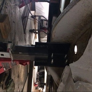

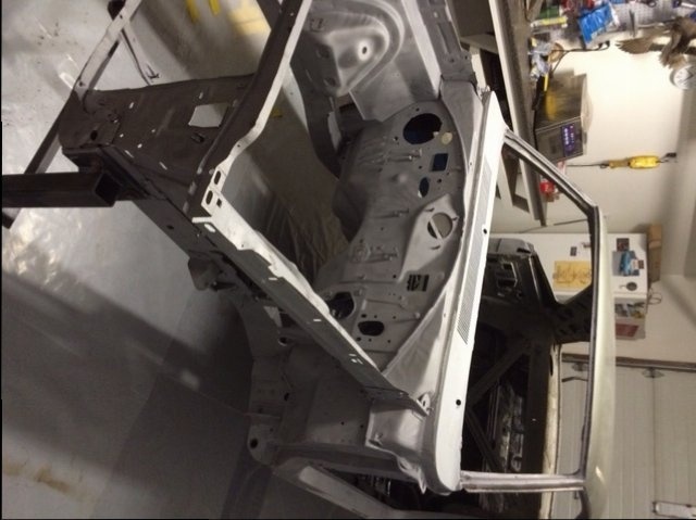

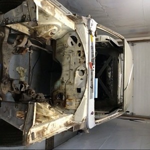

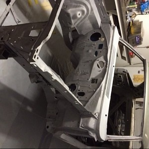

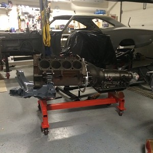

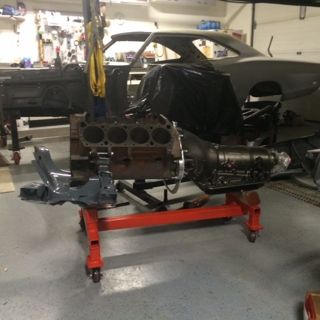

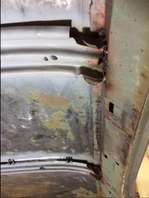

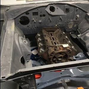

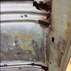

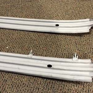

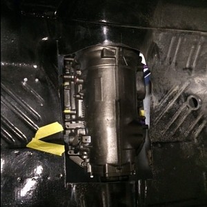

I got my roof ribs cleaned up and used Tiger Bond to seal them to the interior roof as I welded them in place. I pulled the entire running gear and "bagged and tagged" as well as pictures which took me over a week. I laid out and built legs with good wheels to be able to move her around in the garage, which was a tremendous help. The engine was completely torn down and went to a local engine builder while the rest of the parts went in big plastic containers in an out building I have. What a mountain of boxes! Fortunately, I labeled every lid with contents and a black sharpie so I know where to find pieces. The build continues.

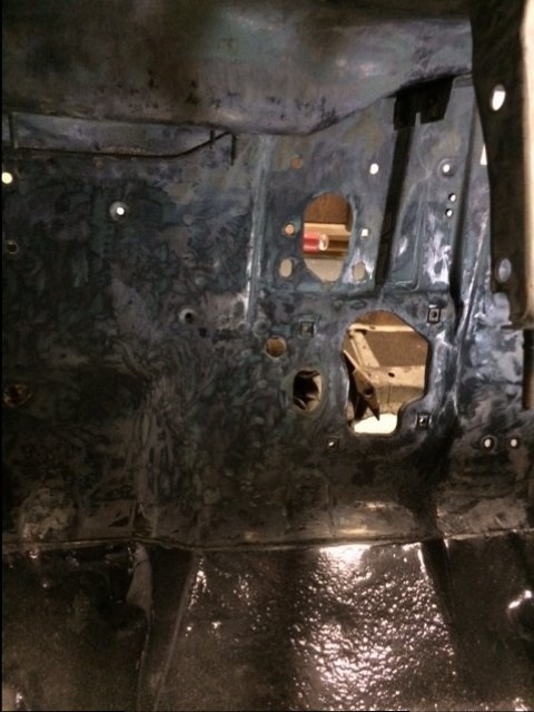

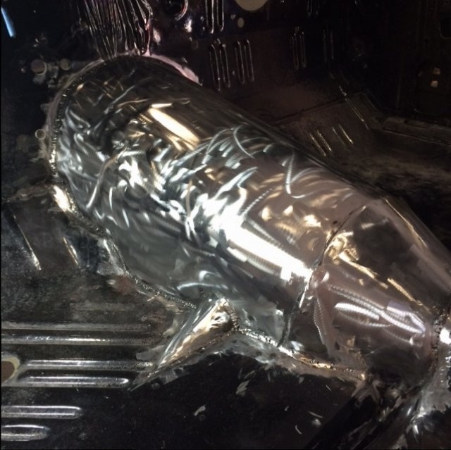

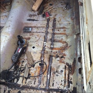

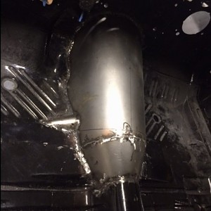

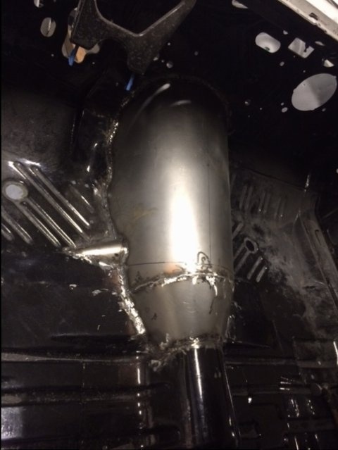

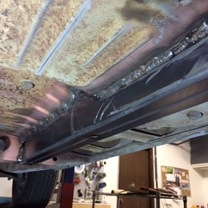

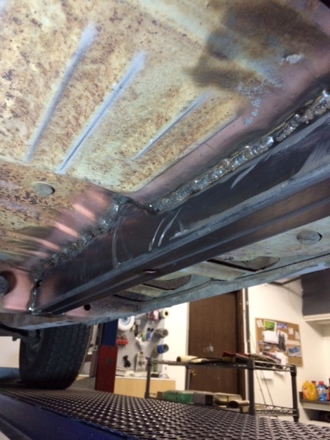

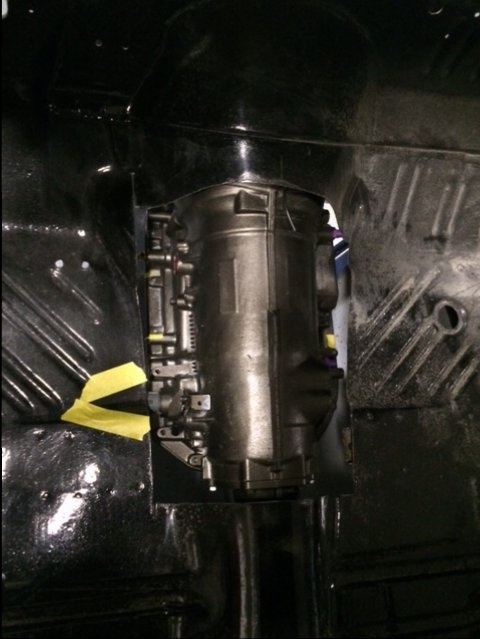

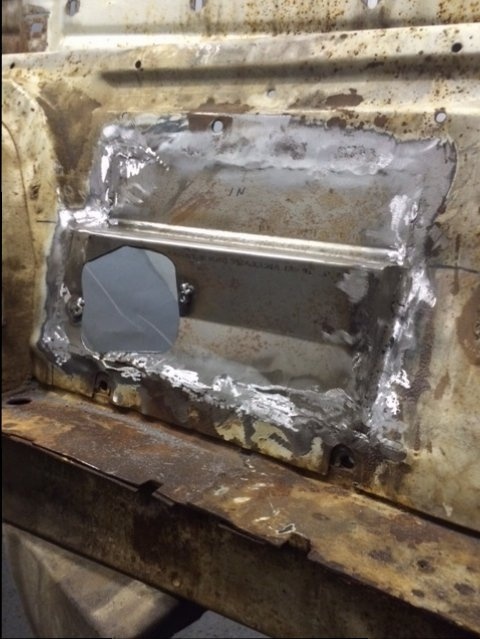

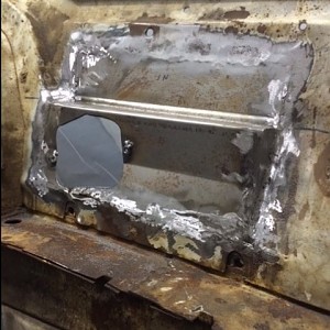

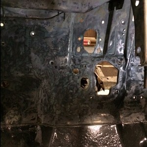

I had rot in the battery box area so I cut that out and formed sheet metal to replace the bad areas. Welded in and ground all that area up. I welded the pads in the floorboards for replacing by bench with bucket seats as I knew I will be going there (factory doesn't add reinforcement unless ordered with buckets).

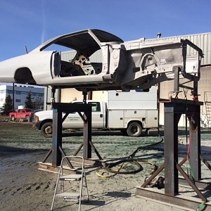

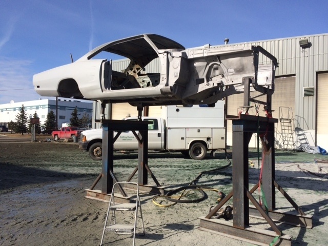

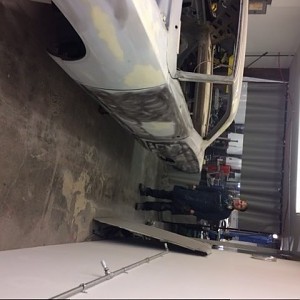

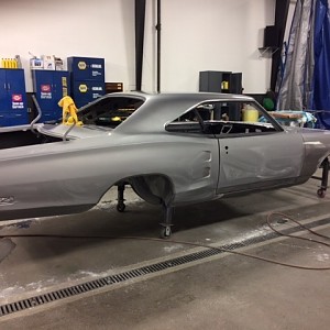

After a week of trying to do spot sand blasting with a pot I borrowed, I quickly realized this was NOT the way to do this. I had gone through about 100 lbs of sand and 7 hours of my time under a very hot mask and set of coveralls. I spent 4 hours trying to clean up that sand scattered all over my driveway and had very little accomplished. At this point I made a decision, get a professional to do this! Smartest thing I have done in a while with fantastic results...letting someone who knows what they are doing and has the right equipment. A friend had a huge beam framework at his business plus the loader to pick the car up. We set her out in the back lot and called a portable media blaster who did it all in one day.

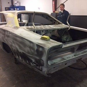

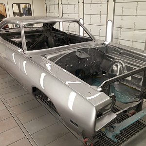

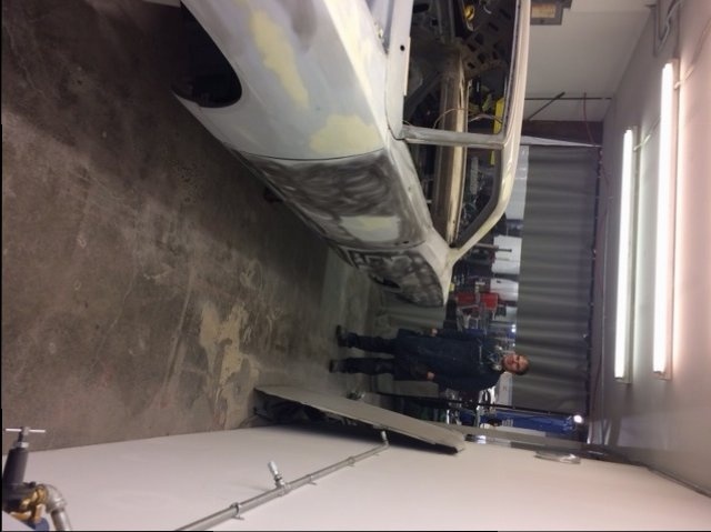

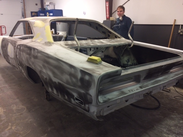

November 2016..Well she is finally getting professional help! Two great guys are rubbing and polishing all over my baby and getting ready to change her color. I never knew there was sooo much prepping to make a girl pretty. can't wait to see her new shade and will be sure to share it with my garage, I am told she will be done by Thanksgiving!
