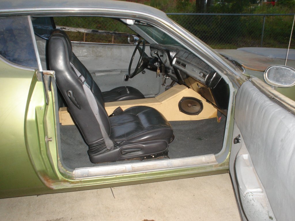

The seats are out of a 99 Sebring. In order to get them to fit I had to weld in the rear mount closest to the door that I cut out from the donor car and I had to build a couple of 2 inch blocks for the other rear mount. The front mount closest to the door is a factory hole and then drilled a hole for the mount next to the trans tunnel.
