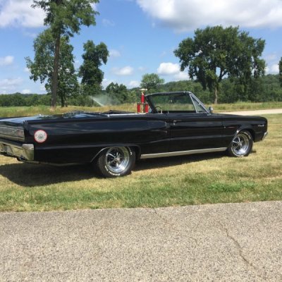

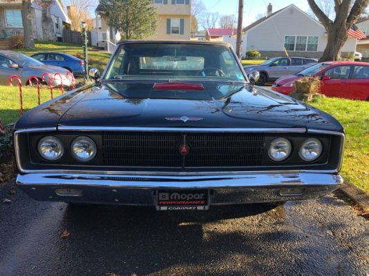

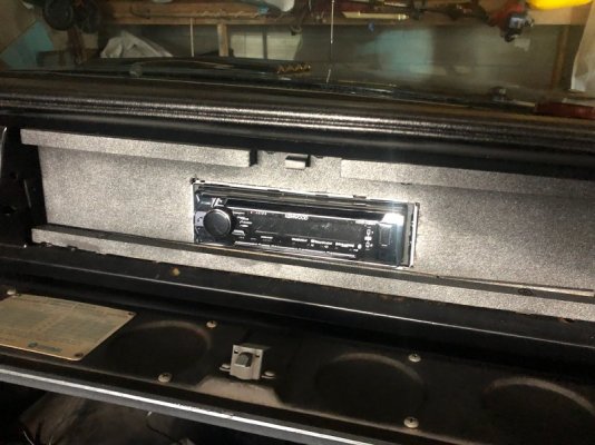

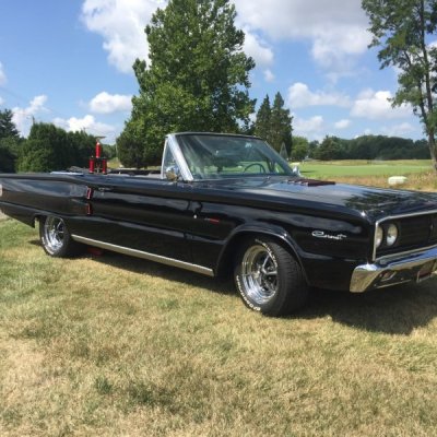

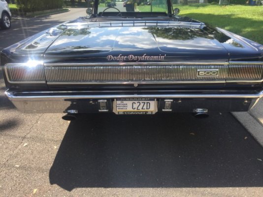

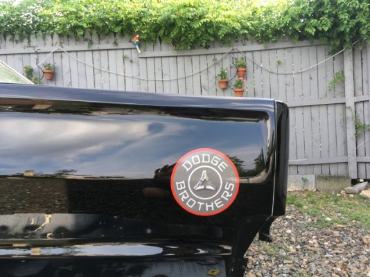

This is my 67 Coronet Convertible. It has bits and pieces from different mopars. 1969 Coronet Super Bee side scoops, fiberglass work done to fit different shape of quarter. 1970 Cuda' Fish Gill rocker mouldings. Since the Cuda has shorter area between wheels, I grafted 2 pair into one, since the Cuda' has taller rockers, I had to slice the moulding length wise along the bottom, hand sanded the 90 or so bevels to match. We closed off the gas fill on the left quarter, put in a 70 Charger flip top, did trunk plumbing to make it work. We put in the bucket seat front and rear, with full length console from a 66 Charger. Finished off the panel behind the seats with speakers and custom made Dodge Brothers emblem, complete with Fratzog. Also have the same emblem on the back quarters as a 'nod' to a 69 Super Bee. The emblem company made small versions which adorn the spinner wheel caps. The hood has a 67 R/T hood scoop, painted Gunmetal grey, with red inserts. In lieu of Dodge lettering on the front of the hood, I have an emblem from a mid 30's Dodge Brothers trunk, re-chromed and hand painted, with the Dodge Brothers emblem revisited. Stealth stereo in glove box, stealth sub under passenger seat, amp somewhere under the dash. The trunk has Dodge Daydreamin' emblem over the finish panel, 69 Road Runner oval exhaust tips. Stock 440, with 4 speed OD trans, TTI jet coated headers, full TTI system with X pipe
