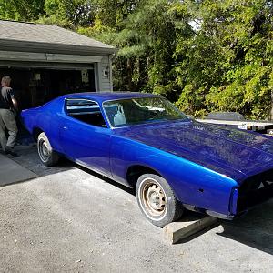

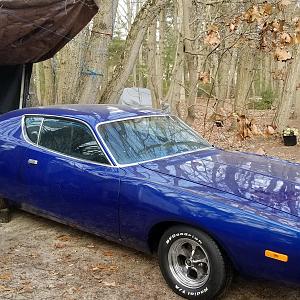

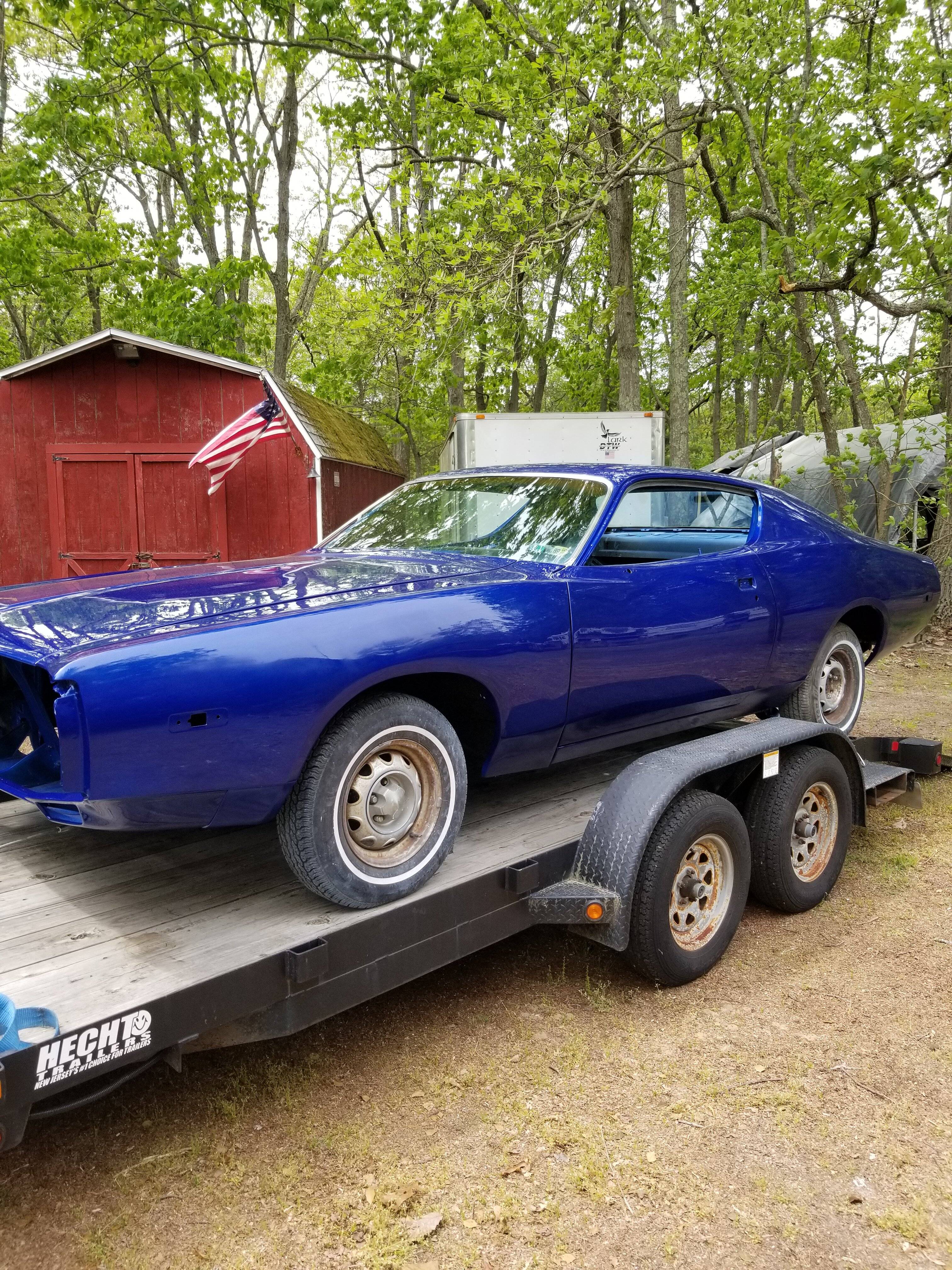

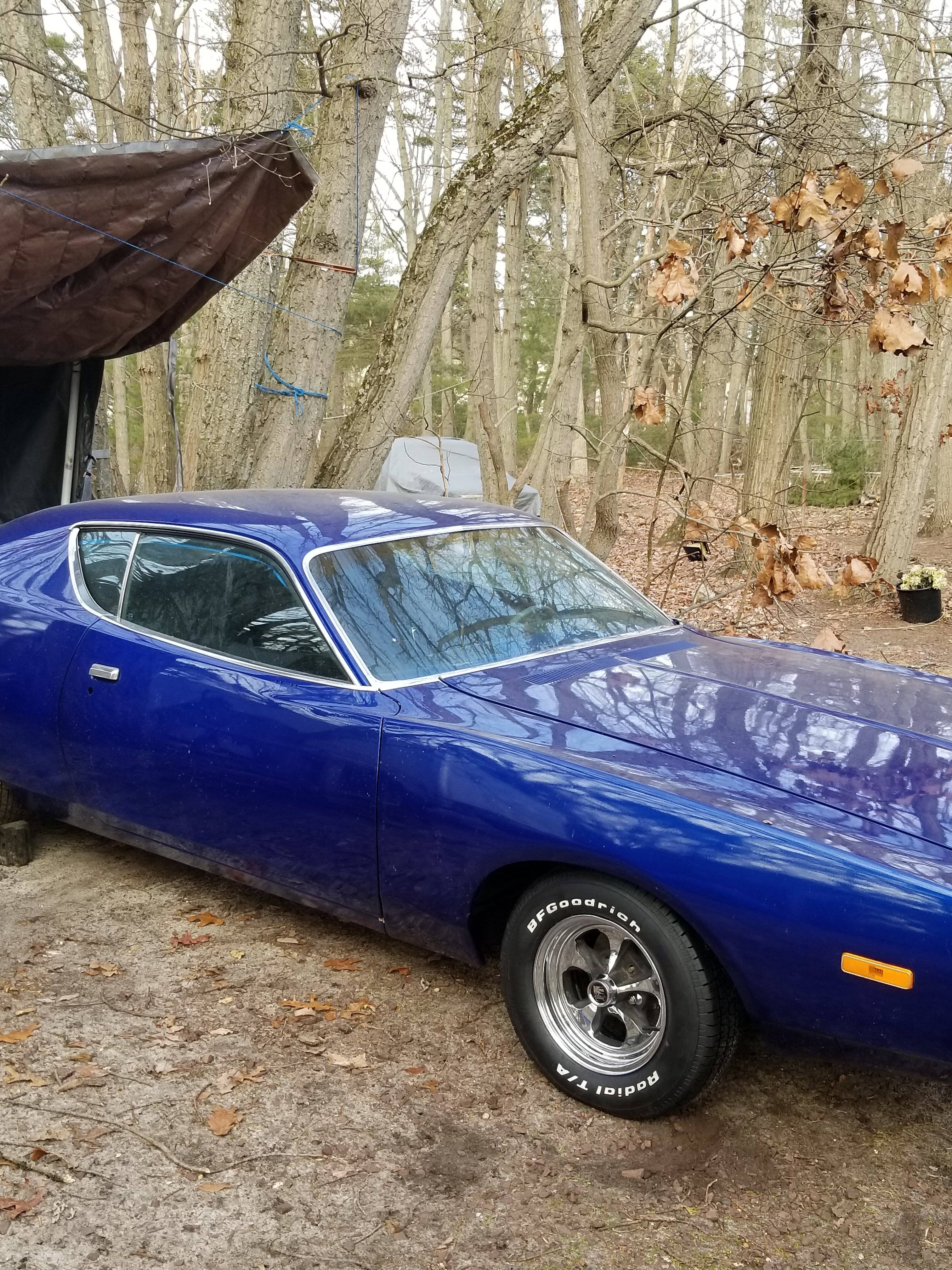

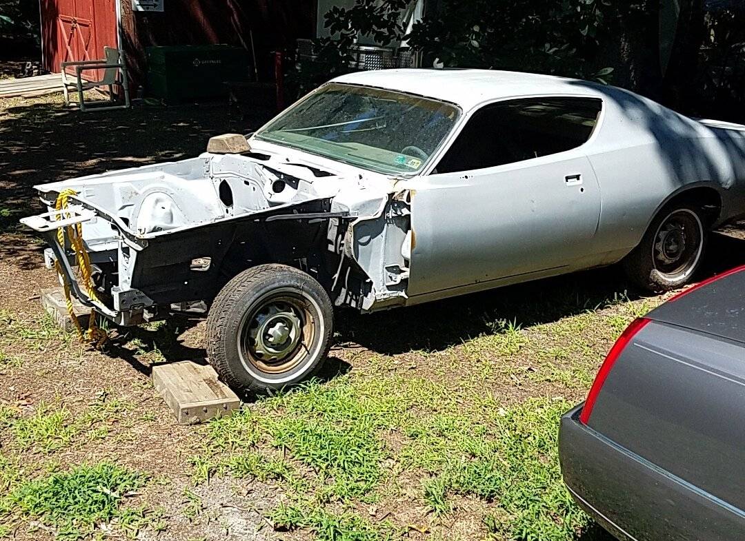

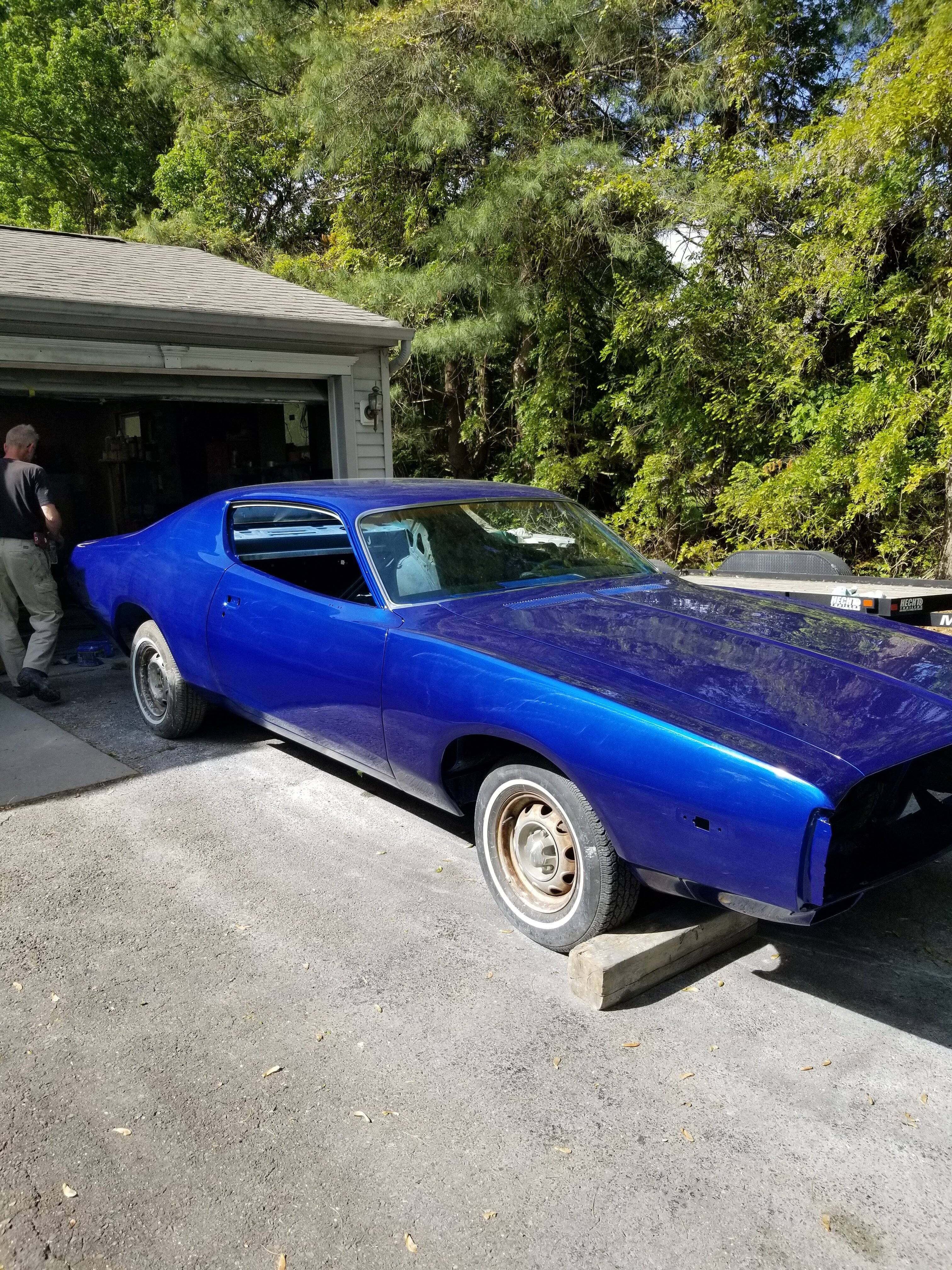

1972 Charger, 12 yrs+ in progress, still mine after divorce.
About this Mopar:

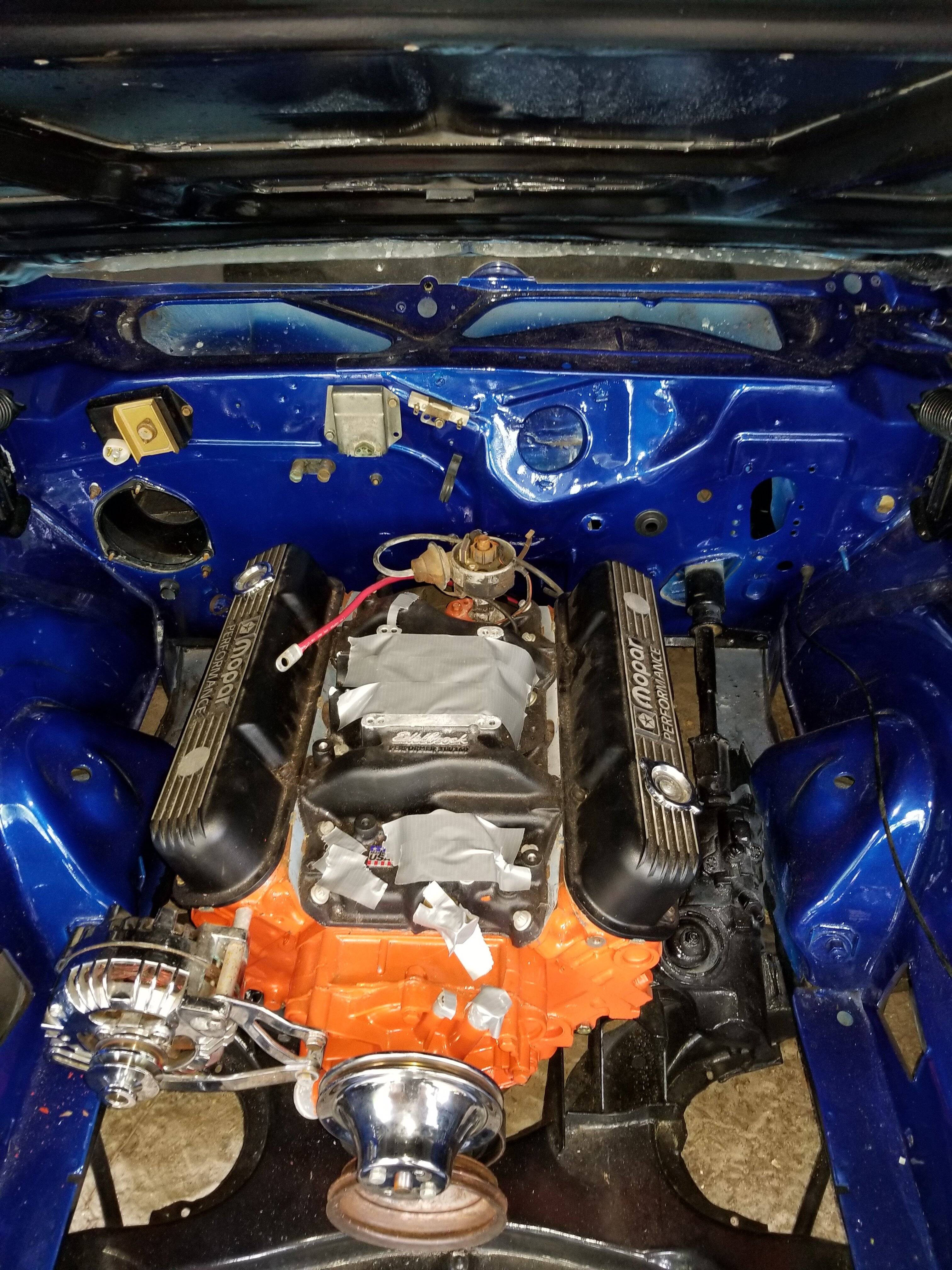

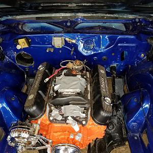

360 from a 75 C-class Dodge motorhome, .030 over, SRP flat top pistons, X-heads, 61cc chambers, Voodoo cam, roller hyd lifters, roller rockers, Performer intake; A904 with lock-up tc from Aspen/Volare, still original 8 1/4 rear for now, Indigo/Ocean Blue Omni PPG paint, Keystone Classic wheels (dated 1988)
