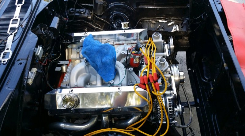

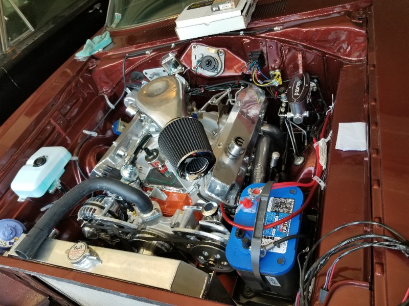

She has a Classic Auto Air A/C system now and a new SST Tremec TKX 5 Speed Pistol Grip Twin Disc Clutch .68OD Kit waiting to be installed in a few weeks.. So excited, no more big cam 727TF 3k stall street brawler heating issues.. She'll see mostly cruising and some highway miles, so I may keep the 3.23 gears but yet to be determined.

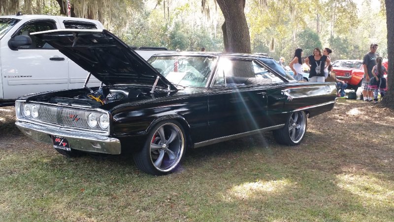

what size rims are you running on that nice car you built ?
iam doing a 70 charger resto mod and need to get the rims and tires next . what off set are they ? do you do a wheel tube or is that stock wheel well ?
and are they the same size all the way around?
thank you
thank you

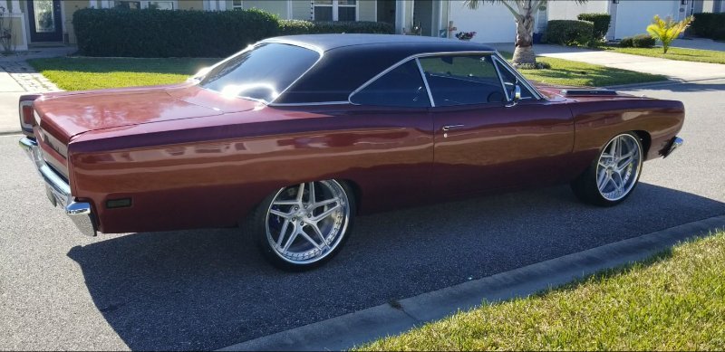

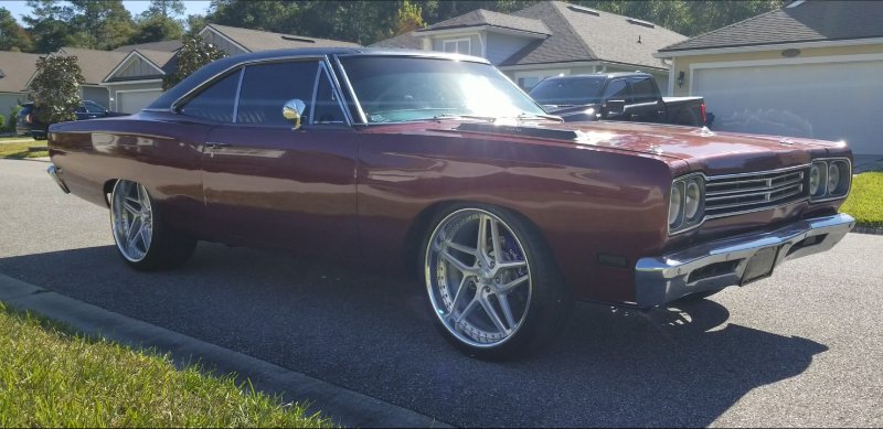

Thank you, They're 21's. The front are 21x9, 5.5 Back space rears are 21x11, 6.5 back space and yes you'll need to tub the outer upper wheel tub because the factory one slopes down and will rub. The height of the rears are 28.4 and I actually could have gone out a 1/2 inch more for more lip but chose not too..
