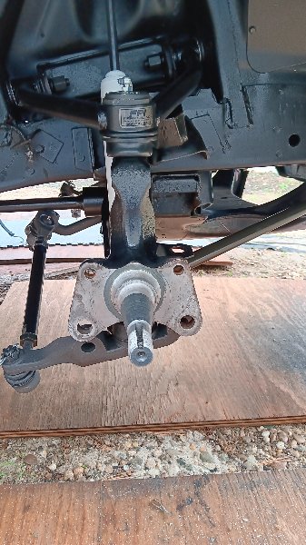

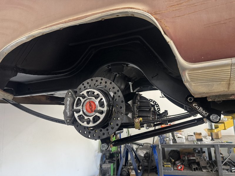

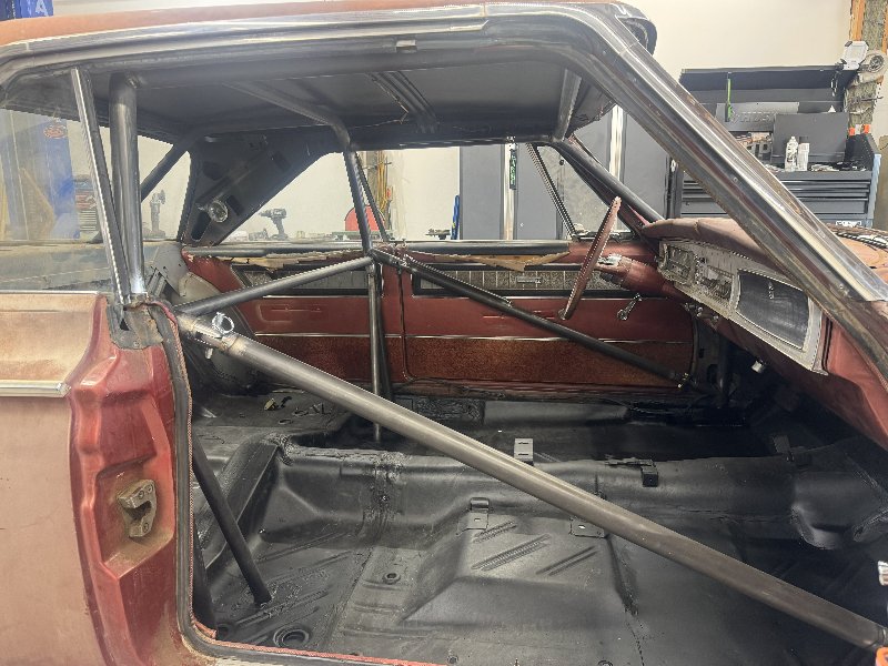

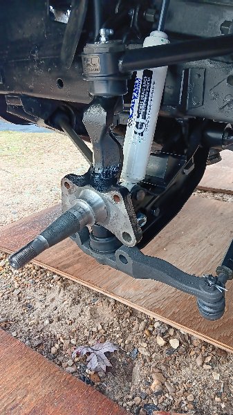

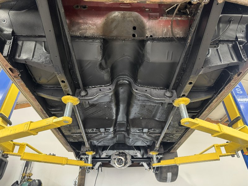

Thanks for the positive comments. The Coronet was in really good shape inside and out. We had it dry ice blasted to clean it up. Installed a new custom Dutchman 9" Ford rear-end along with Caltracs suspension and Wilwood brakes. The front suspension, is all new Firm Feel parts along with Calvert shocks. K member is original along with the front spindles. Front brakes are Wilwood 12". Custom made chrome moly rollcage is installed. The motor is a 400 B block stroked to 499, work in progress.
