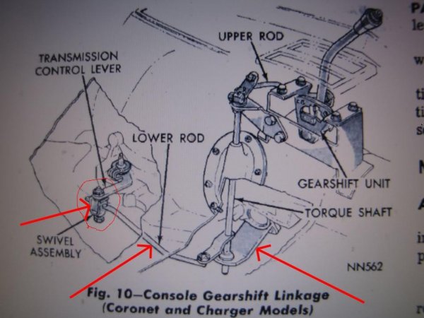

swivel linkage
About this Mopar:
The swivel linkage is on the bottom left corner.This one is for a floor shifter it's different from the column shift but they look identical ,the difference is the direction of the the clamp it's made to fit the flat side of the linkage rod and the two swivels are made in different directions
