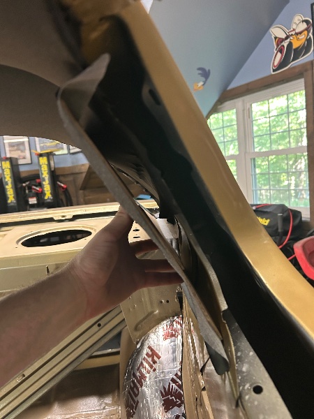

Chad, see my page on when I did the install - I did post some pics.
My 1971 Road runner
I think that's the reason for the 2 clips on the inside of the panel and it's why I used Velcro on the backside - to hold that contour.
Thank you! I was using your images as reference. I was thinking the clips or Velcro wouldn't be strong enough to pull the panels in to the contour. I'll give it a try.

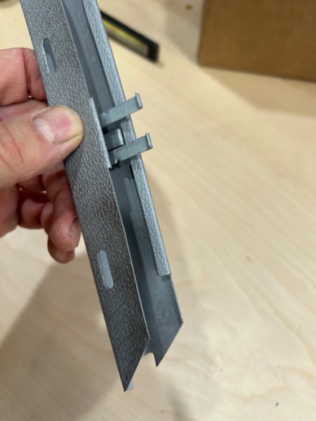

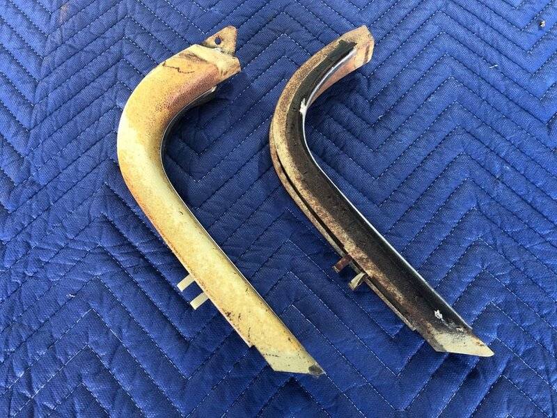

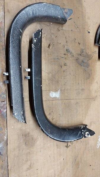

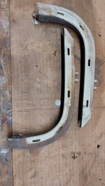

@71Beeper Aren’t the moldings designed to bite/catch the cardboard?
Doesn’t the cardboard get inserted or catched somehow INTO the molding ? Some kind of groove or channel?
That’s what I think. Sorry, I never have had those molds in hands… yet. And I hope won’t be needing them (meaning my sail panels are still in one piece)
There’s nothing I can see that actually clips to the sail panel. I agree with 71Beeper (John), the clip that holds the molding to the window opening (and the screw at the bottom) press the sail panel and hold it against the quarter panel. I think the back window molding also helps to hold the other end down.

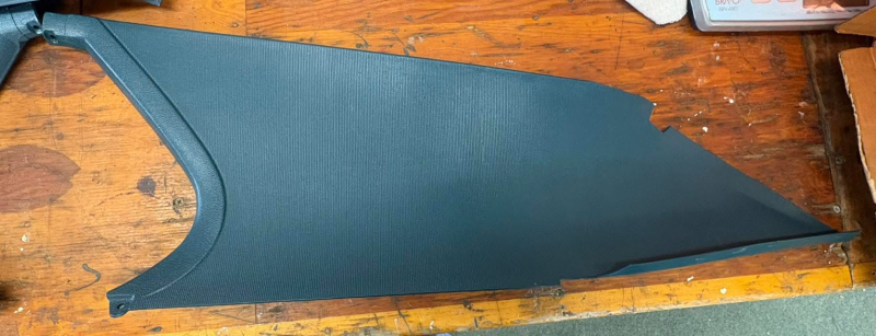

I recently stripped and painted mine:
Those look great What did you use to strip them? I need to do a set in the near future.
