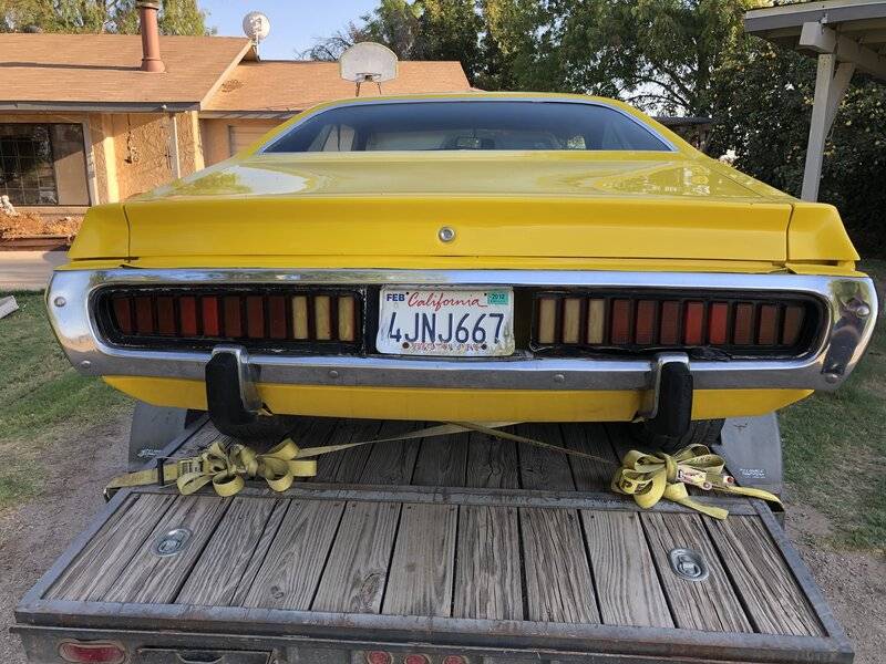

Hi all, I’m sure this isn’t a new topic but since the tail light housings for the 73 Charger are near impossible to find, has anyone seen a how to article on repairs to the plastic housing with chunks of it missing? Would milling ABS plastic to shape and Epoxy/welding it in place work? Thanks in advance.
