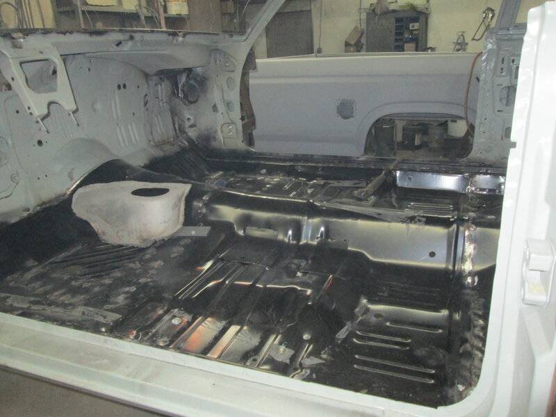

Yes , I did a full front floor on a 70 Roadrunner Post , no doors on and it just fits thru the door opening on the angle ,
tight but no worries )
I replaced a one piece in a 68 Superbee. Went in diagionally top to bottom and took a couple of rachet straps to deflect from staight to slightly bowed. That bow gives you enough clearance. One in the car release and it springs right back.
Ratcheting straps great idea i did my kids 68 valiant trough the bottom removed the seat bracket, bench seat and my wife and i kinda muscled it in/ maneuvered. But the straps would have been better idea hearing less bullshit from her.

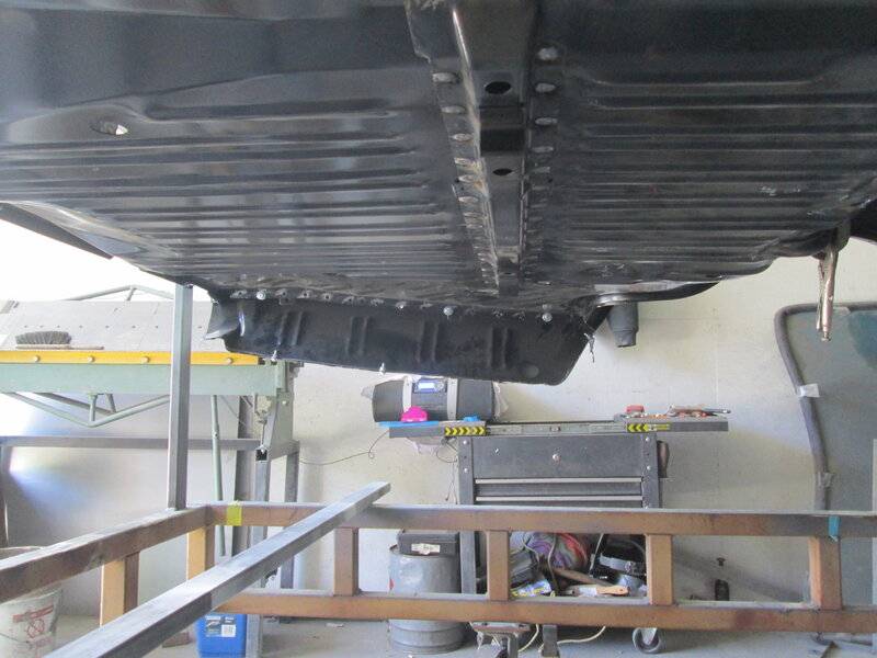

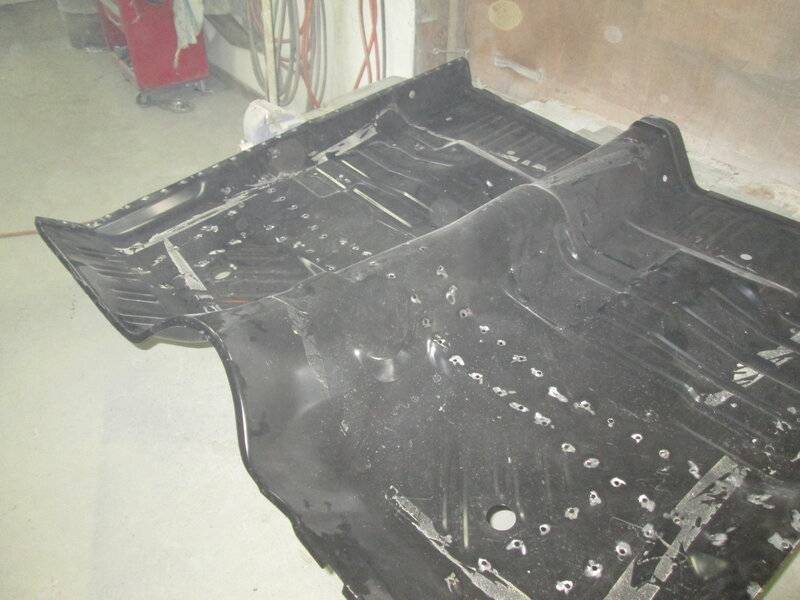

I was thinking trunk pan... but interior floor pan as noted just diagonal through the door opening or through windshield frame sideway and then turn 90*.
