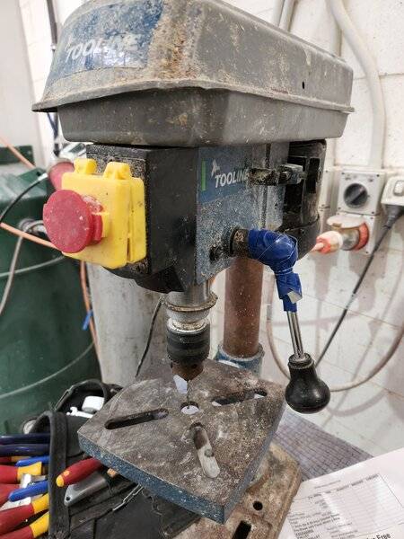

Probably not this one.....
That blue duct tape is doing the job a solid steel pin is supposed to do....belts slip, pulley bent, chuck won't tighten, stop switch not stopping.....motor adjustment is jammed up.... Made in China. :rolleyes:
They asked if I could fix it.....I said I saw a big bin outside that is looking for a friend. :D

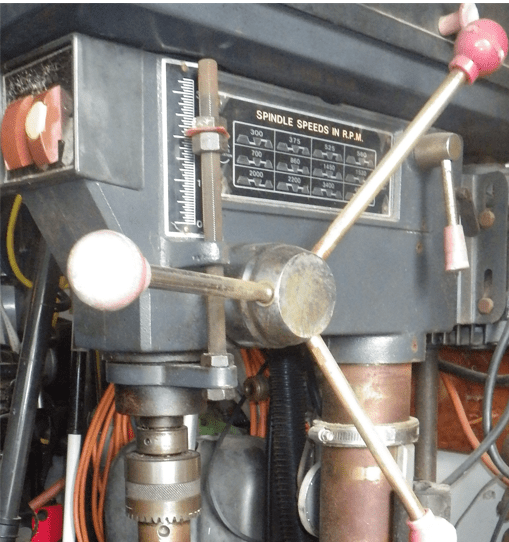

I went through four drill presses before I finally settled on a good used Craftsman 20" floor model. Its not "dead accurate" but it has the quill adjustment and I swapped the chuck for a "keyless" chuck, for no other reason than the standard one was too big and bulky.
Ok, so that's way bigger than you want but carefully consider what you going to do with it and how often you'll use it. Floor models offer the option of moving the thing around to accommodate working on larger pieces.

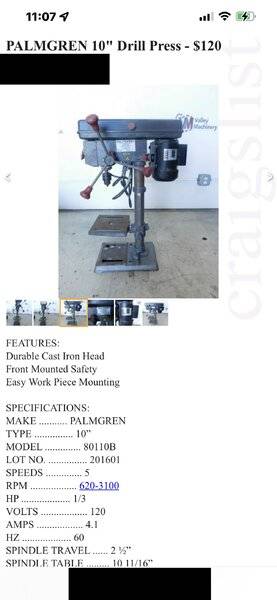

There’s some nice used ones for under $7,000
Shop around, you can find them for 2k...sometimes less.
The old ones with the "round rams" aren't legal to run in industry, for a safety reason, not really much of a concern. I've seen them for $600. They don't move around though and may be over-kill if you just want to drill a hole occasionally.

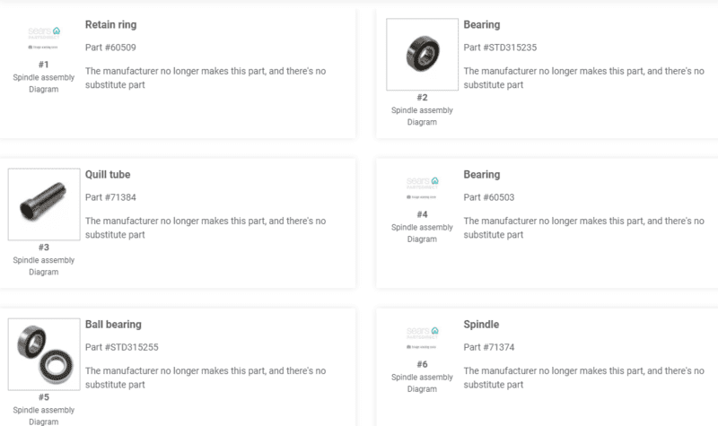

FWIW, I bought a slightly damaged Craftsman 15" from Sears Surplus back around '86.
Model #113213853
For grins this AM, I checked Sears Direct for replacement parts and was not surprised to find "zilch" available. They don't even source a bolt or bearing these days.
This is not to say parts aren't available elsewhere. Like a car, learn all you can about what you're considering for purchase used.
At least they still maintain the data that has part numbers which may cross-reference.
I'd DL the manual if available and if it has part numbers.
In case that site goes belly up.
IIRC the last Sears still in operation near Chicago closed a couple of months ago.
