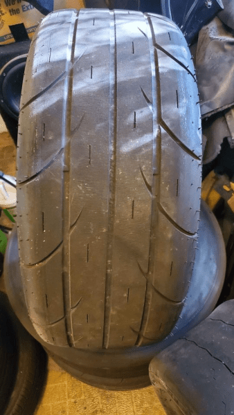

What they look like.
I was going to put the drag radials on different wheels just for the track. Didnt want new for aging reason. They will sit on the shelf all but one or two weekends a year. A waste. But, maybe I can run some Nitto NT 555 RII, or M/T ET Street S/S on the rear all the time. How do they do on the track?
If they have been stored inside, climate controlled even better, and away from the sun those tires will be fine for a fun weekend.
It's all in where and how they are stored.
