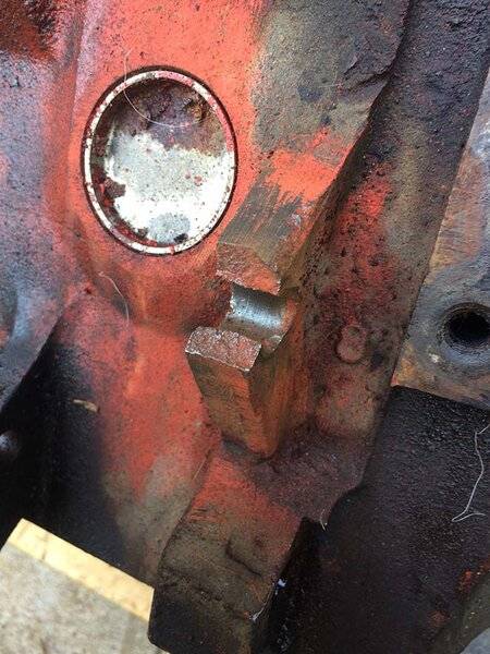

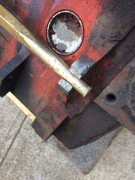

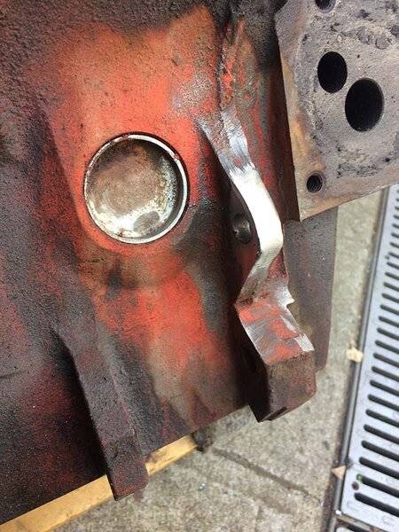

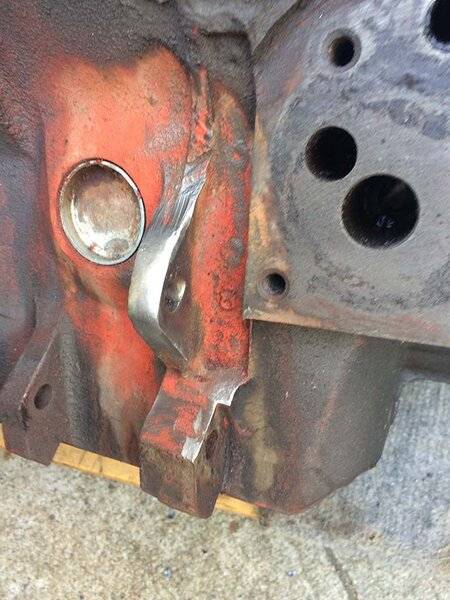

Picked up a standard bore 69 440 for $100. It had a broken motor mount ear. Did a fix with nickel rods. Looks like it will work.

Thanks Guys! I used Certanium 889 SP rods, a nickel alloy. They flowed like butter and said that no pre heat necessary. I warmed it up anyway.
Good call. I would've heated the surrounding area like you did regardless, but I'm no expert..
Did you peen the repair afterwards?
Nice! I have a standard bore, 68, 440 block that needs that same fix.
Just a light peen. I figured it would be for a resto type build not a race motor.
