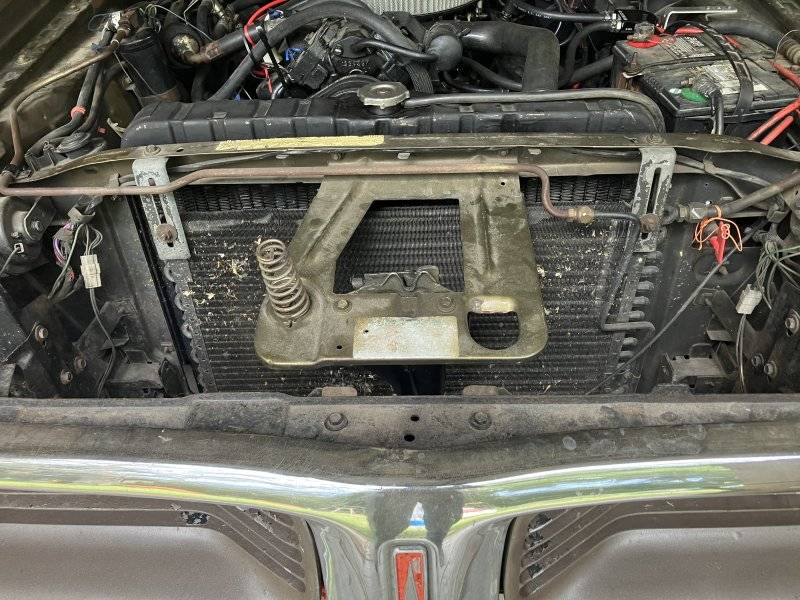

I’ve got a 72 charger that needs the AC put back in service after new engine install. We were told when we bought the car it had been converted to 134a. When asking around for a shop to get it up and going I was told it would need a large condenser to work with the 134. Is there a certain ”size” or other way to tell if the condenser has been upgraded? Thanks

The easy way to tell is to look for the “low side” fitting where you put in freon. If the fitting fits the 134a filler hose, it has been converted. If the 134a hose does not fit the fitting, it’s still R-12

I've done a number of conversions over the years. From simple fitting change, to complete system overhaul. All worked fine. You don't need a different condensor.

TRUE....you don't NEED a new condenser.....but if one is available, leak free, and matches the fittings and layout, as I noted, a larger condenser will lower discharge pressure as the refrigerant will be condensed at a lower temperature, due to more surface area and subsequently lower pressure. The condenser will hold approximately 1/3 to 1/4 of the total refrigerant oil in the system and should be flushed, if using the original condenser, b4 switching to R134A as the oil is different. Also, change the receiver/dryer as the dessicant will be saturated with oil and moisture. R134A has different operating parameters and hence, different cooling capabilities, compared to R12.....just thought you might like to know....
