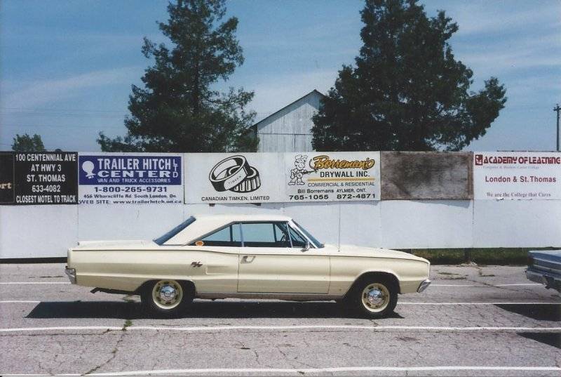

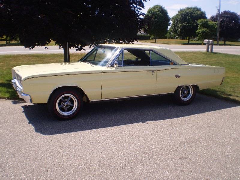

My 1967 R/T.

If they are actual Cop car rims then they will have the center register for a 9" dog dish cap, the 10" caps were 67 and earlier.
The slotted cop car rims are 15" X 7" and take smaller 9" cap. My R/T when I had these on it, with '69 Red Circle caps. (likely the most expensive dog dishes to buy)
