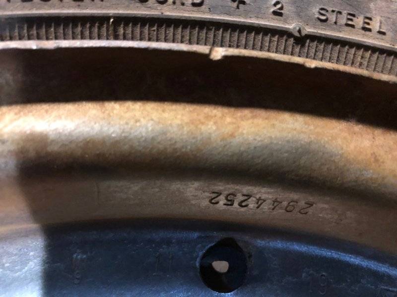

the 235/60-14's that were on it were much too narrow for the rim. The last pic shows it on the car with the 235's. I checked the part number on the rim , but that is for a 14x5.5 rim....these are a lot wider than 5.5
Those have definitely been "re-hooped".
...and they look wider than 8" unless there's virtually no back spacing.
Deep dish.
I bet a 245 would be decent.
Back spacing is 4" and it is 5.5" from center to front (front spacing ?). Yeah they are pretty wide. Did you notice how narrow they were when still installed with 235's ? The tread ended about 1.5 inches inside the edge of the rim.
As far as re-hooped, there is a strip about 3.5 inches wide on the inside. Custy custom.
