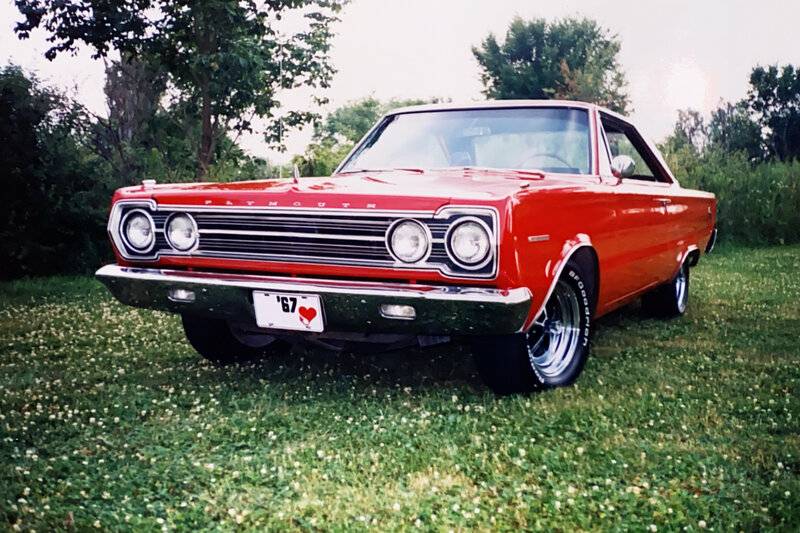

I ran 235/60-15 BFG's on 15 x 7 Magnum 500s front and rear on my 1967 Belvedere II.
Handling was great--no rubbing--acceptable steering effort with manual steering box ;-)
235's are about as big as you can run in the back of '66-'67 b-body because of tight wheel well.

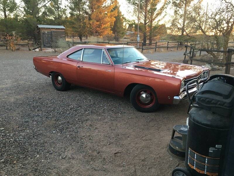

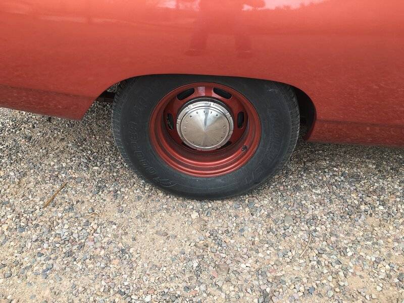

I agree I have read people have went with a wider tire but I didn't want to chance it. I do like the look of the 235's up front as well as others have posted, they seem to give a beefier look than the 215's up front .
Thats not true. I run a 275/60/15 drag radial on my 67 coronet. 15x8 wheel 4 3/4 inch backspace.

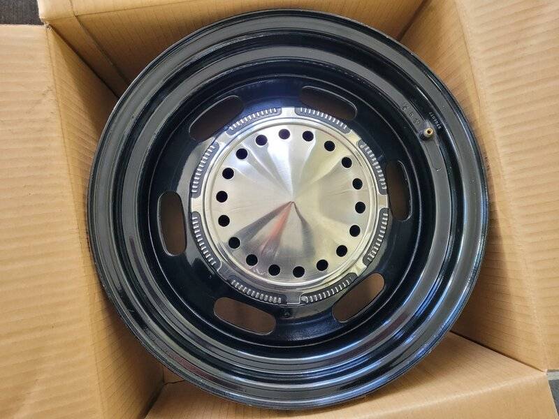

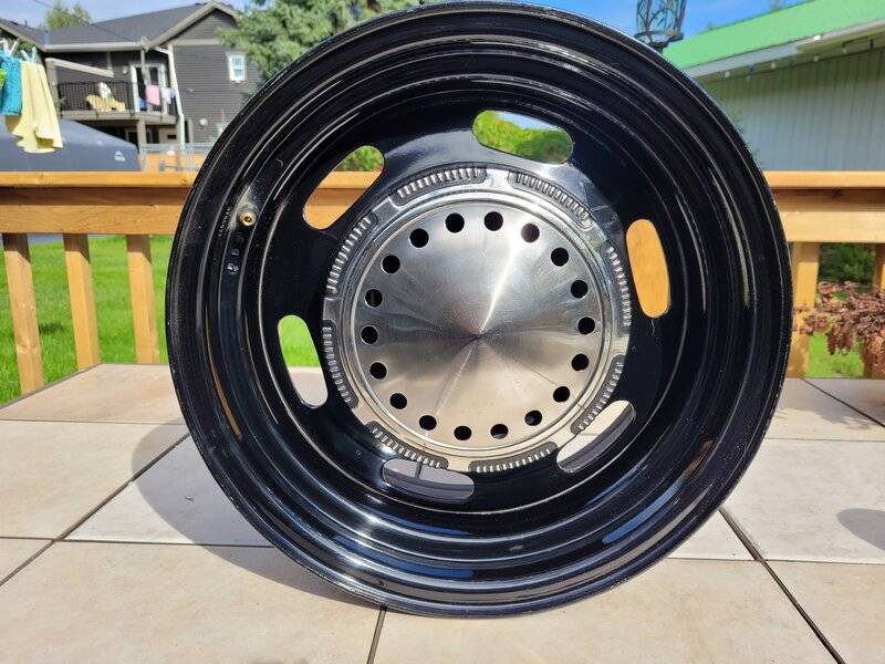

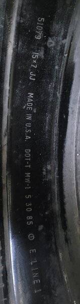

Rims and tires arrived thought I would post a pic of one of the rims, they are all identical but if anyone know the history on these and maybe what they came off of that would be awesome. I think they are going to look great on my Coronet...
Thanks!

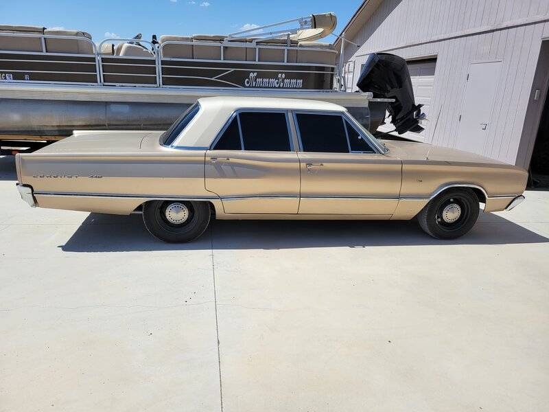

235's on my '67. Front n rear. Love the look n they handle great. 15x7's.
