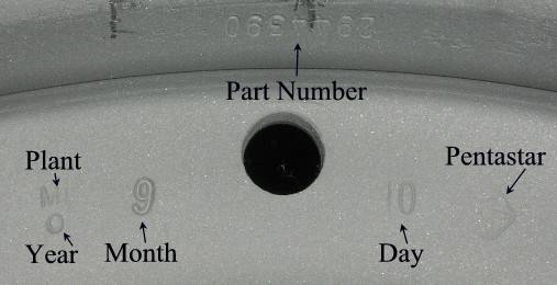

I found a pair of 15" mopar rallye wheels (that I did not know that I had). What width did these wheels come in ? , Also are the wheels stamped with the width? where would the stamp be ?? Thanks
There’s usually a part number stamped near the valve stem. The size is also usually stamped inside the rim (hidden when the tire is mounted).
If I recall correctly, 15 inch Rallyes were either 7” inches wide or 6.5” wide.
If I recall correctly, 15 inch Rallyes were either 7” inches wide or 6.5” wide. View attachment 1279604
Thank you for this information. I knew that something was stamped on the wheel, and knowing 6.5-7.0 also helps :)
