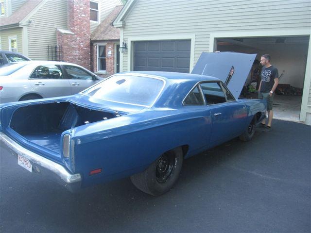

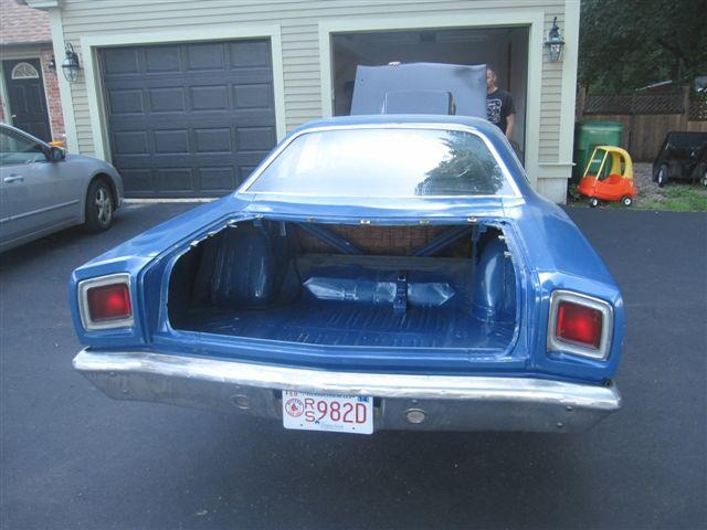

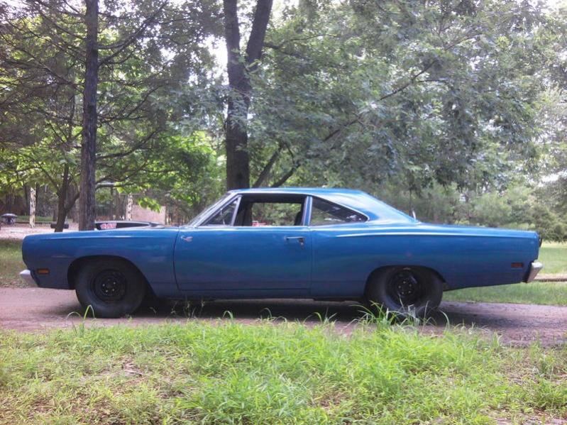

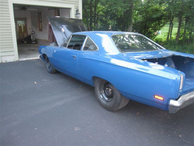

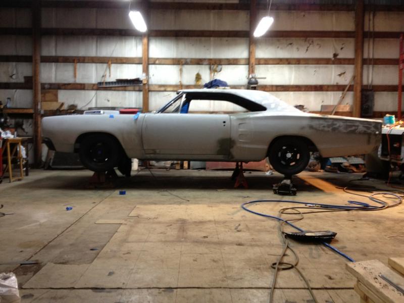

Here's some pix of mine when it had 12.5x29 sportsmans:

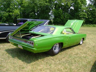

Here's the look I'm going for. I don't like the tilt deck lid but that's just me. Nice car though

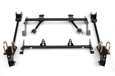

Or Ride-tech bolt-in 4 link & either coil-overs or airbag shocks

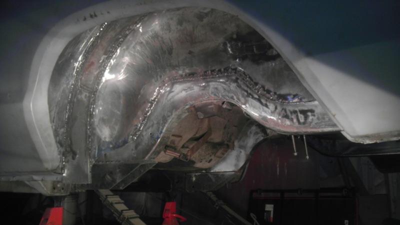

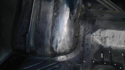

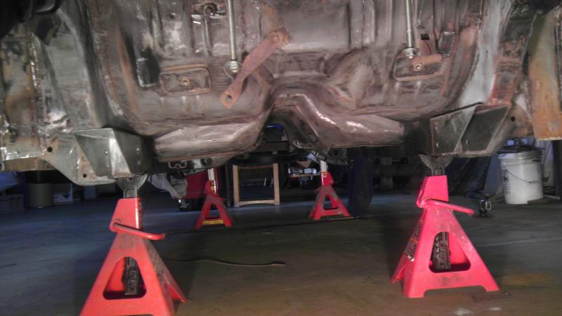

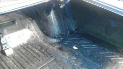

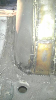

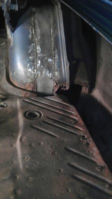

Hey I think I can help. I have a 68 Coronet I am building and I did the mopar spring inboard kit, 440/Hemi leaf springs, 3.5" mini tub to the frame rails, and stock axle width. 8-3/4" 3.91 Posi. The inside fender to frame rail is 16". I plan to run M/H radial PN:ROD-07 on a 15x12 widened steel cop wheel. When choosing a wheel width first look at the tires section width then the suggested wheel width. I don't think you will fit a 15"x15" with a mini tub like mine. The wheel well narrows toward the top. Let me know if you have questions or want some more pics.
These are the tires I think I can fit in my car: M&H#676-ROD-07R M&H Drag Radial Tire 390/45R15, 672-6642
Sportsman S/R Radial 29'' x 15''R x 15''LT,522-19200PS Pro Street RadialTire Size: 29x15.50R-15LT
