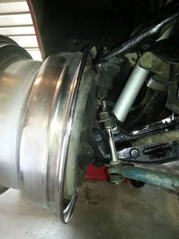

a 17x9 rim with 0 offset(5" backspace) on a 275/40 tire clears no problem, still have a 3/8" gap before you hit the outter tie rod

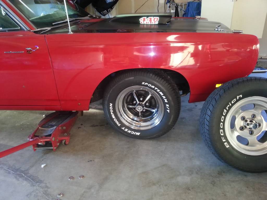

Well mines a 69 but you decide - my 15x8 mag 500's and 245 60 15's fit well .
Before disk brake install
Thanks for the pics! Just what I needed. The mags are the same rims I'm using. The vendor has already sent the 8's for the rear but I've been waiting 3 months for the 6's for the front. Now they tell me that the manufacturer is having problems getting centers and there is no eta on them! Do you have drums on the front? If so, how did you get the rim center cap on over the bearing grease cap? Very nice ride you have by the way!
If they have the 15x8's tell them to change the order you will be safe. the wheels fit over the dust cap just fine it's larger than it looks. you will be fine. I went with the 8" all around just in case I wanted to get bigger tires one day. look around at other places for center caps I got all of my stuff at Summit racing
