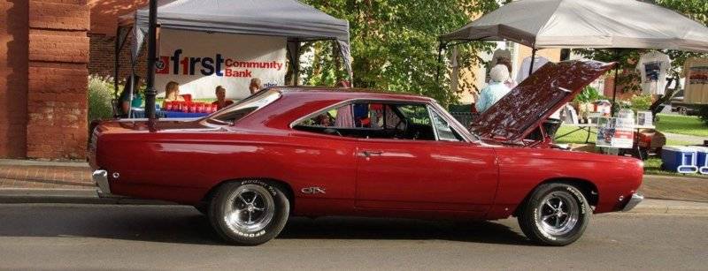

Well of COURSE there's still choices in 15" rims! Folks are running 295 width and such on the rears of them without
suspension modifications, after all. I have 275's on mine and they look like they came on the thing.
These old rascals look their best with some sidewall to 'em. Ricer wheels/tires belong on...well, ricers IMO.
These aren't Hot Wheels or model cars, after all. :)

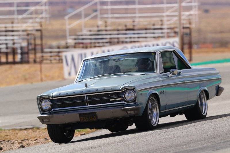

To each their own, your car looks great and I do love the 15" look as well but I sure like a firm feel in the corners. Just to clear up the "ricer wheel/tire" comment, I'm pretty sure if you look around at ALL the newer cars they ALL run a very significantly shorter sidewall even trucks and for good reason... they handle better!
I'd hardly say my car is a "ricer"... I raced on the 15" wheels, and now with 18" wheels. I've upgraded brakes and suspension, and I run the track 11 seconds faster now.
Big difference. When I first went to 18" wheels, I wasn't sure I'd like it. Now I think they're right at home on the car.

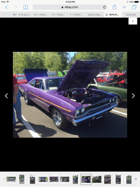

I want to get the stock look for my 70 Roadrunner by adding a set of Magnum 500s and New tires. Any suggestions on tire and rim size ? I was leaning towards 15 inch rims but could appreciate some suggestions
Here is a couple shots of my car. It currently has American Racing wheels 15 inch 70s on the front and 60s on the back . Not a fan of the current tire/rim combo that's why I am asking for some input on hanging back to a stock look
View attachment 688377 View attachment 688378
For a 15" wheel probably not a lot more than 200-225 for stock. You can do 235 without worry in the front (possibly a lil more), 60/15 front and rear.
I'm current running 235/60/15 - front & 255/60/15 - rear.

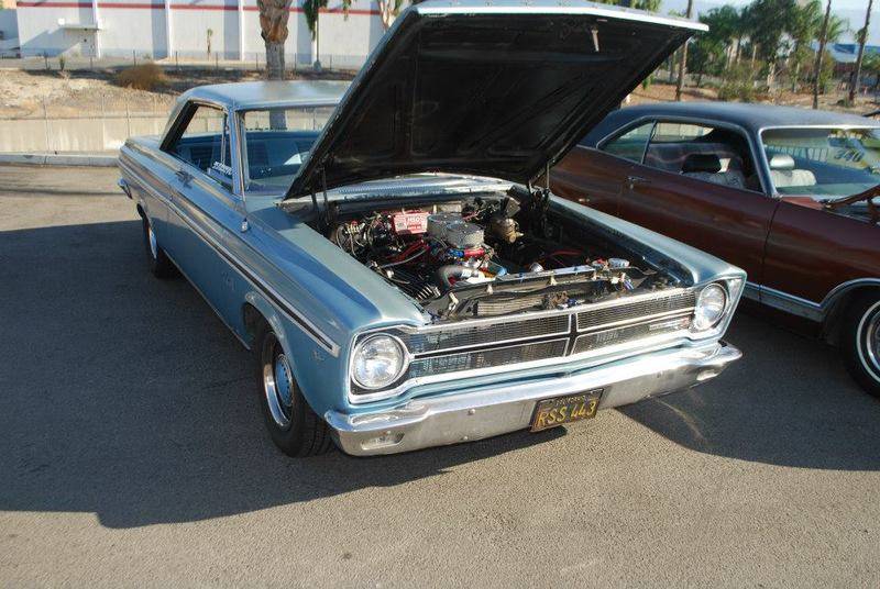

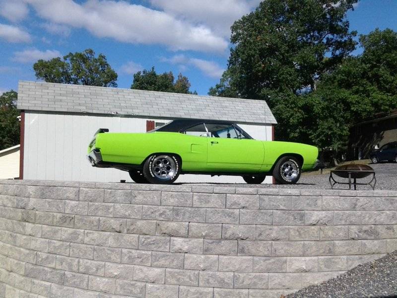

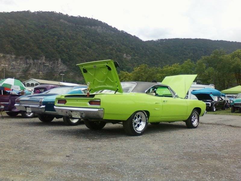

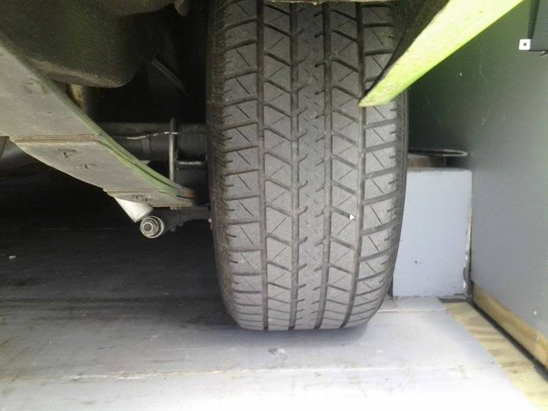

On my 70 Satellite I wanted more of a "Hot Wheels" look with a bigger rear tire and rim with a smaller front tire and rim...
Fronts are a standard 15x7 with 225/70's...
The rears are 17x 9.5 with 5.5 backspace...My SS springs and are moved back 3/4" at the spring mount in the front. The rear tires are 275/60's measuring 30" tall...
The section width is about 11 1/2" and the tread is about 9 1/2"...You can't put anything any bigger under this without working on the inner and outer wheel-houses...
As far as the speedometer my trans had a speedometer gear in it for a 2.94 rear gear...
These tires are roughly 4" larger in diameter than a 26" "stock" tire.
I added 3.23 gears when I built the car...
1" of tire is supposedly about 6 points of gear...All things equal I have a 3.23 - .24 for 6 points of gear for every inch larger than 26" with turns out to be a 2.99 final ratio. With the speedometer gear for a 2.94 my car runs within about 1 mph of being correct at about 60 mph.
You can change tire size...gear ratio and the speedometer gear in the transmission to do whatever you need it to do...
