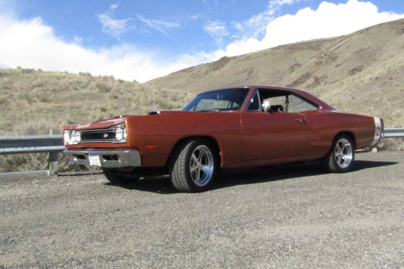

0 offset , 4.5 to 5.5 in. back side , these are 17x9 all four.

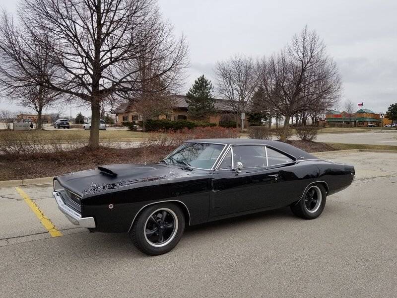

Normal backspace. Riddler rims.
These are normally on my fury work 28.75" tall tires front and back, they are a touch big on a B

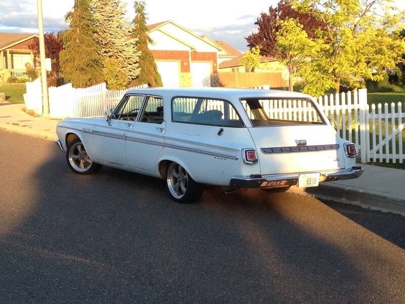

Here's mine:
When this photo was taken I was running the stock drums on all four corners. Since then I have converted to disc brakes all around and put on new tires with a little taller side wall.
