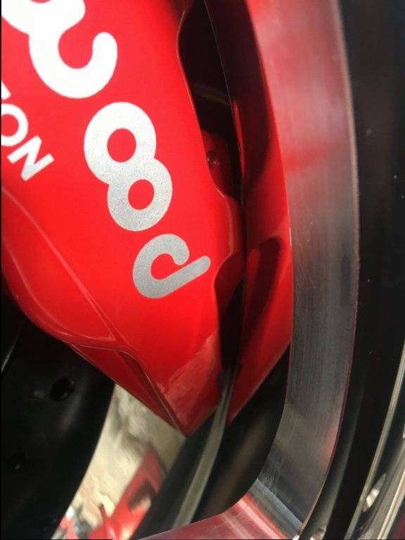

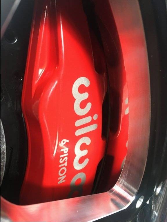

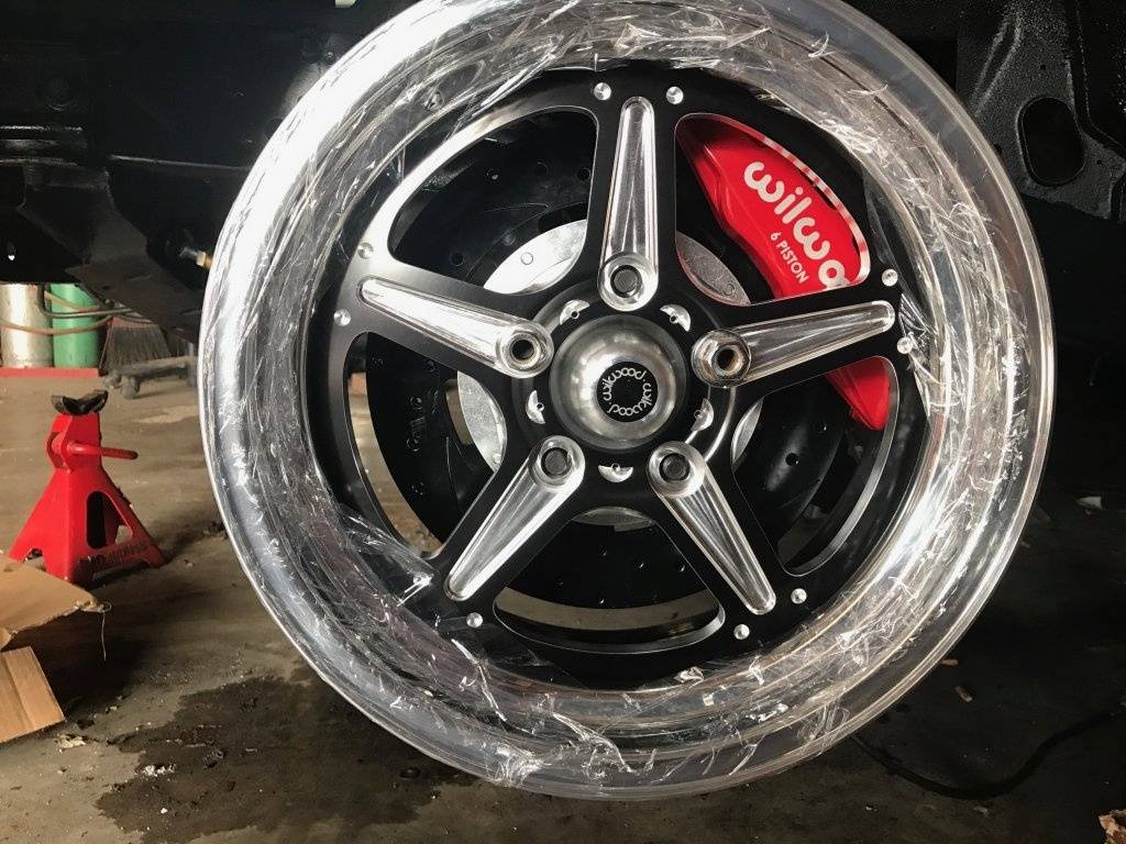

In the front I have wilwood p/n 140-10740 12.19" rotor with 6 piston caliper rear is same rotor with 4 piston caliper. Requires 7.15" of clearance. im wondering if I use a .5" spacer in the front if it would work. I only need a c**t hair to clear the caliper
In those photos im literally .25"or less from being mounted flush on the hub surface
I see you went with the bigger kit. I 'm running the smaller 4 piston calipers. Your looks real nice though....

Anyone against running a spacer I the front? I have 3" chromoly wheel studs. Really trying to exhaust all options to use a 15
Depends on the rims, some rims center themselves on the studs alone which would be fine, others rely on the center hub.
I'm not a fan of spacers but as long as they're not overly thick I think you'd be alright.
