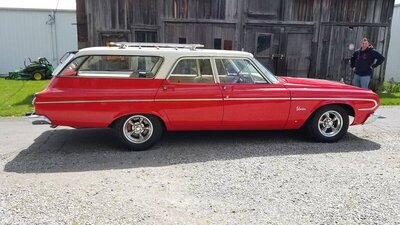

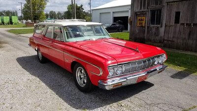

Is anyone running 18/20 combo? I would love to see some pics. I am debating on 18s all around or 18/20 on my '64 Belvedere wagon. Wheels are so hard to choose!
Looks good, how is the ride?
The ride is good thanks. It's got a 4-link in the rear that also helps. I need to upgrade the Torsion Bars though, as they are the original 50 year old set, back when it was a 318 car.

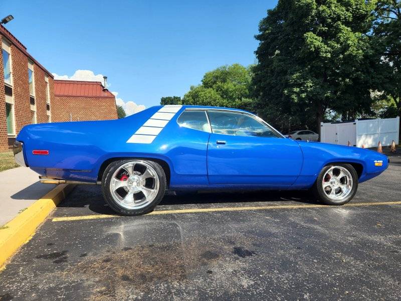

These are 18" and 20" on a 73. The wheel opening are different than on your wagon, make sure you have the room. The rear tires I went with are 265 /45 R20 and are 29.4" tall. The fronts are 245/50 R18 and are 27.7" tall. You wont find an 18" and 20" tire in the 24" to 26" tall sizes like you probably have now.
https://ibb.co/09Sm16S]View attachment 1334003[/url]
https://ibb.co/YkN8vYL]View attachment 1334004[/url]
